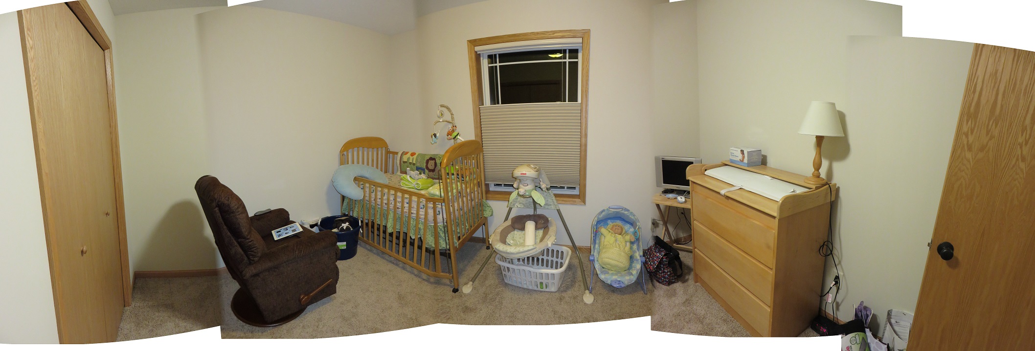

So we finally have been forced to clean out the spare upstairs bedroom. It's been sitting unused so it's where all the stuff we didn't get around to dealing with had been shoved out of sight out of mind. Here's how it looks now. Sorry if this looks wierd as hell, experimenting with taking panoramic photos.
http://mitsustyle.com/forums/attachm...1&d=1391566576

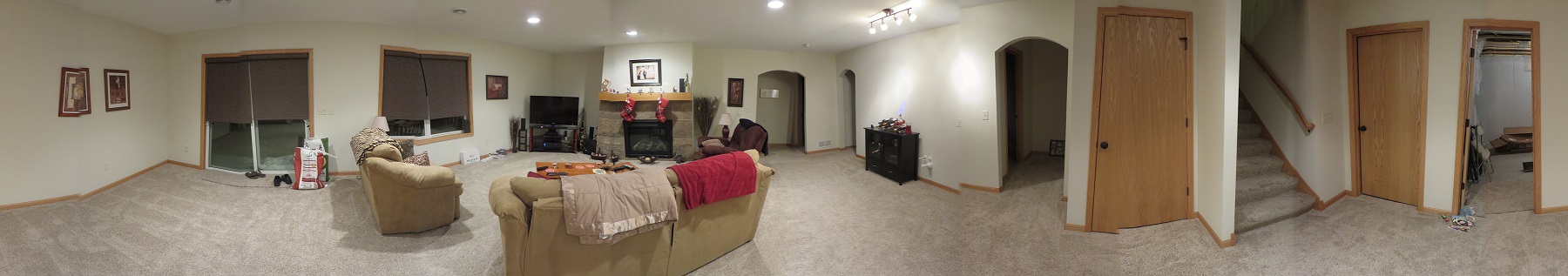

Also went over to a buddies new house and loved his basement setup. So I'm working on trying to plan out the basement theatre setup. Here's a couple pictures of the basement today. Again sorry if they look weird, experimenting with panoramic pics.
360* pic, kinda gotta wrap your brain around this pic because the beginning is on the left and mates the to the end on the right
http://mitsustyle.com/forums/attachm...1&d=1391567229

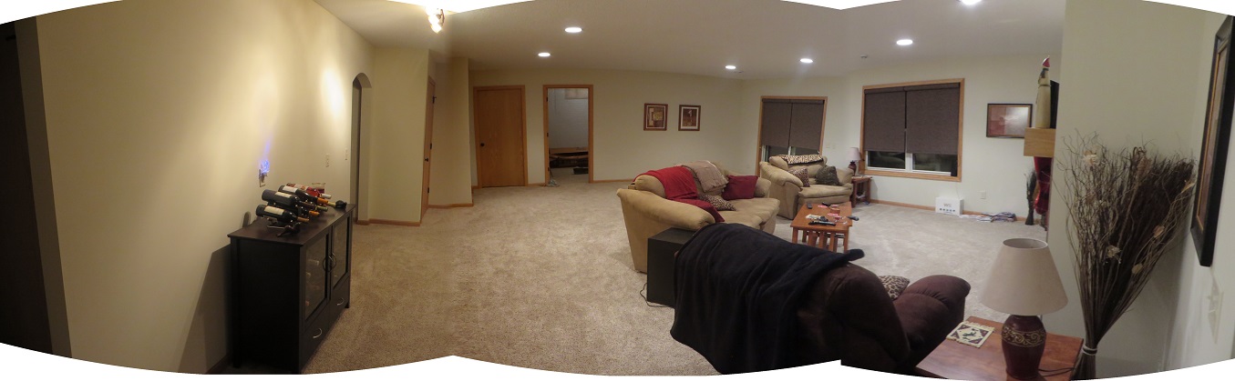

Small panorama view, easier to understand:
http://mitsustyle.com/forums/attachm...1&d=1391567384

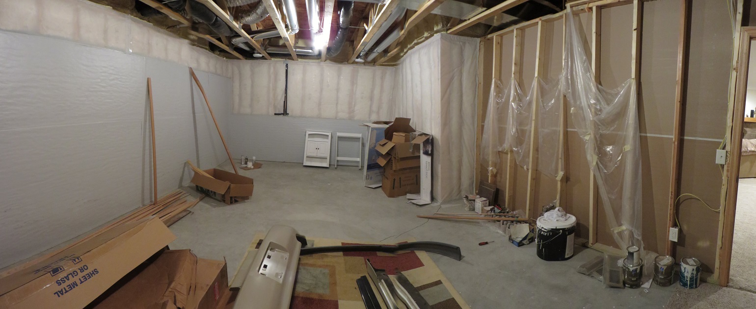

and here's what it looks like in the unfinished theatre room
http://mitsustyle.com/forums/attachm...1&d=1391568083

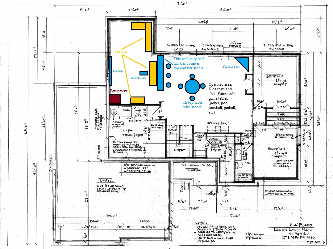

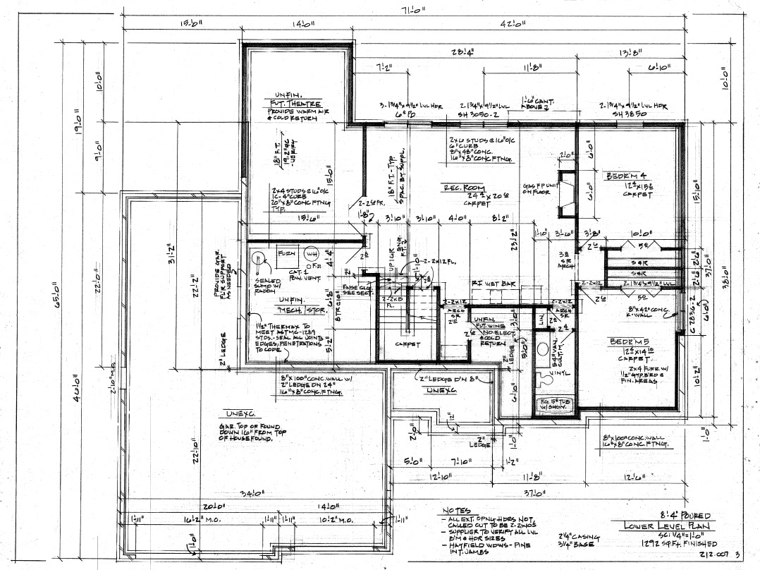

Basically what our thought right now is, that whole wall/door that separates the living area from the theater room is coming down. We originally thought it'd be nice to have that room totally secluded, but we're not the secluded type. We like open and spacious. So that wall will become a half wall with a bar/counter top on top of it, with bar stools along it. No more door, just an opening to walk past the half wall to enter that area. A projector will project on the long wide flat wall so you can see it from anywhere in the basement. The current furniture will move from the area it is now, to the other side of the half wall, that area will become the main TV area. We will still leave the flat screen TV in the corner by the fire place, but that area is going to become just a big open common recreational area, likely filled with kid toys. In the future, probably throw some game tables (Pool, Foosball, Pinball) over there. Also where you see the small little wine cabinet, we will be building a wet bar that goes against that wall.
Pretty much it. If anyone on here is hardcore audio/video gurus, I'd love to hear suggestions on setting up our theater area. Looking for quality on a budget. No interested in spending $1500 on a projector, nor do I want a cheap Pico projector. Just good bang for the buck. We have a 12" JBL powered sub, and probably will use her Samsung receiver/speaker setup along with her Samsung Bluray player in there. But completely open to hear if anyone has suggestions. Would like to reuse what we already have as much as possible like the receiver and bluray player. My buddies place I went to, he had a project similar to this and it looked pretty good, even when he had the blinds open: http://www.bestbuy.com/site/wxga-dig...4#tab=overview
Here's a shitty little sketch I made trying to depict what I'm saying.
Now:
http://mitsustyle.com/forums/attachm...1&d=1391570211
After:
http://mitsustyle.com/forums/attachm...1&d=1391571126

I have been doing a lot of research on theater setups lately and have mine pretty much nailed down. We have the same counter/bar stool setup going in behind the main viewing area. That works great!
Check out the BenQ 1070W projector, one of the best entry level projectors with a good amount of light which you will need since it is more open. Fixed projector screen? I have mine about 75% wired up right now. I just got done figuring out the 7.1 side surround speakers.

Jet, I'm going to do a fixed screen. Either an actual screen or just paint a rectangle on the wall as the screen. Still have a lot of figuring out to do there. Mostly I'm trying to figure out what components to get, what wires to run, because I can start doing that now. I figure I'll install some PVC piping from the equipment rack area to the projector, run a couple HDMI cables and a USB cables in there for now as well as a fish line for pulling more later. Then speaker wires from the equipment rack to speaker locations (probably just do a 5.1 setup).

Fixed screen is the cheapest. I would imagine you are going between 100 - 120"? Check out avsforum.com, by far the leading resource on this stuff. Projectorcentral.com has some great reviews too. Monoprice has some nice in-wall speakers for a good price AVS has a nice DIY section for screens too. Fixed are easy to make and cheap. I am doing a tab tensioned retractable screen.
Old 02-05-2014   #688
Re: House Projects
Ill be doing a pull down screen this year with basic HD projector (TBD). If I were you id just put a retractable screen in the main downstairs family room above the fire place, and just make that your theater room and keep the other room as storage/work shop.
For wiring, youll need to run whatever your system will support. At min id run Cat 6 cables, good speaker wire to all locations, HDMI cables, and rca cables if you need them run to a cabinet thats going to house your stuff.

Yep, and make room for a HTPC if you decide to go that route later. If you have a server with your movies on a really nice little box to handle that is the Dune TV102. Works slick and streams full bluray.
