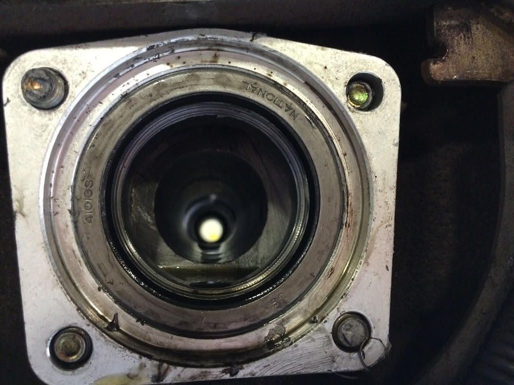

Took out the 4:88 and swapped in some 4:10 gears on the posi unit.
Noticed something in the axle tube I have never seen before. Both axle tubes have a pressed in steel insert that starts right after the c-clip eliminator and goes into the center section just short of the carrier bearings. I guess they were installed to strengthen the axle tubes? You can see the machined/cut end of the insert inside of the axle tube in this picture.

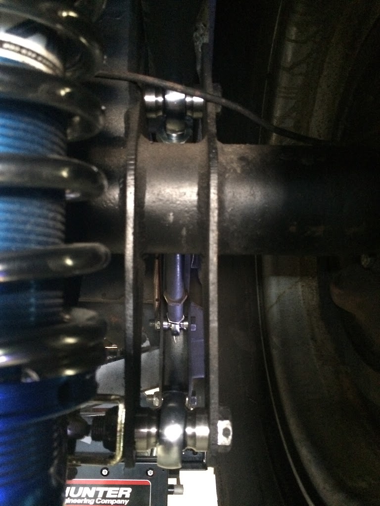

I wasn't ready to jump in and redo the front suspension yet (was about to a order customer drive shaft). but I had an upper control arm bushing come out while at Cruising' the Coast. But since it had to come apart, why spend $$$ on repairing the old when the change over was going to happen anyway?
So after a month long back order wait, I finally got Global West's Drag Series upper/lower control arms (TLC-42 & TLC-42H). I also installed AFCO's A-body double adjustable coil over conversion kit (3840F/BNC shocks & GM450 springs). A note about the lower control arms is that there is no sway bar provision. Not a problem for me as UBER and high speed cornering didn't mingle well anyway, I always cornered at low speeds. So off came the sway bar as well. Every thing came together and worked well with the drop spindles I already had on it.
The upper arms added more caster to the alignment for better straight line stability and reduced bump steer.
Also, in doing this I took 28 pounds off the front end. Not a huge amount, but I'll take what I can get.

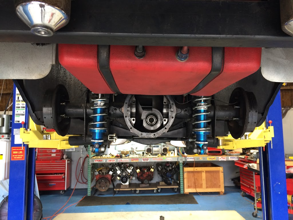

It's not as light out back as it would look, 1680lbs on the rear axle and 2170lbs out front with me in it. That's a 44/56 split which is really good for a tank. Its a little known secret that El Caminos have a better weight ratio than the Chevelle body because of the additional length/weight of the body after the rear axle. Station wagons do too, but that's another story, LoL. For a 4-link rear end to work well a minimum 45/55 split is recommended by chassis tuners.
