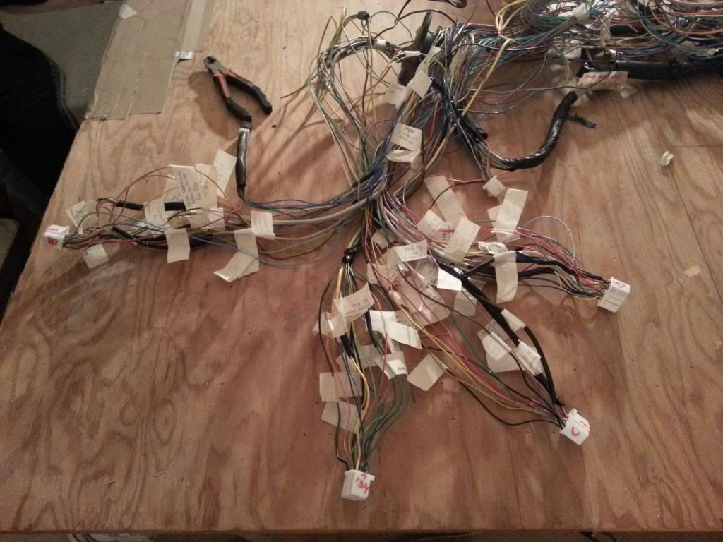

I know the wiring is getting boring, but I'd like to have this thread for reference too.
I'm ready to tear the interior of the Legacy out and get this this wired in. I'm still waiting for a few gauges including my wideband, Tactrix OpenPort 2.0 and boost control solenoid. I will also need to fab up an intake at some point.
I think getting everything soldered and shrink-tubed will take me a solid night. Then I'll test fit it, loom it up all nice and get her prepped for a tune!
It's so close I can taste it.
WRX harness labeled out.

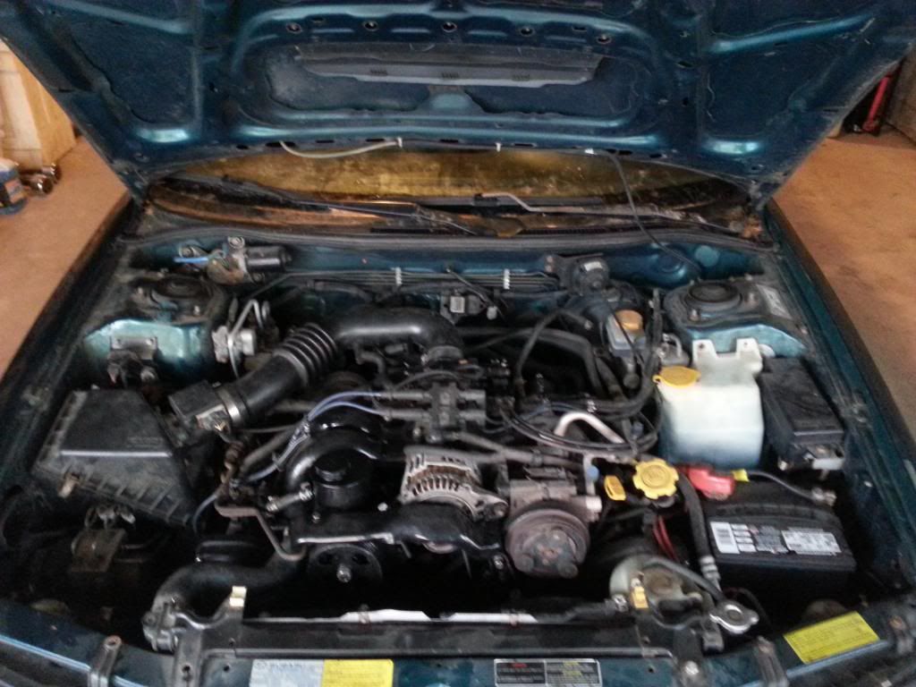

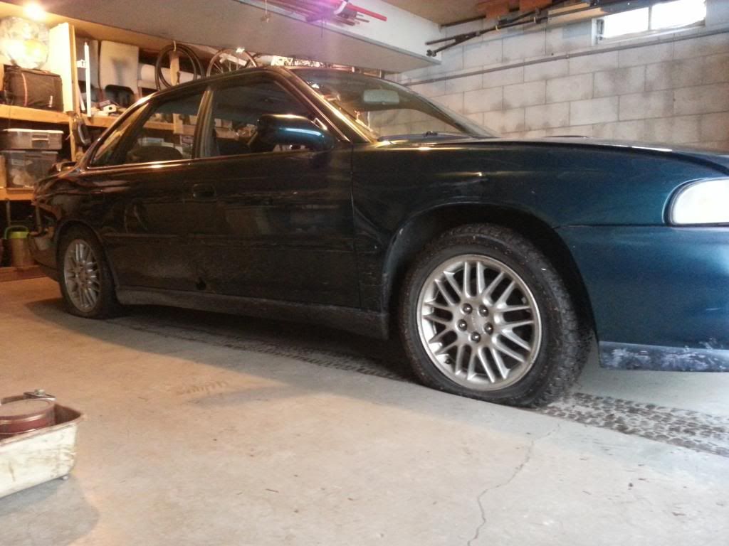

Well I finally cleaned the garage out and got the slowbaru in.
I'll be starting later tonight and should have some good progress pictures up later.
Last shots before surgery!

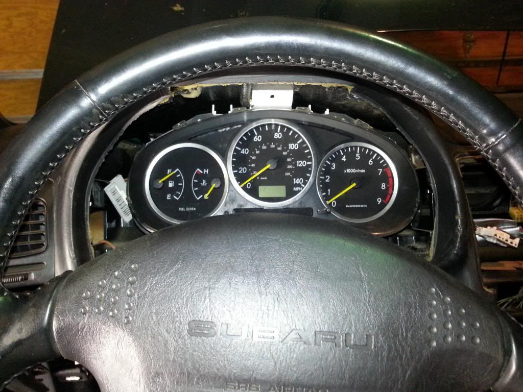

Here are some pictures of the progress I made in the garage tonight.
I roughly test fitted the WRX gauge cluster before I took the dash panel out.

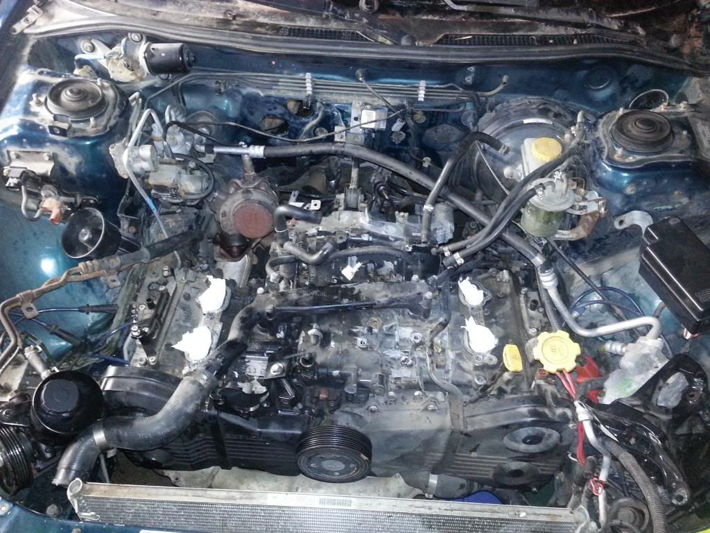

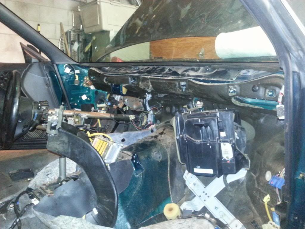

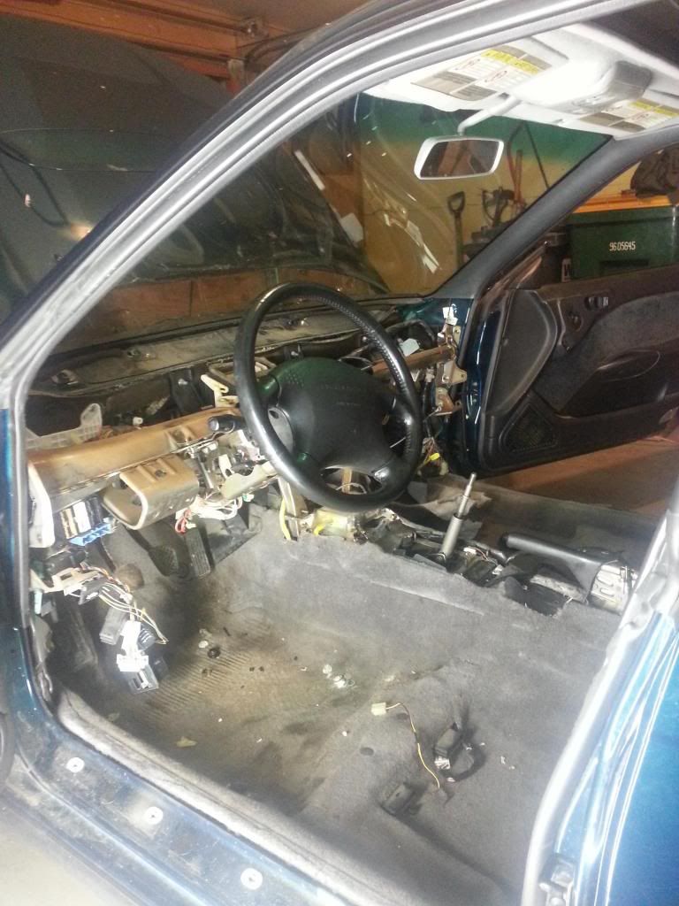

I found some mold inside the HVAC system. I did manage to clean some of it out, but I figure if it's in the blower motor and in the heater core housing it'll be in all the ducting. This must be why the air always smelled extra musty haha. So out with it all! This will free up space behind the dash I can use, and I can get rid of all the wiring and plugs related to HVAC operation making installation that much easier.
Made a little more progress tonight. Got the rest of the bulkhead harness out, and the engine ready to pull.
Before removing the harness and dash beam
After
I had some help today too.
Engine is ready to come out. I just have to borrow a hoist and stand.
