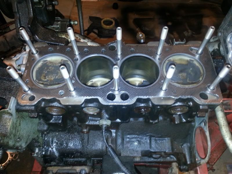

cleaned up the engine bay some today. Deleted all the evap garbage, and got the engine on its stand. One downer I am not sure what is wrong with the #4 cylinder. 1, 2, and 3 where all dry but in the #4 seemed to have some wet oil in it. Not sure if it is head gasket leaking oil into the cylinder, rings, or valve seals.

Finished installing my new Brian Crower valve springs, new valve seals, and Brian Crower 272 cams.
Got my $8 ebay shift cable bushings installed.
Also cleaned all the head gasket mating surfaces, and installed my H11 head studs.
The only thing I have a question about is this stuff what I want to use when torquing down the head nuts on the studs.

No don't use that stuff. I grabbed a tub of that and Shawn (4seasons69). Said it wasn't the same stuff that you need.

You can get by with engine oil if you need to but I would use the arp moly lube. I might still have some. I'll check and see
