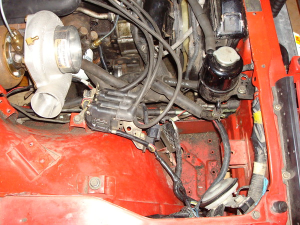

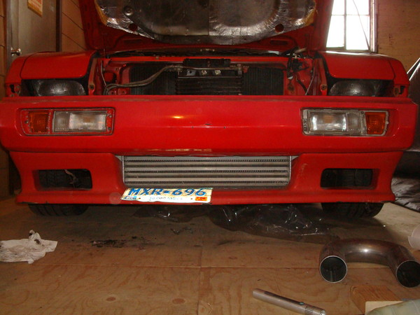

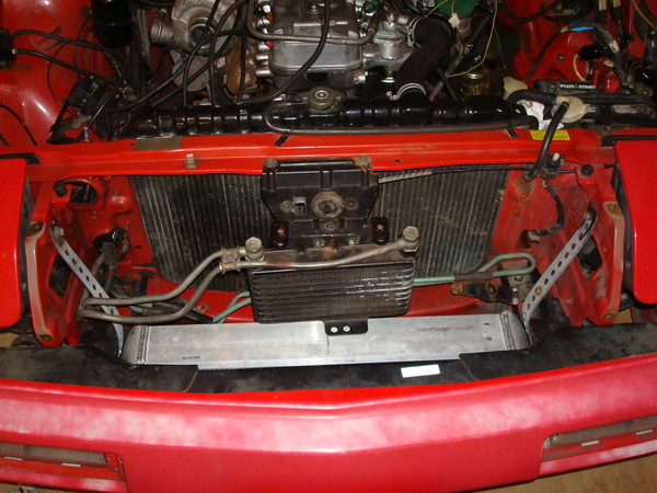

More progress today. I am really happy to be at this point, it was the biggest step other than tuning and boost tubes. All the other stuff is nitpicky and small.
Here is my solution for the difficult mounting position:
I think it looks great, but just to fill that opening, you need to cut a lot of metal. I think I'll get 'er reinforced later.
Next up: fixing the couple coolant leaks, save up for exhaust manifold while cleaning up wiring, refitting the interior, reattatching exterior parts like the airdam, etc., etc. It goes on and on. Cant wait to be done!

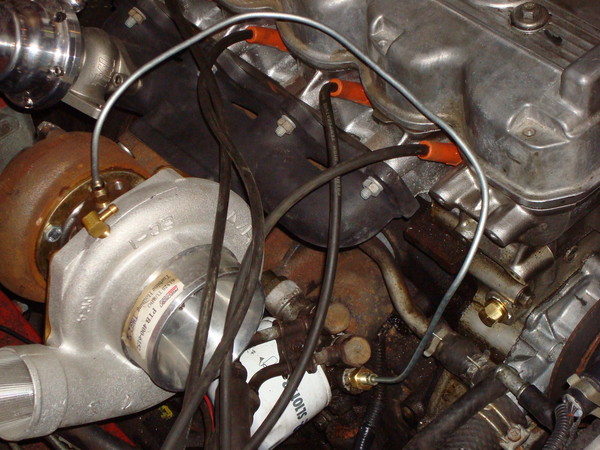

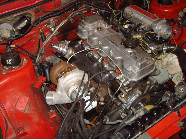

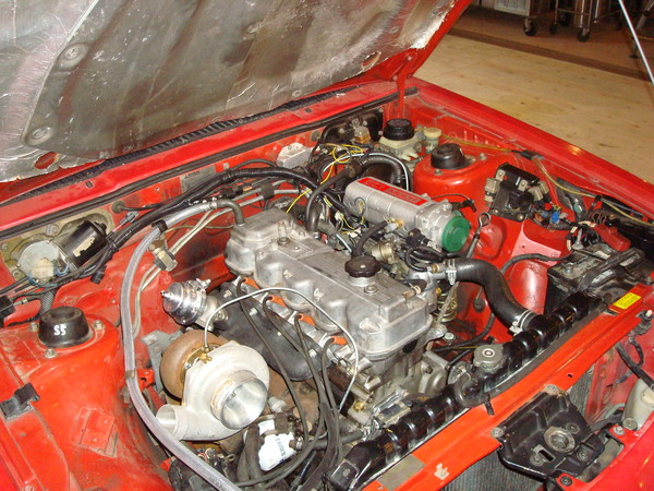

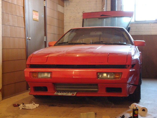

Well, since I posted last, a lot has happened, I got my big turbo on, all leaks are fixed, I need a return oil line for the turbo, but need to tap/weld a bung on to the pan for that. So I have to wait a while, but at least I got the feed line worked out, much easier than I though it would be. Thanks mitsu for using pipe threads in all the right places!
Here it was a couple weeks ago:
Here's the stock guy with the 61.
And with the new turbo, manifold and tial 38 mounted. I have to get a new downpipe made up, but that will get done at the same time as the I/C pipes.

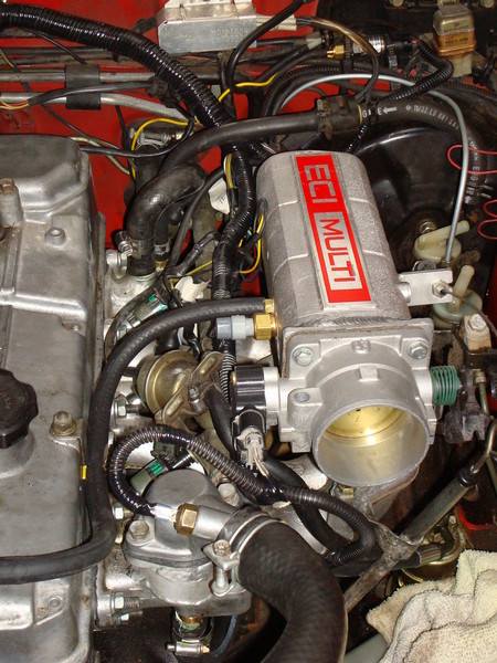

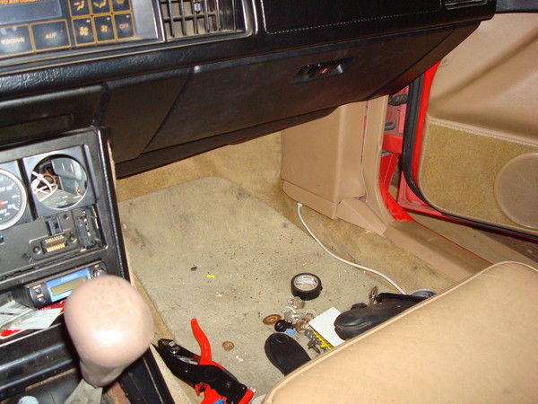

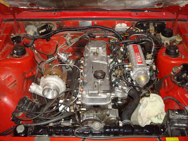

And a couple more:
Cleaned up the area here, removed the charcoal canister, remounted the PS reservoir, figured out some wires etc.
And this is good for me: finally got all sensors and wires for them lined up and mostly ready. I will be redoing all injector clips and wires in a while. I'll shorten up the excess and wrap it all in loom tubing.

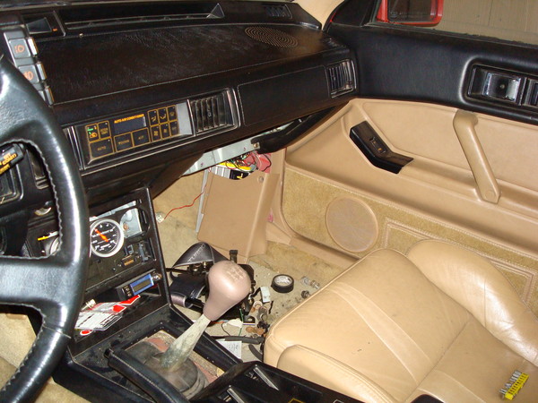

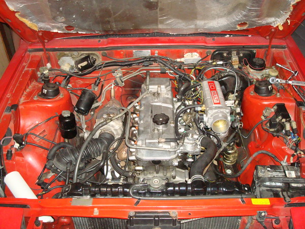

It's fairly close. I am going to tidy up the wiring inside. I have to find the stock tach wire and connect the dsm wire to that. then one more on the inside, then I can mount the ecu and get the interior all cleaned up. That will be nice. That aem is huge compared to the stock ecu, so it's going to be hard to do it right.
Lets see, then it's I/C pipes, downpipe, and the oil drain tube for the turbo. For that I have to mod the oilpan, which is hard to do when it's in storage, so I'll have to get that done by the same guy doing my piping.
