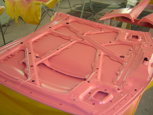

Old 07-28-2005   #21
Re: painting my 92 talon at school (dunwoody)
july-28

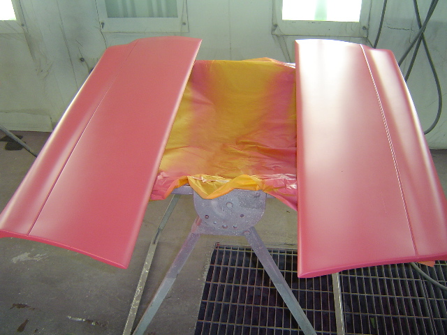

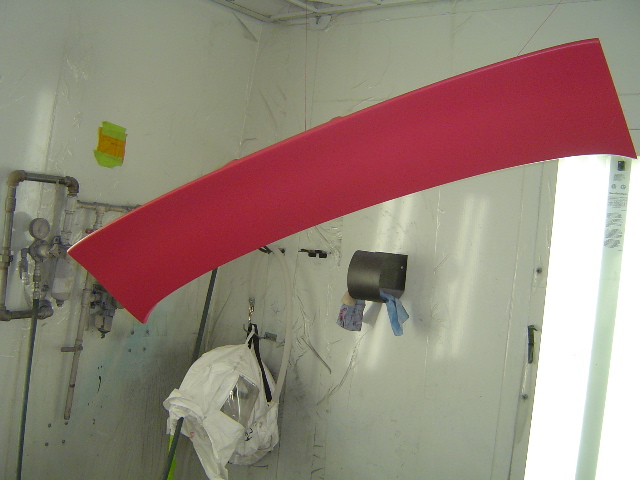

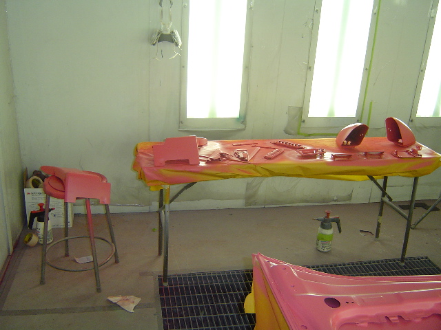

sealed and painted alot today
under side of hood,side skirts,door caps,fender caps,mirrors,door handles,wing,side vents
and yes the sealer is pink

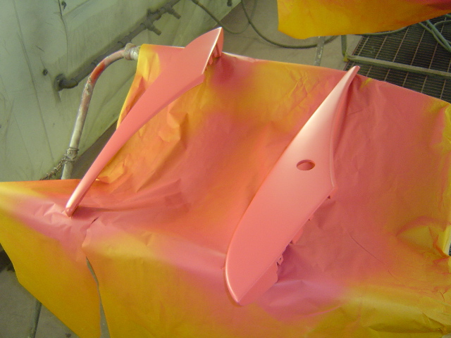

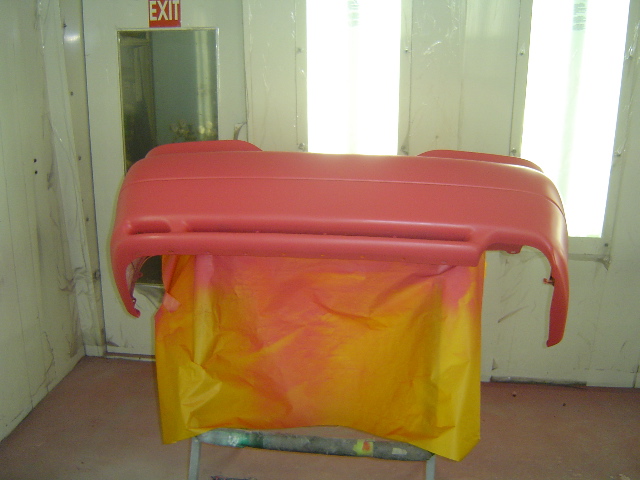

Old 07-28-2005   #22
july-28
more pink

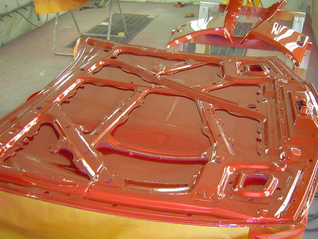

Old 07-28-2005   #23
july-28
more pink
base,and clear

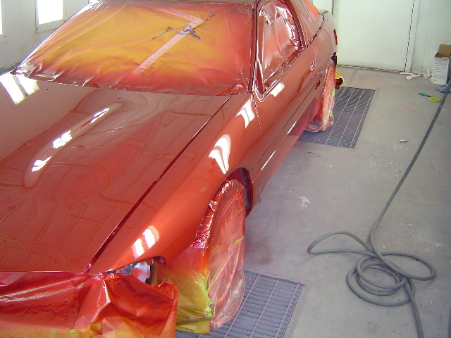

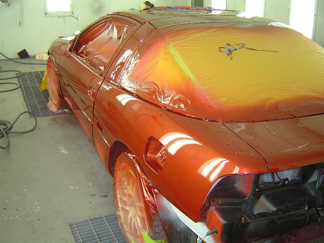

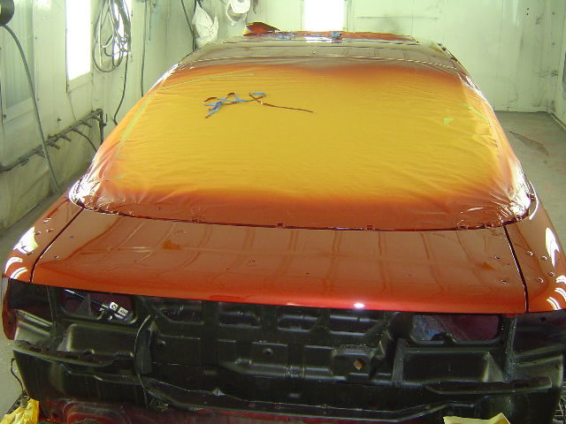

Old 07-28-2005   #24
july-28
base and clear

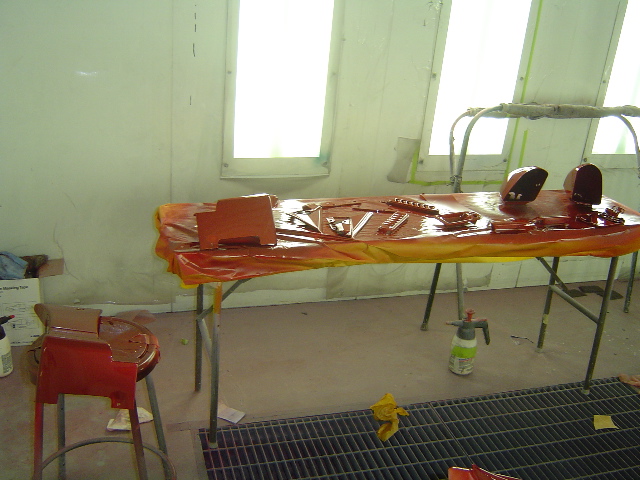

Old 07-28-2005   #25
july-28
base and clear
pt2

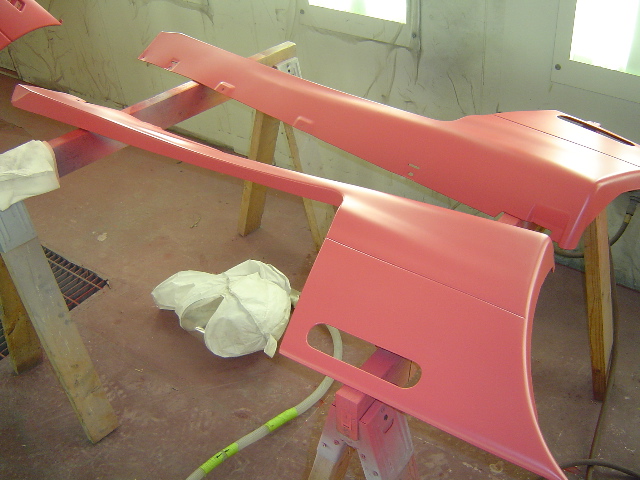

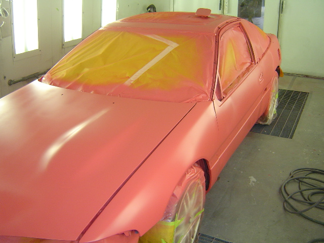

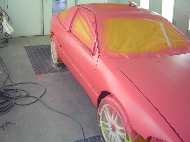

Old 07-29-2005   #27
july-29

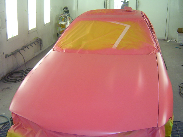

today was it all but the front bumper is done
here is the pike sealer on the car

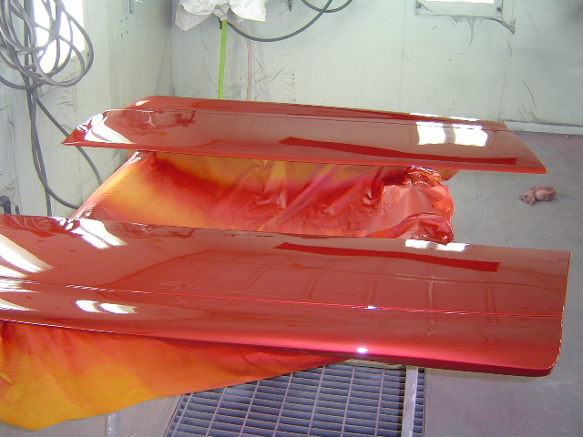

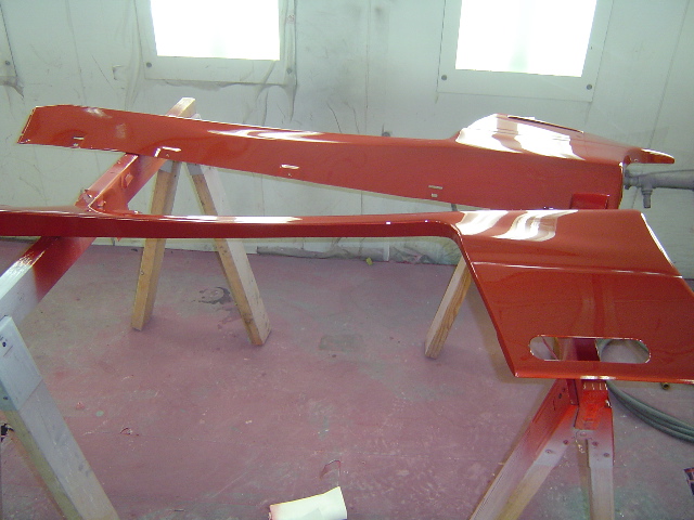

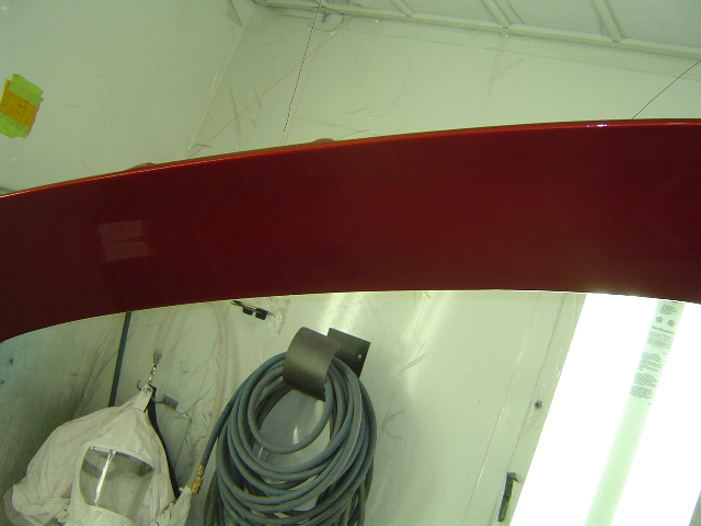

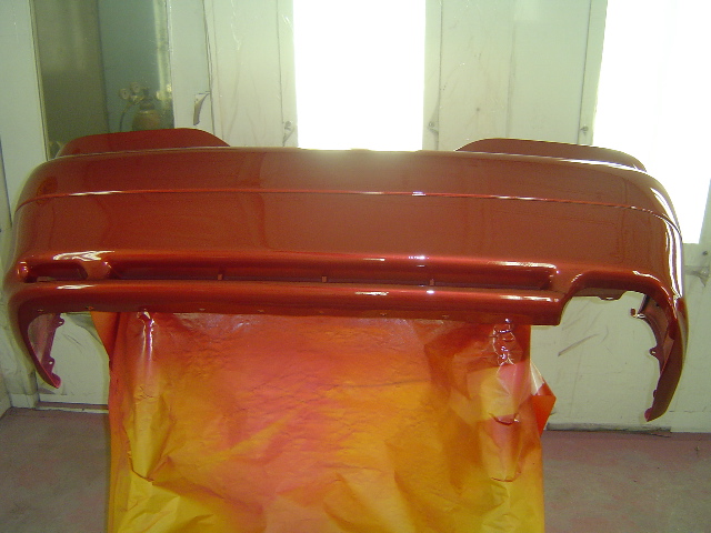

Old 07-29-2005   #29

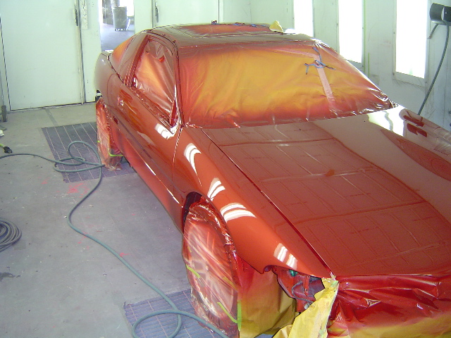

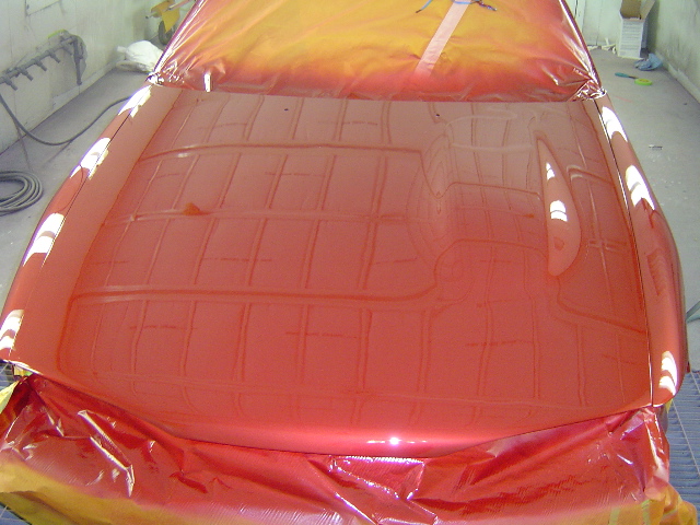

july-29
finaly painted

do you have to bake the paint? or can it cure on its own? never understood the process of painting complete. or i should say never researched full step by step painting process...
But either way the car is going to look sweet!
Old 07-30-2005   #35
slowbubblecar
Big Turbo Monster
slowbubblecar's Avatar
Location: Hopkins
Drives: GTS and E55
Posts: 1,105
you can get by just fine with just spraying it and letting it cure on its own.
7/25/09
Old 07-30-2005   #36
Let it sit in the sun for a while and the UV's will bake it. When it gets baked in an "oven" it isn't actually heat that bakes the paint, it is UV lights.
Old 07-30-2005   #37
I am just letting it sit no heat
I could have baked it at 140f to get it to kick but paint will take up to 6months to fully cure
come monday it will be wet sanded then dry sanded and buff the hell out of it
