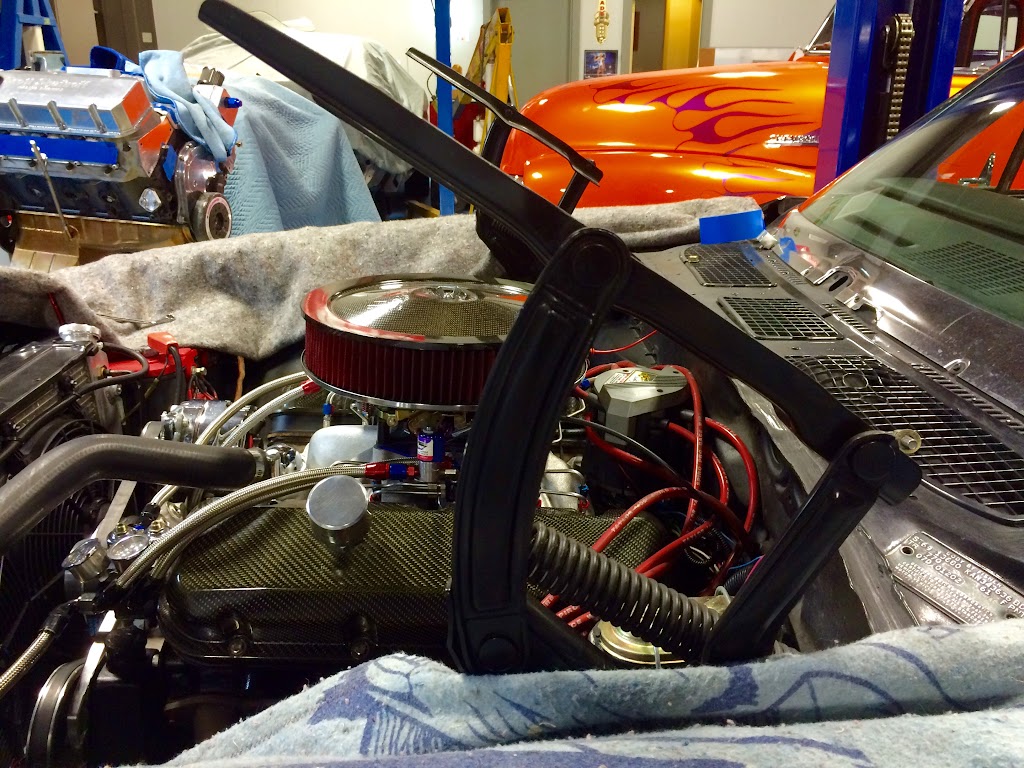

I forgot to post pics of the installed radiator and cooling fans. Fits well and looks great.
Installed a new Stewart Stage II cooling pump this weekend.
Very well made and not that expensive as compared to others (Edelbrock ).
Took a quick look inside and found a nice cast impeller instead of stamped steel.

The radiator and fans fixed the heat soaking which occurred while driving at cruise/higher speeds. I'm seeing roughly 3400-3500rpm at 60-65mph.
Those are the Zirgo Ultra Performance ZFU14S fans. They pull almost 2800cfm each.
The pump was an original GM cast iron unit which is under driven a good bit and didn't pump enough at idle, causing heat creep sitting in traffic.
So the rad/fans fixed the cruise temps issue and the pump fixed the extended idle issue while shaving a few pounds off the front of the car.
