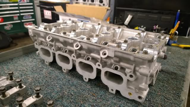

Pictures and shat.
This is how I start with the heads. I don't really touch anything until it is this clean.
I didn't take many pictures of this because I was focused on getting the job done rather than attempting to be a photographer. lol Cleaning up flashing; this first example was of the worst I hadn't already touched.
Different location; note the not yet finished oil return.
Oil port mod.
The customer wanted the intake side gasket matched, polished and the intake divider knife edged. The polish in this photo was before roughing it back up.
Flashing cleaned up in the exhaust runners. This was before a mild polish.
This first picture is a different valve job I preformed on a head of my own. The second is of the above pictured customers head.
*Note seating mark/line; exhaust side.*
Thanks for looking!
Chayce

Re: Heads - Who needs 'em?!
Wow that is some nice work. I have noticed the nasty casting on the oil return on all my heads.
Thought I'd update this some.
I do not have any pictures of the bottom after the resurface but I could easily take a few if anyone is curious.
Thanks!

For anyone looking at the turnaround time of Jeremy's head; I had well into 12 hours of porting, polishing and cleaning the flashing up. Plus running into a few kinks with valves needing to be replaced, waiting on parts as well as taps.
Next up; a set of 6g72 heads!
