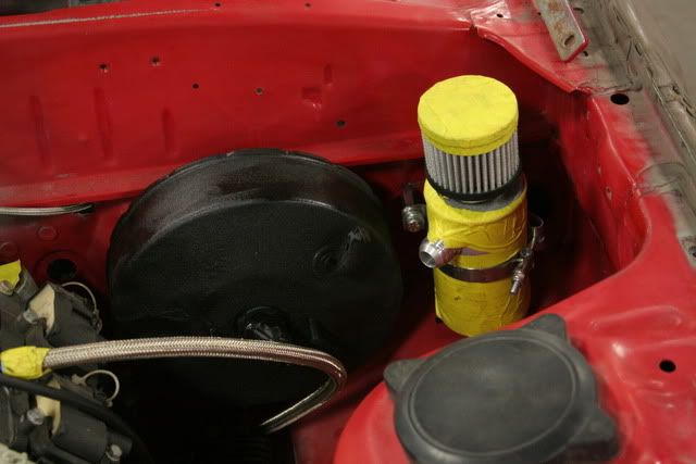

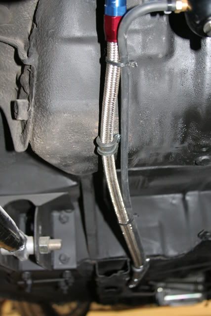

Today I finished securing the fuel and vacuum lines from the regulator to the bay:
Catch can mounted to the firewall:
And it will drain to the ground when needed:

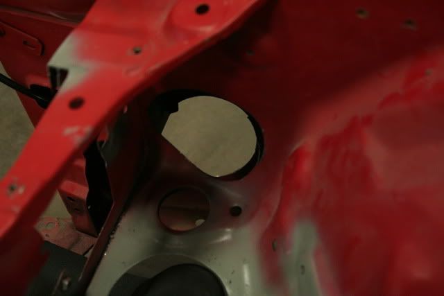

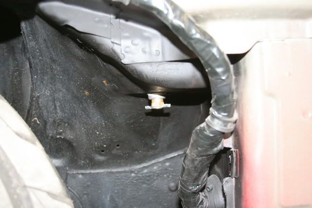

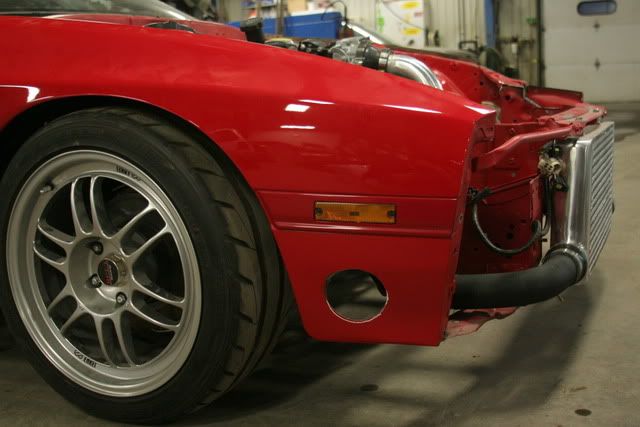

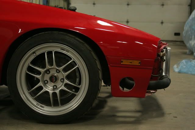

So I decided that dumping my exhaust by the tranny would be rather loud and make the cabin hot... so I came up with this
My friend Nate and I are going to build the downpipe out of 16ga aluminum tubing. Another advantage to this is the ability to hide the 02 sensor within the fender and run the electrical under the car.

Aluminum downpipe is not such a good idea. Ever seen the exhaust gas temps on a turbo car?
I know/know of a few people who run aluminum downpipes with no ill affect...
One of the new developments is a lot more people running aluminum downpipes these days!
I hope to do the same thing but I might use 1-2 ft of steel for the downpipe section then switch to aluminum.
Looks good, its not that loud out the side but louder than I'd want for a street car.

Loving it except for the dump in front of the front tire. Full blown race car?
Full blown street car and daily driver
I have an extremely high tolerance for loud cars. Truth be told it will not be that loud at all.
