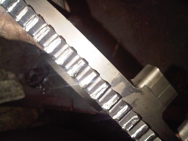

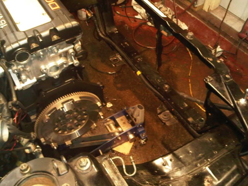

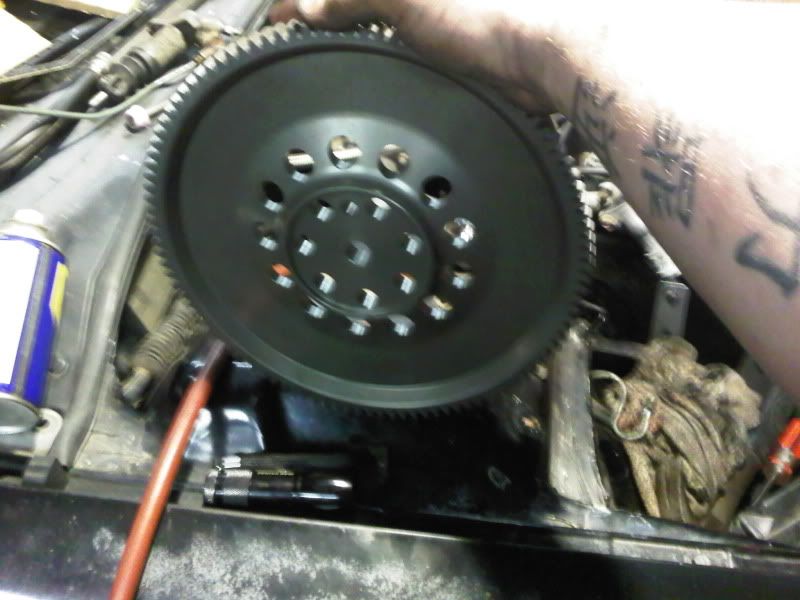

After what happened with my fidanza flywheel, starter ring coming loose and the friction surface screws coming out, I wasn't about to buy another aluminum flywheel.
So I ordered up a chromoly lightweight one which should be here on friday.

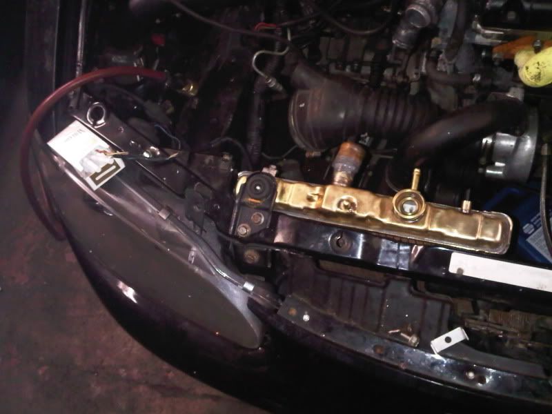

Used radiator and fans

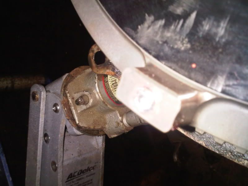

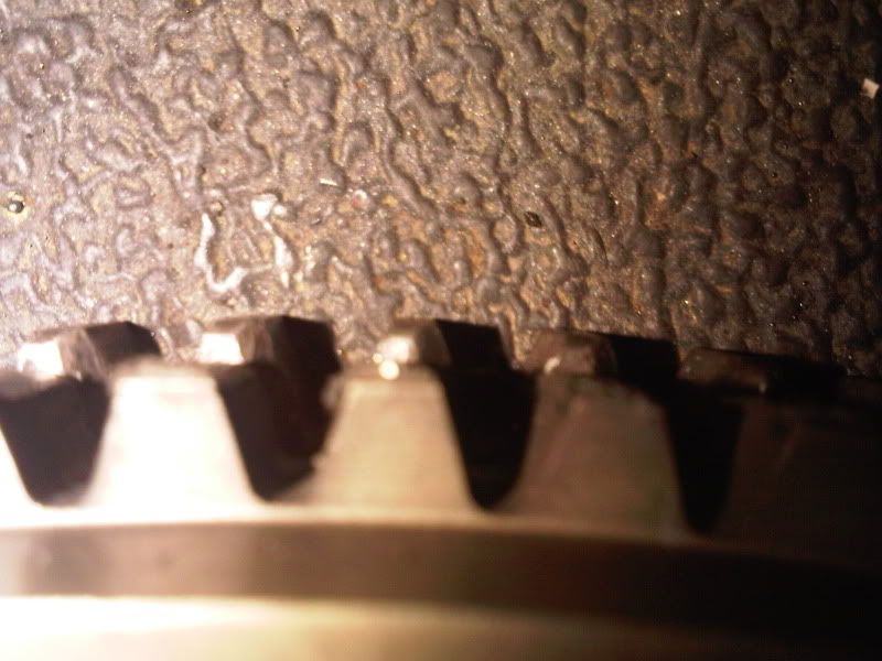

Also got some bad news for some reason one of the ears broke off my starter and it scared the starter ring gear on the flywheel pretty good, I put a new starter in but it still sounds pretty rough.

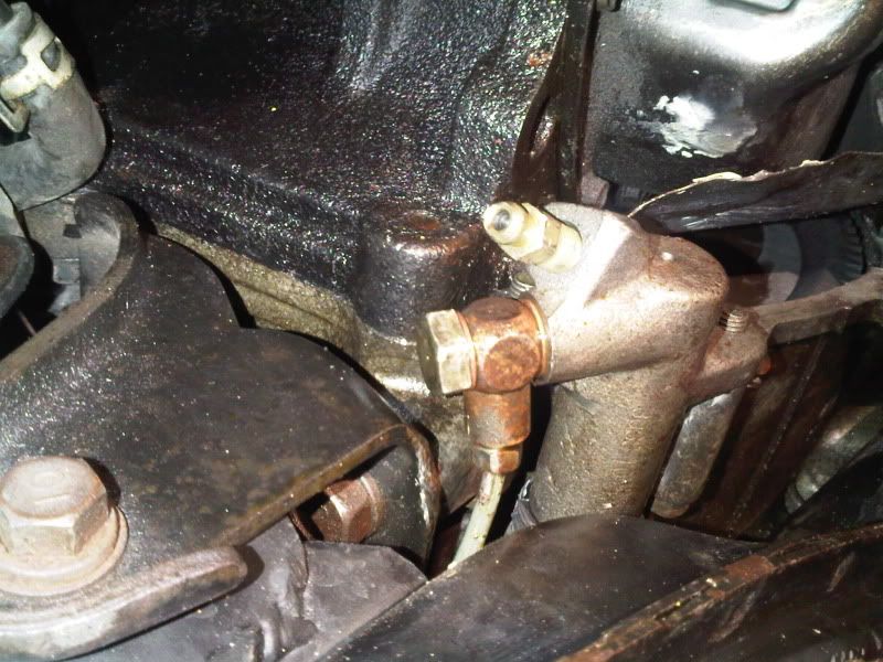

On top of that its also got some clutch disengagement issues. I put a brand new slave in with the clutch and even shimmed the pivot ball while it was apart. I also extended the slave rod too about a 1/4 inch(with it extended the slave is damn close to being bottomed out). It got gravity bled last night for about 45 minutes of me watching it and was coming out steady and clean, still have to pump the shit out of it to get it to disengauge all the way, then a buddy and I bled it again today and I noticed that the clutch fork has about an an inch travel the first time the pedals depressed.
Any ideas on this issue? I know that the clutch master was replaced about 10,000 miles ago. When I first got the car it took a few pumps to get it to disengage but after a while of driving it seemed to work alright. If it makes any difference after it gets driven down the highway in the cold it seems to work just fine after the first push, but I assume thats just because the fluid gets thick right?

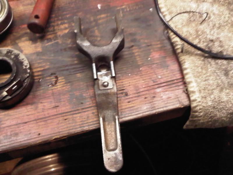

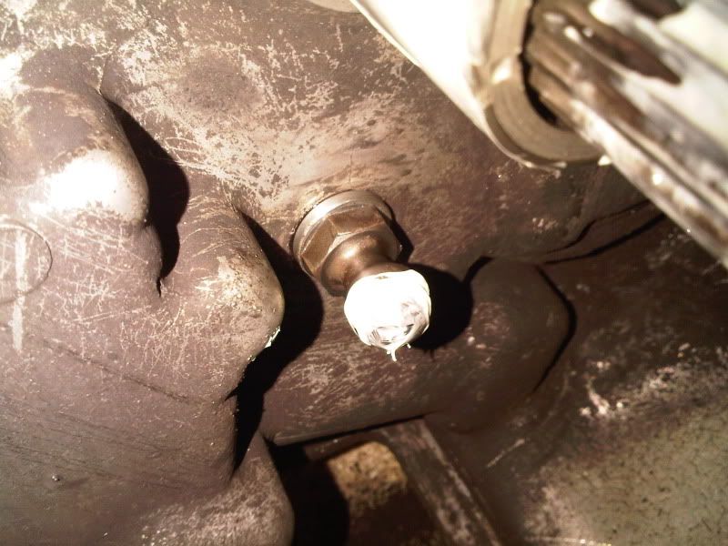

Well Last Friday I began prepping the trans to go back to its home. Shimmed the pivot ball with 1x thicker washer, greased the splines and the seals for the axles so they wouldn't rip on install.
Cleaned up the clutch fork and lubed the pivot points
And then put the fork and TOB in.

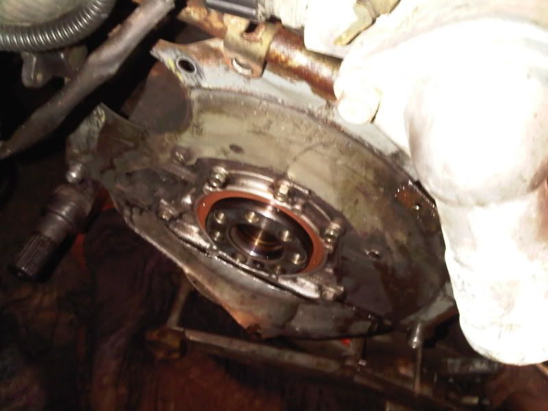

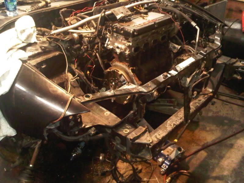

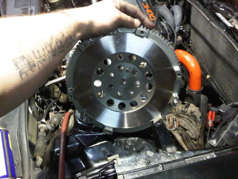

Then my attention got turned to the engine, installed the new rear main. Decided to only do the seal and not remove the whole housing it was really easy because,I found out why the old one was leaking it was pushed out of the block quite a ways.

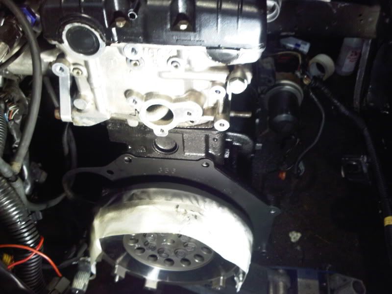

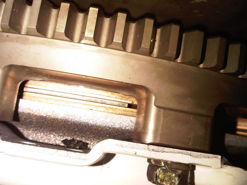

checkin out my new 11.5lb chrome moly flywheel

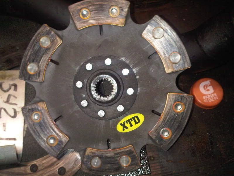

installed the new xtd stage 4 clutch and pressure plate
then there was a big mistake on my part, the bolts were too long and when I was torquing the pressure plate it would set off my torque wrench before the pressure plate was flat against the flywheel.
that should have thrown a red flag but I got to the 2nd one and it snapped off in there.
Drilled it out and was able to get it with an easy out.... talk about a very nerve racking time, the holes are really close to the edge of the boss there tapped into.

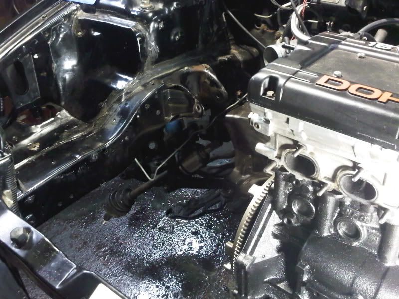

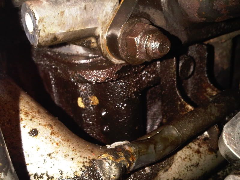

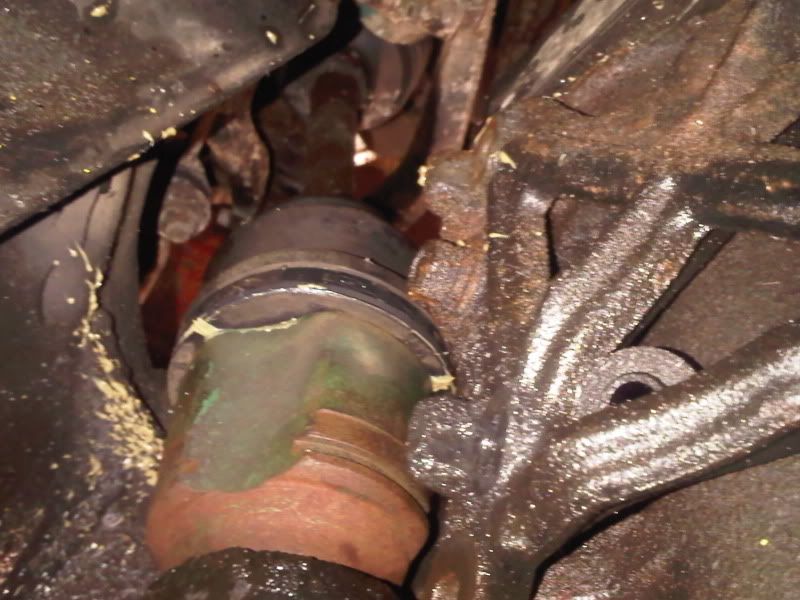

after i did that you would think it would be ready to go, but then I slid the trans under and was about to pick it up to slide the jack under it from the top and caught sight of this.....

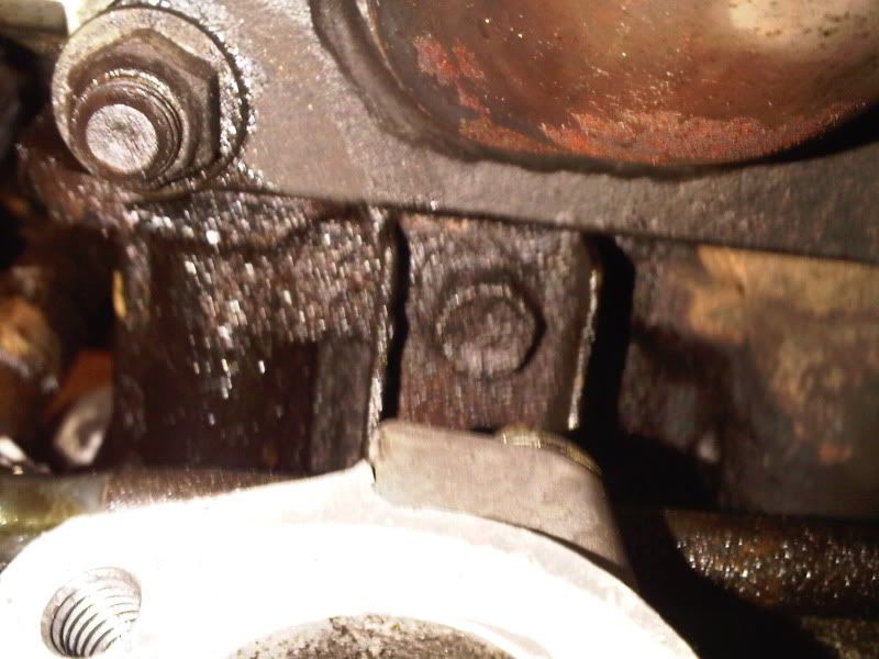

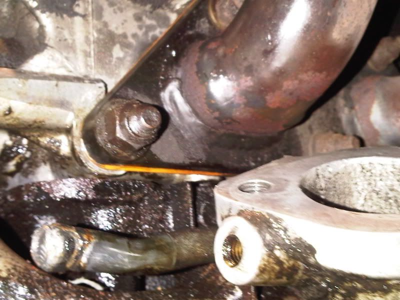

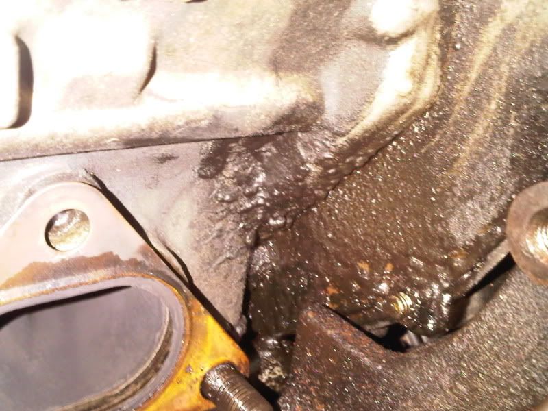

An oily,gritty,nasty ooze all over the side of the block and head.
It appeared to be coming from the headgasket at first, but it was coming out of the intake cam seal on the end of the head.

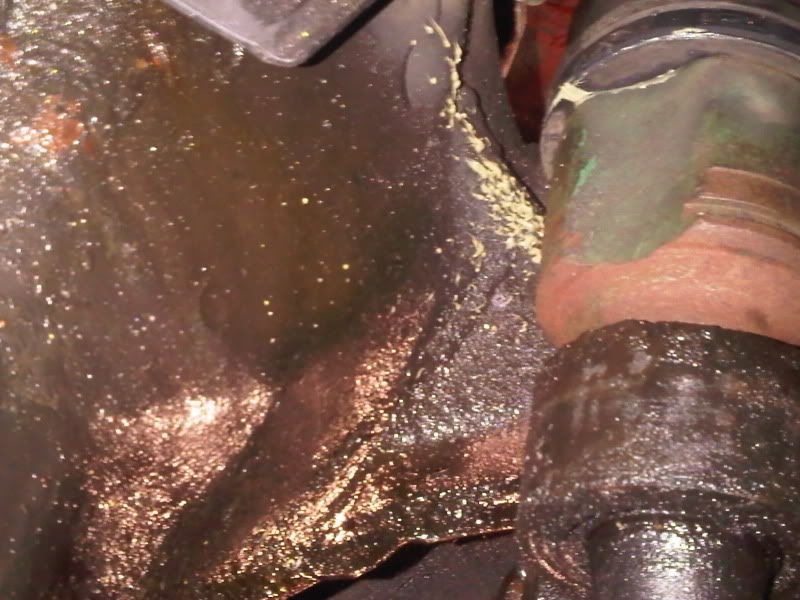

Nope it didn't stop there. I looked around the front of the block and it turns out the oil,grease, and grime were much more plentiful than what I had noticed previously.
Figured I should take the header,turbo and O2 housing off to get a better look.
Alot of the oil on the front of the engine towards the timing belt side is because, the car has a universal cut to length dip stick on it and the dipstick only had felt to seal it to the tube,you can about imagine how good that worked once the heat from the header got to it.....

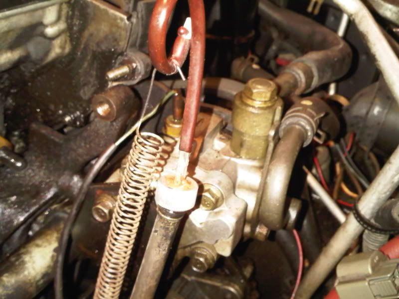

So I put some silicone where the sealing cap had the loop for the dipstick coming through it, glued an o-ring to the bottom of the sealing cap and put a pretty thick piece of hose in the top of the dipstick tube. All of that seemed to do pretty good but the dipstick would blow up some and oil would still come out of it so I put a small hose clamp lower down on the dipstick and hooked a carb spring running from that to the top of the dipstick. It looks crude but it works damn well, and the heat from the header didn't effect the springs tension at all suprisingly.
I have no doubt in my mind that a factory dipstick would have no problem staying in the tube on this car a failing PCV valve went unnoticed for sometime. Fortunately just took some time and it saved me $17 over a new OEM dipstick.This dipstick retention setup has been on the car for probably the last 4000 miles and Its easy to check the oil, doesnt get in the way of anything really, makes a great conversation piece and cost like 3 bucks haha.

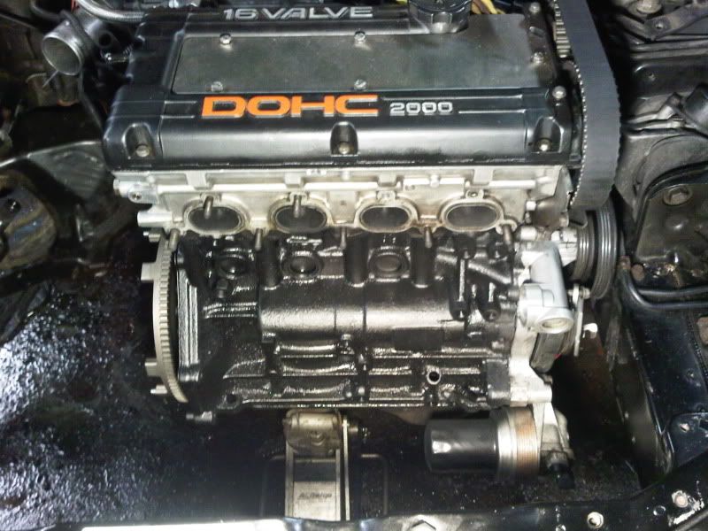

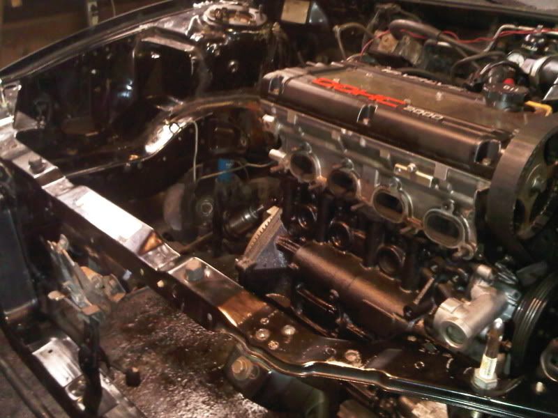

Heres before the cleaning started, the ac and ps were already removed and the engine is being degreased.
And all cleaned up,take a look at the floor in this pic and you can get an idea of the amount of oil that was on the engine. I didn't use any water to clean it, just Gunk Engine Brite a scrub brush and then rinsed it with some windex.(on the hardcore spots I used Brake/Carb cleaner).
Well being that the motor and engine bay were nice and clean now, I couldn't hang the super oily/grease caked turbo off of it, so I cleaned it as well inside and out it was definitely well lubricated haha.

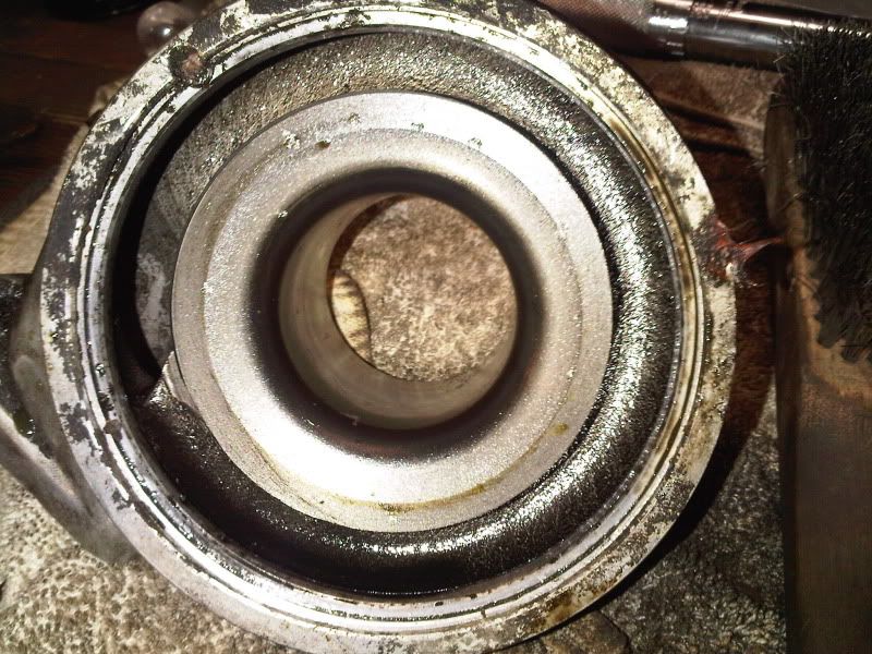

I learned that it has a polished compressor housing which i did not know till now lol as well as a ported inlet on the exhaust housing.

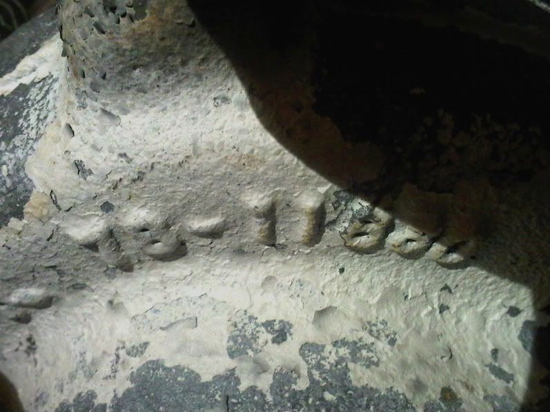

Wiped it a little bit looking for some numbers on it, but only found a couple on the exhaust housing and when I googled them Everything said Big 16g, But Supposedly its a Evo 3 16g? If it is or isn't and someone would let me know that'd be greatly appreciated.
Bad PCV valve with stock crankcase evacuation= a nasty mess my intercooler looked the same way within 1500 miles of being cleaned.
I forgot to take finished pics, but its nothin special just not all oily inside and out. Ill get a closeup of it when I take the finished pics tomorrow hopefully.

-Starter now grinds on flywheel due to the ear breaking off of the other one, flywheel teeth look slightly worn from the old starter barely gripping when it was coming off. Flywheel has like 15 starts on it
-Clutch doesn't wanna disengage unless pedal is pumped???
~Brand new slave cylinder
~10000miles on the master cylinder
~FCU/Accumulator removed from slave line
~Clutch Pivot ball is shimmed
~Clutch fork had very little war to the pivot points
~Slave was gravity bled, then Pumped to bleed, then It was bled opening the valve while the pedal was being pushed down same result after all 3 bleeding attempts.

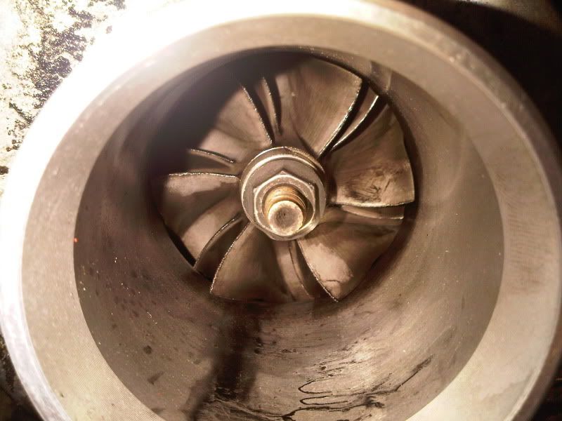

Do you have the number that you used to search what turbo it is? Can't really see it in the pic. Also, I vote that you go with an external wg off the o2 housing. I ran setup on my dsm with the 3076, and the evo3 16g and it held a perfect 20 psi all the way to 7500rpm. No creep, no taper.
Old 01-22-2011   #25
Re: 95 Tsi Awd PPPPPProject
On the compressor cover, there are some numbers as part of the casting. Near the end, there are some stamped numbers, which help signify which turbo this is.
49178-01(40)0: 14B
49178-01(41)0: Big 16G
49178-01(42)0: Big 16G
49178-01(45)0: Evo I Big 16G
49178-01(46)0: Evo II Big 16G
49178-01(47)0: EVO III 16G
49178-01(52)0: Small 16G
However, the one you posted looks polished or something? It is definitely a 'g' wheel so its either a small, big, or evo3 16g but if its actually made by MHI or a knock-off, who knows. They usually look more like this:

ya whoever polished it did a pretty good job of taking every casting mark/ number off the compressor housing lol.
The only numbers I was able to match were on the turbine housing they were 01 and then 47 I'll take a closer peak today n get some more pics of it for ya guys.
Ya I think the external setups coming Maybe instead of upgrading my o2 housing ill just take it as an opportunity to discard this Pacesetter header, everyone says they crack to hell this one hasn't, but it is made out of pretty thin material melted all the blades off my ac fan when i had it and started to curl the blades on the factory primary fan as well lol.
All I care is that it'll pull to redline at 17lbs like it was before it got taken apart, at least until I get the rest of my supporting mods done.
This 9lbs till 4500 then creeping to 22lbs is getting sort of old especially if I forget its like that and get it up in revs in 3rd I can get some god ol' fuel cut whiplash haha

you can try to adjust the clutch pedal itself.
if it works while pumping it up your leaking pressure somewhere. I'd really check you have no leaks and ALL the air out of the system.
you can spin the rod to lengthen or shorten to where it works. might help a lil bit.

That compressor wheel looks scary. Engine bay looks a lot better though!
What are you tuned with/for? E85 or pump?
I thought guys with creep issues sometimes just turned up the boost on their mbc so the car would get to that boost level, then not go any higher? lol
Ex: car is set to 14psi, creeps to 22, so they set it to 22, then just let it taper? That make any sense?
Maybe try getting a tubular o2 housing or porting it if you don't want to risk porting the cracked turbine housing.

Well the cars down again put in my new starter last thursday and it worked good but still sounded funky.
Well this afternoon it decided that it wanted to engage the flywheel but just grind on it instead of spinning it.
So my 1 week old flywheel is fucked and the trans is coming out tomorrow night.
I ended up getting a used fidanza from a buddy. As much as I really don't wanna run another fidanza theres not really a choice, since I'm out of money and I have a small DSM part tab running with him lol.
Just have to decide if the friction surface is within spec to be used. If it is I'll attempt to do a flywheel swap after work, after researching clutch swaps most people claim to be able to do it all said and done in about 3hrs, Hopefully if nothing breaks or anything else is found wrong, It'll be back on the road tomorrow night.
Ya The clutch disengagement issue definitely needs to be solved. I think some air is stuck in the slave itself somehow and its not coming out when the clutch is bled, The clutch wouldn't disengage at all tonight on the way home no matter if I pumped it or anything. This was a really big problem especially since I couldn't let the car die with the starter unable to grab the flywheel and me not being able to push start the car on ice alone.
After looking at the pic the compressor wheel does like like its pretty fucked up lol its just oil though, I wish i would have taken more pics of it all clean.

Make sure your clutch master isn't leaking. If it looks like the one in that pic, it's leaking and would cause your disengagement issue.

Got er fixed up last week for the most part.
Slave was leaking from the crush washers on the line.
Axle hanger came loose, causing the boot to come partially off.(dont mind the oil its just from the power steering loop leaking, I plan to pull the rack when the tie rod ends get replaced here soon)
Heres a pretty awesome heat mark on the front and back of the flywheel in the same spot.
Heres the whole reason it came back out, last 2 pics are centered on my old fidanza starter ring.
Clutch disk looked good as did the pressure plate, scuffed em with some 400 grit and put em in with the fidanza.
Being that the fidanza was used, I rolled around it with a 60grit 3M ROLOC disc on a pneumatic sander a few times to make sure there weren't any gouges/groves/unseen high/low spots in it, followed by a 100grit surfacing pad which left it with a nice smooth level finish. Wish I would have taken some pics of this......
Car Shifts better than it ever has since the clutch disengages with one push of the pedal and not 25 pumps haha.

Heres some more turbo trivia...
78-11830
and I checked right near the flange towards the CHRA and there is indeed an 070 so its a 7cm turbine housing aswell, forgot to take note of the other numbers though.
Couple front shots

The car shifted awesome, and the creep issue was fixed after I noticed that the WG flapper arm coming off of the turbine housing had gotten bent somehow....... After straightening that out, I was only getting about 3lbs of creep with the boost controller set at 10 lbs,so I set it to 15lbs and it held just fine all the way to redline.
Then on friday
Then on friday I was having some issues with my stock Radiator leaking, come to find out the plastic separated from the aluminum.
So I fitted up a civic radiator I had laying around.( the fins are pretty rotten/non existent in most spots, but the tubes and endtanks are solid)
I had to temporarily JB weld the upper and lower neck from the Talon radiator onto the civic one for the time being, because the Honda rad uses smaller hoses.(I bought some adapters and removed the jbwelded ends on Monday)
I plan to get an aluminum Honda/half size radiator, then I'll just weld the correct size upper and lower necks onto it.
After swapping in the adapters on monday I went for a test spin and it blew the upper radiator hose, so I put it back on and went out for test run#2 and attempted to make a 3rd gear pull ,well the temp went from 180 to 215.
Let it cool down all the way, pulled the rad cap and fired it up......
Bubbles....... but once the car warmed up it stopped bubbling.
So, the heads comin off sooner than later, seems the oil leak that ran along the headgasket was not from the intake came seal since it has gotten alot worse aswell, the cars fine as long as you stay out of boost, but whats the fun in that.

Hey everyone this my New car lol as of now tire apart in my garage to get head gasket and tranny and ideas say em lol

So put the motor back together couple days ago cosmetic mls head gasket arp l19s stock timing belt lol old tensioner and tranny i bought from corn fed 2.4 has to work better than 1st 2nd to 5th lol also wiring harness is so hacked i wanna kill myself lol somehow the shit i unplugged don't reach anymore how that works no idea
