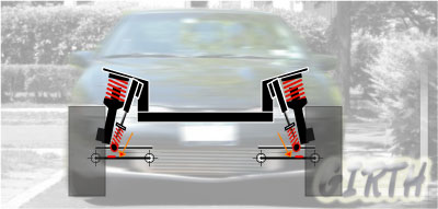

Like This?
building a 3000GT AWD Turbo.

Wow, those actuators are big. I don't think you will be able to fit it up top like that. You will need to flip it upside down. You will probably want to attach it to the strut body like I mentioned before, but point it up.
How big are the springs on his coil overs?

JET - The actuators are not to scale, the springs are not to scale, the car has AGX's with ground control's so there should be pleanty of room! I like your idea of using the swaybar as a way to push down on the lower control arm!

How would the actuators work for normal driving? I'm guessing they will impede on the actual purpose of the suspension dampening. Or, can you simply take them off real quick? Also, how much clearance will you actually get prior to over extending your shocks?
Old 02-07-2008   #27
Re: Supplemental Air Suspension, how should it be done?
You would need to back the actuator out enough so that it didn't touch during normal driving.
I know your drawing wasn't to scale, but I looked at the actuator dimensions and they are pretty huge.

Ksport springs are 420lbs/inch for DSM coilovers, and they compress more then 1 inche when you set the car down. It would seem to me that 400lbs of force is not going to do much, make a skid plate and drive slow over the speed bumps, or mount the IC higher.
~John
Old 02-07-2008   #29
If they put out a true 400 lb of force, then you should raise the car just over an inch with one on each side, for stock GC's. This is assuming he isn't riding on the bump stops.
Old 02-07-2008   #30
15min late to the world
If that is enough to fix it, just raise the car 1" or buy a taller tire.
