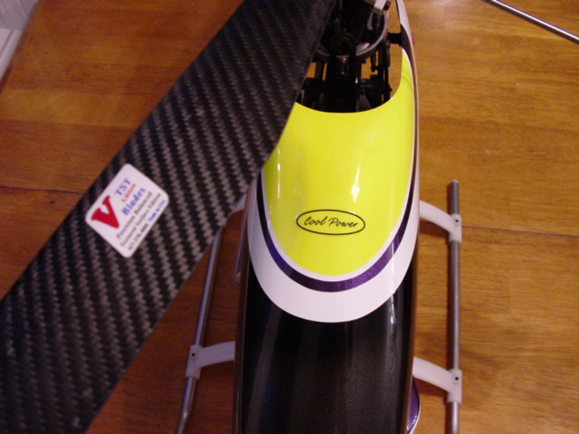

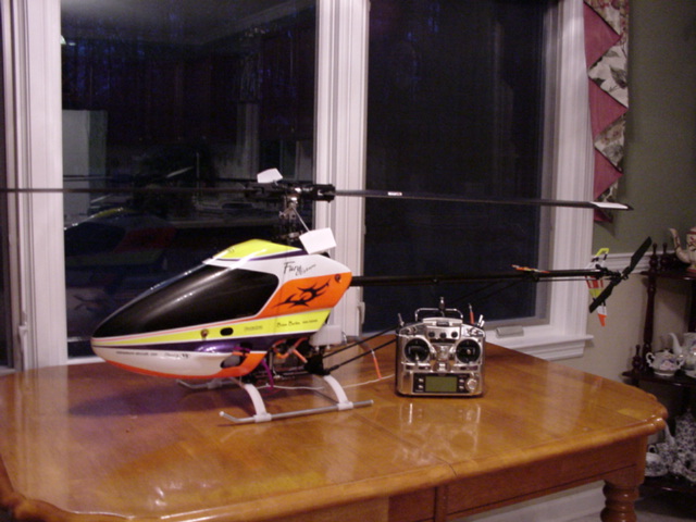

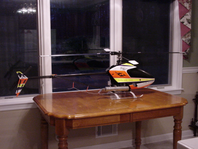

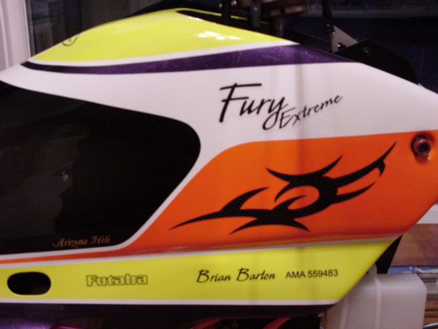

Well since you asked I just got my new canopy and fins today and couldn't resist putting them on and taking some pictures I have a lot on my myspace profile and will upload some High Resolution ones later tonight, still on Dial up (Been sick so I had to push getting High speed back till March 7th...aarrgghh I want to play Call of Duty Damit!!!)

Anyrate I'll stop this novel short - here's some pictures of the canopy
