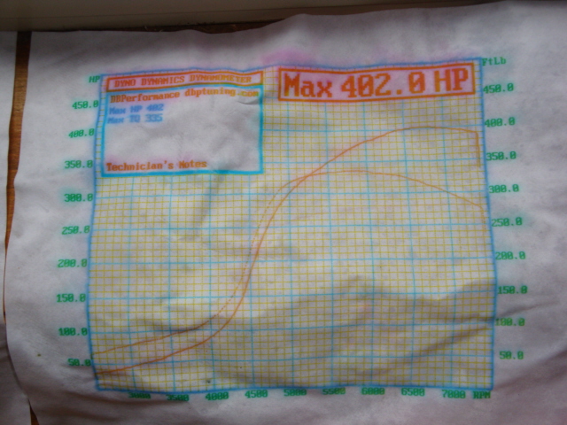

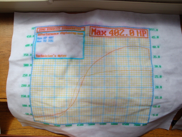

At Porkys last night Scheides asked to see my graphs, and I thought they were in my trunk. I didn't see them. I looked for them this morning, and sure enough, they were soaked in my trunk under a shirt... Thanks broken trunk weatherstrip.
Here are my wet graphs.
HP/TQ and HP/BST

Not making excuses. But from my experience, boost comes on earlier on the street because the motor is actually under more load. That could account for the 20psi by 4400rpms on the dyno vs. others STREET logged 4100-4200 threshold for that boost number. And also, can't remember your setup, but a ball and spring MBC which several others use can make a significant difference.
Still cant complain about +325ft-lbs of torque before 5000rpms with a bolton turbo at 26psi at that same rpm. Considering your uber conservative timing for your CR and e-85, it would be nice to see you push it a little farther before you sell it

On the street it's 20+ by about 4000 rpm.
I'd say it really isn't that laggy when you're driving around normally and cruising.
When you want to go, it goes.

Looks a little laggy but that thing has got to tear your fuckin head off after 4k rpm!! Nice to see what a Holset can do since not many people run em.
If you don't mind me asking, how much did you end up paying for the HX40?

400 is no slouch on a DD w/o correctons on. That is a very quick car there.
My car was making 480-520awhp when it was running 127mph on 92 octane with 3800+lbs.

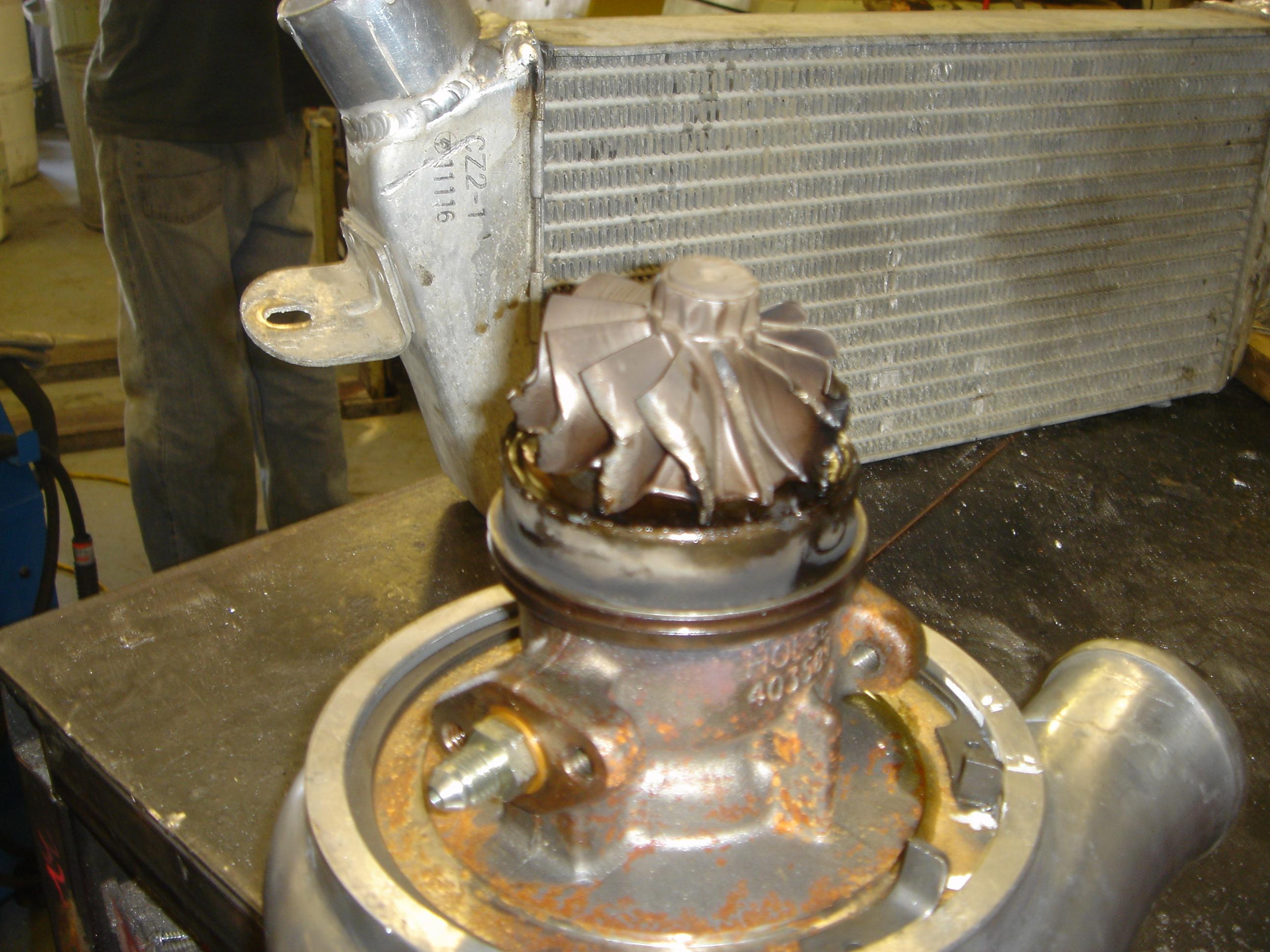

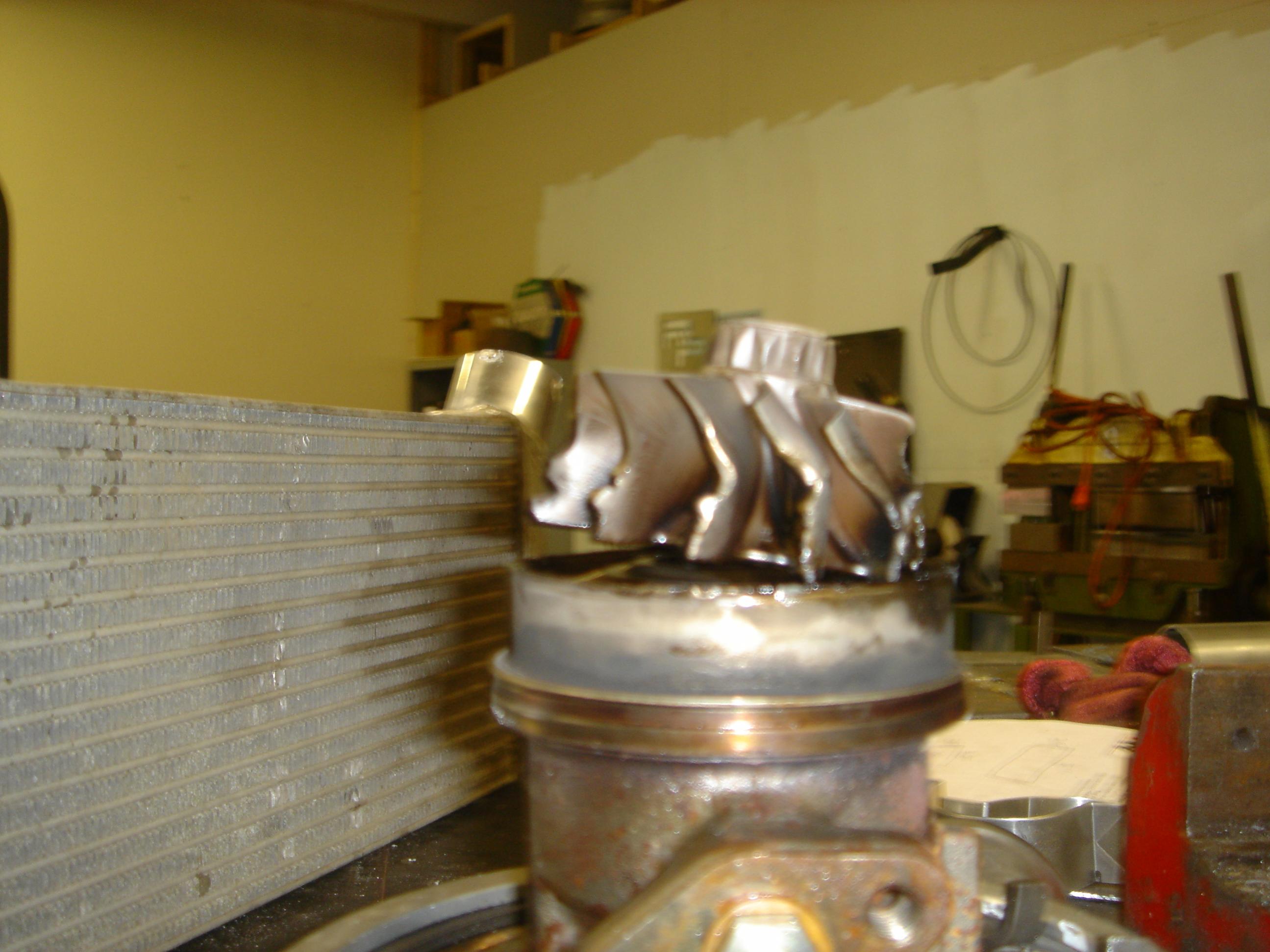

Feed fitting came loose tonight.
Turbo seized.

Hmm, maybe time for a new turbo?
