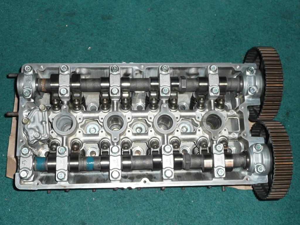

Got my head back from Primo tonight. I have the day off tomorrow so we'll see how close I get to finishing it.
Evo valve springs and retainers, and Supertech valve stem seals.
Heat barrier intake manifold gasket.

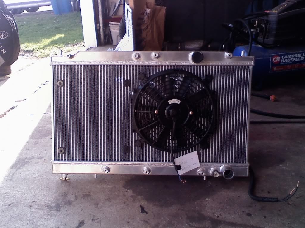

Got the talon running tonight! It's gone more then 5 miles unlike last time haha. The car had a HUGE boost leak but it still pulled like a mofo. I tried not to beat on it too much though. Once I got it home I did a boost leak test and found out I installed my boost controller backwards cause I'm a nub cake. My throttle body also leaked pretty good and my BOV gasket. Got those fixed so we'll see how it drives tomorrow. Only thing I'm concerned about is how much shaft play the turbo has.. As long as it makes it to Boost for Boobies, dyno's and drives home I wont lose my mind and sell the damn thing. Now I just gotta tune, tune, tune!
Here are a couple pics I've been to lazy to post up.

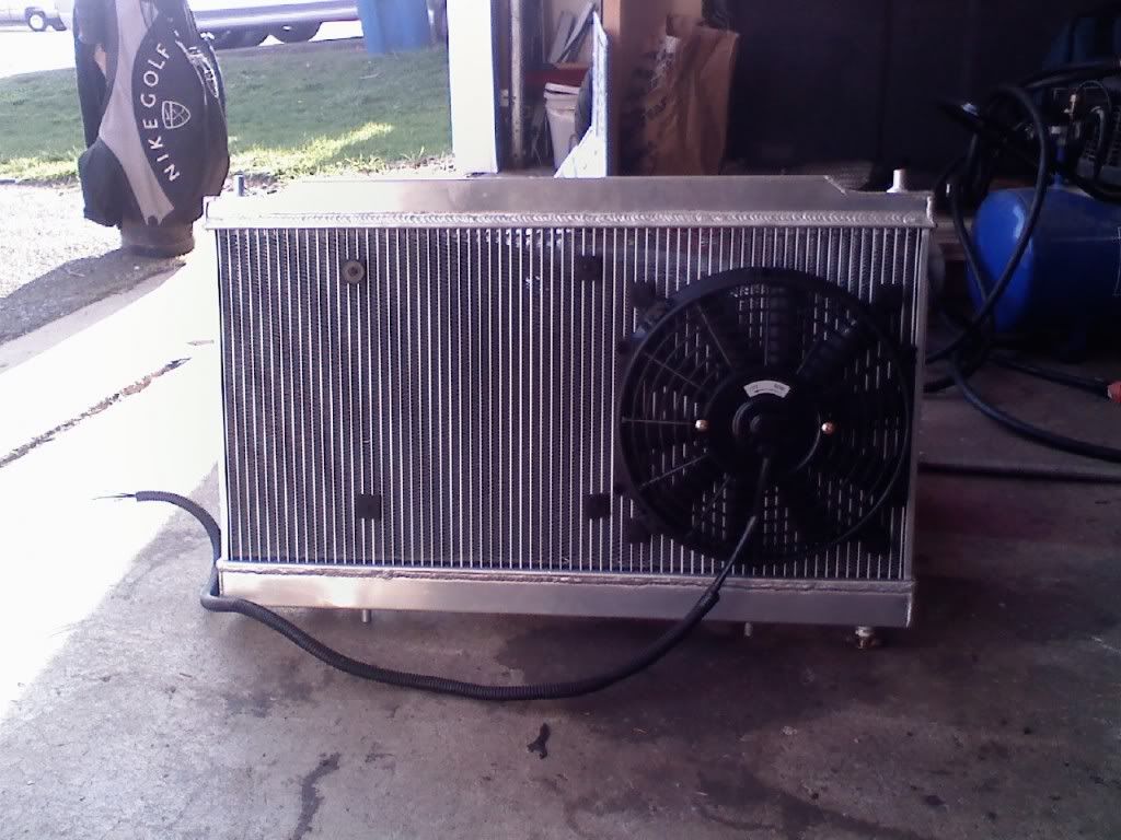

CXRacing aluminum radiator with 2 10" slim fans. 1 pusher 1 puller.

That radiator looks hella-clean. Oh, I bet it cools good too....lol

Car stays around 180-190 all the time now

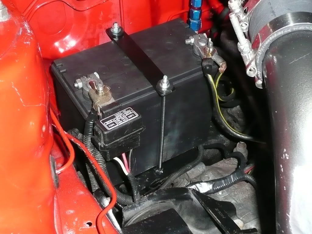

One thing that's changed with my car is I ended up buying a smaller battery. It's for a '01 honda civic and about half the size. I had to make a new tie-down for it and this is what I came up with.
Simple and works well.
