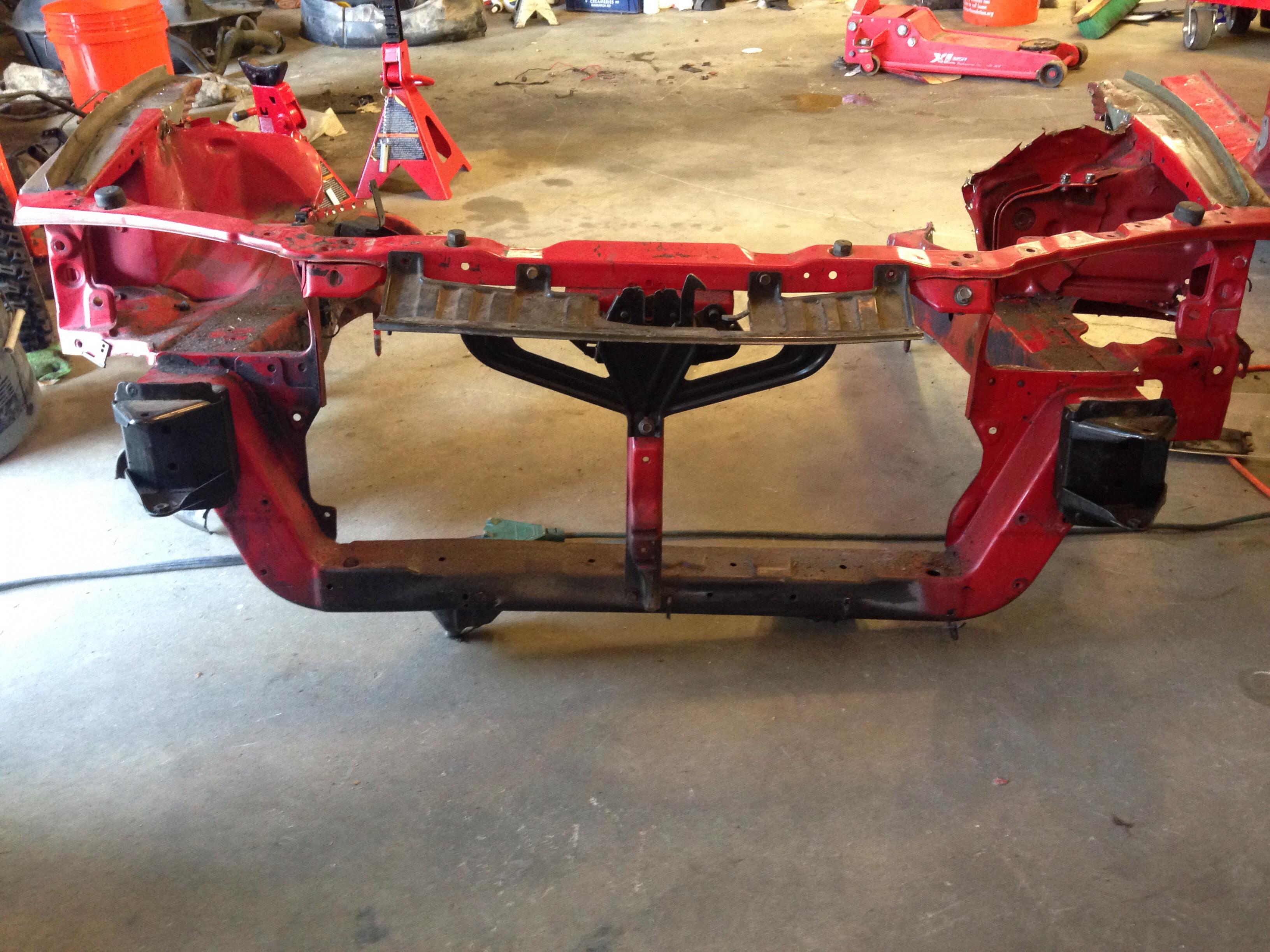

mark4g63t
mark4g63t's Avatar
Join Date: Jun 2012
Location: Twin Cities
Drives: 95 Talon TSI
Posts: 941
Re: 95 Talon TSi AWD
Seems like a good way to raise coolant temps.
Btw, got this for you whenever you got time to grab it
