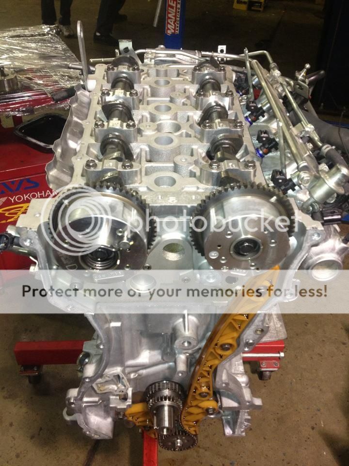

Couple things....
First...
After a lot of stop and go traffic earlier today (first time since dw300/hardwire/fic1100s/e85 swap). The return line had worked it's way off, then after popping it back on and driving another half hour in free and clear traffic, the car died and would not start. It cranked, had spark, had voltage at injectors, fuel pump clearly making noise, won't pop over with injectors unplugged (not flooded)... no leaks under the car... pop fuel pump out.. that line looked loose.. tug both ends out of the bucket, yep that used to not be a 2 piece fuel line. So... I suspect I AM having issues with idle/low throttle fuel pressure being too high and will have to address that. Thanks Scheides for the info/pms last week, it will likely come in handy here! Either that or that line is not e85 proof as advertised. Thoughts?
Second...
I may be a wee bit impatient? Oh well.

Haha, already building the motor, nicely done.
I'm pretty sure those lines are e85 safe, they look like other OEM in tank lines and I've run e85 for awhile, as well as other Evo owners not having the line separate like that. That's the line right off the pump, right? I don't see how the high pressure would cause it to split though, because during boost you're pushing over 60psi through it.

Yeah, I am kind of scratching my head at the busted line. Haven't searched on it much yet, just figured I'd post the pic and get people's thoughts. It's an easy fix, but I'd like to know why it happened. It's not an OEM line - it came in the MAP fuel pump install kit - http://www.maperformance.com/map-fue...evox-fpik.html. There were no kinks, wasn't squished under anything (bucket gets pushed down when you put it in the tank, so I was careful to route the line correctly), just odd.
I guess I'm not sure if they advertise it as E85 safe, so it could just be the wrong tubing is all. Going to give them a call and sort it out in the morning. Car's sitting in a church parking lot right now... hoping baby jesus watches over it? lol
