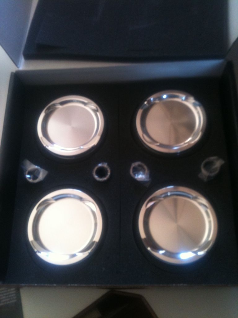

Ok so parts I already have
Exterior
Koni yellows w/eibach coil/springs
16" Rota slips
drilled rotors
2GB talon front bumper
2GB talon rear bumper
95 talon twist sides
ABS delete w/SS lines
3" v band down pipe
Custom front exit exhaust
Carbon fiber hood
Interior
DSM link v3
Aem wideband
Phantom gauges
Boost
Oil press
Water temp
Volt
Black interior
Door skins
Dash
Center council
Rear speaker covers
Door handles
Tenzo R seats
Engine
2.4 6 bolt shortblock

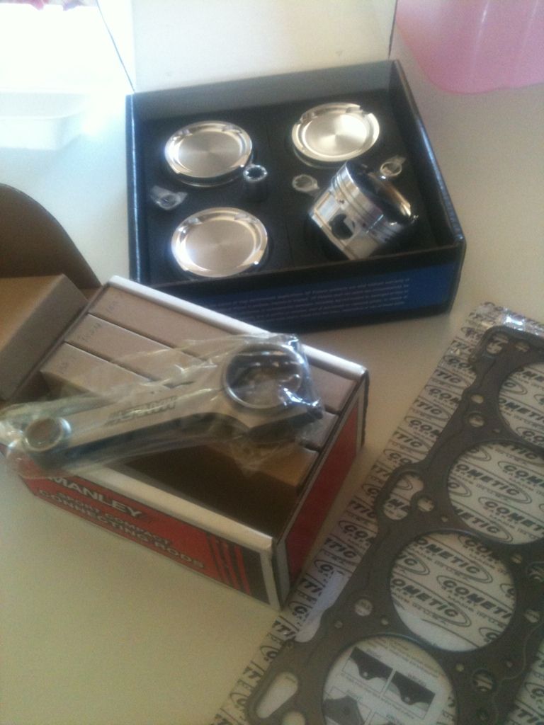

CP 87.5 9:1 pistons 22 wrist pins

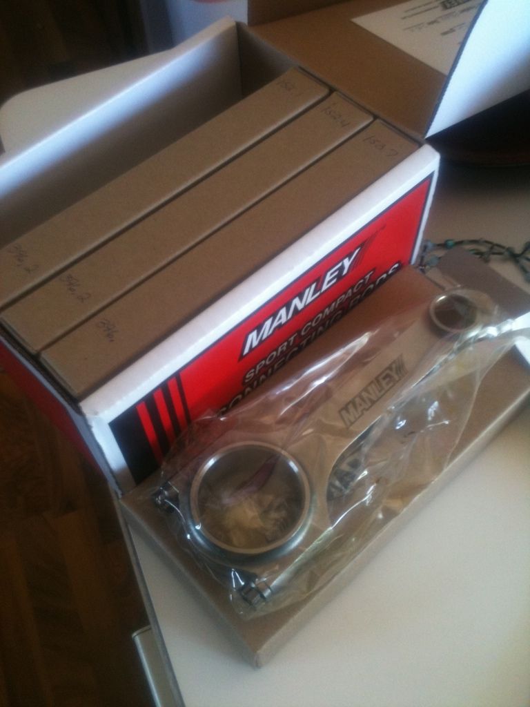

Manley h beams w/22mm wrist (new style)
Kiggley main girdle
ARP main studs
L19 headstuds
Cometic MLS 87.5 headgasket
Turned down BS
1G head slight port
FP beehives
GCS 3 cams
OBX ramhorn t3 Manifold
Motor is at gosh will be gone through machined and assembled Pistons are still 3 weeks out
Fuel
Aeromotive fpr
Walbro 450 pump (new e85 design)
Kenne belle boost a pump
FIC 2150cc injectors
Stock rail with an fittings
680 small battery
FP non recirc with k&n filter

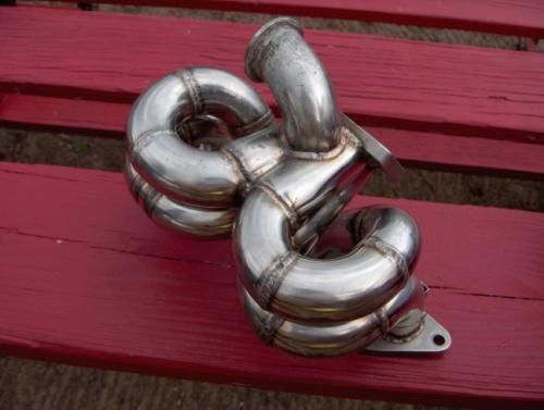

I was thinking a 6262 journal bearing in a bolt on housing and a FP race if funds get low. But as of right now plan is a 6266 t3 top mount exhaust mani. The only thing is there's a $1500 difference in the set up. So I'll have to see where my money's at as it's the last thing I'm buying.
Halan these are the clutches I'm talking about.
http://www.tmzperformance.com/Mitsub...%2520Kits.html
Top mount is just for show, so if that's what you are going for cool. If not they were built for 42R shits and well 90% of people don't even need those with all the new turbo tech around.
That is kinda my plan, do a bolt-on housing for now and see what it can do.

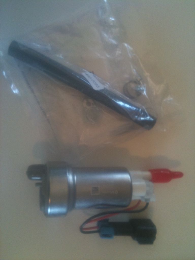

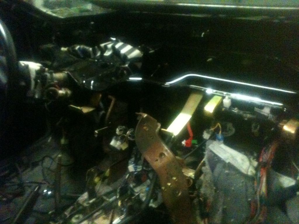

I'm currently pulling the black stuff out of my old shell to put in the new one then just wait for parts. My walbro 450 should be here by the end of the week so I might install that over the weekend, put in all my gauges, and black interior.
Am I going to be fine with the stock rail stock lines? I have an feed lines from the filter but that's it as of now. Also I plan on staying on plugs and wires just gonna get a spark box like a dynatex? Don't know how to spell it lol

How much power are you looking to push with your fuel pump? The walbro 450 should be better than my DW301 and my DW301 +1000cc's should support around 600AWHP without getting a hardwire around 35psi base fuel pressure or 25psi boost pressure (flow rating at 60psi).
Simply put, you'll only need lines if you want to help your fuel pump out. With injectors that size, I'd be more worried about return line sizing and fuel pressure regulator sizing to ensure you can get the baseline fuel pressure to a level of sanity.

Is the new walbro 450 the same physical size as the walbro 400? Do you have flow rate comparisons between the two? Or is it just 50 more lph than the 400? If so I may be tempted to purchase one myself, it's a direct replacement for my OEM pump (same dimensions).
