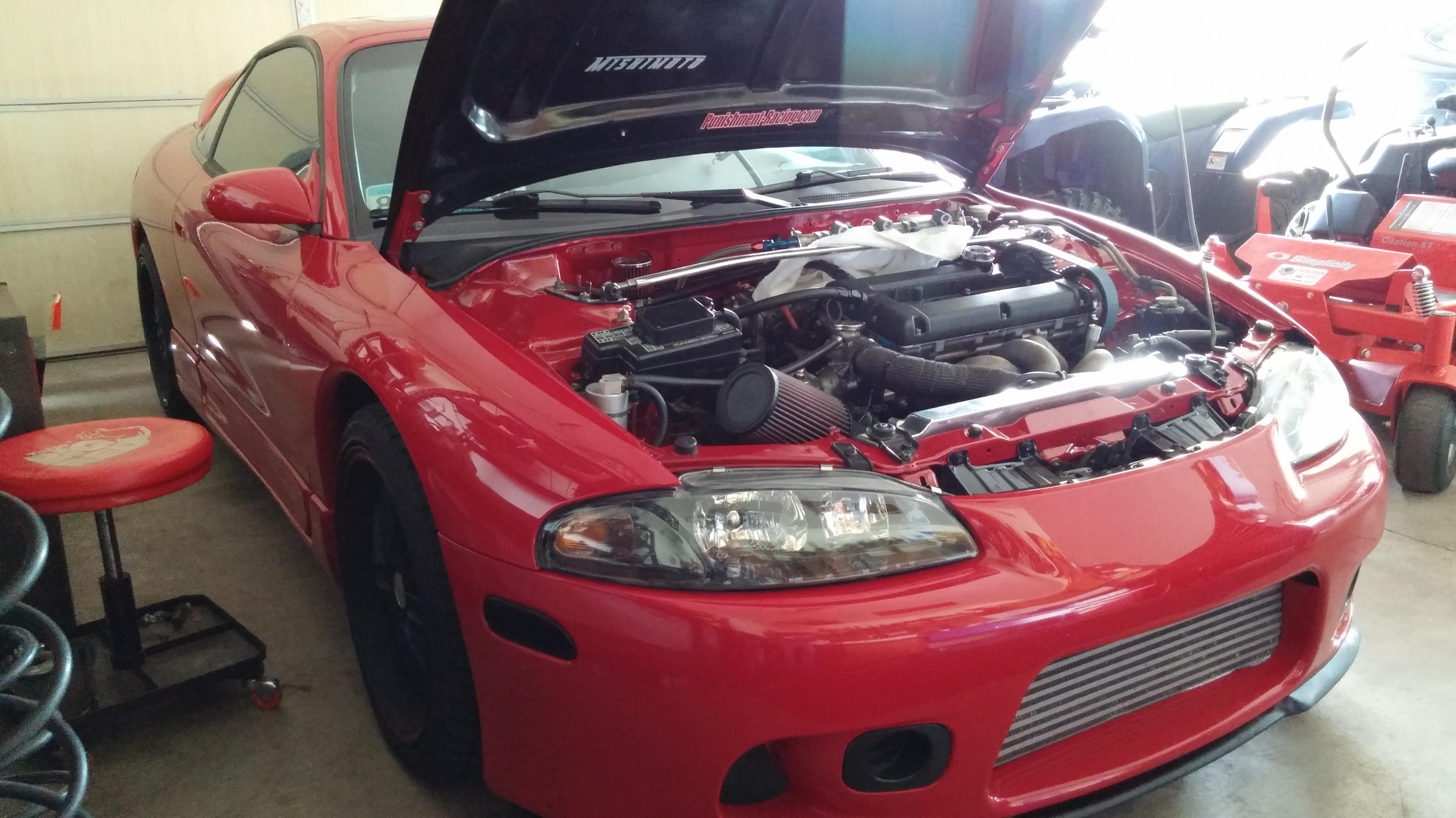

Figured id start a new thread for this years winter/spring build and all the rest off the stuff that goes down with the car.
Specs:
1995 eclipse gst awd converted
Welded diff
Gutted
All autometer carbon fiber gauges : boost, oil pressure, coolant temp
Battery relocated to the trunk with cutoff switch
Thats all as far as the car sits right now.

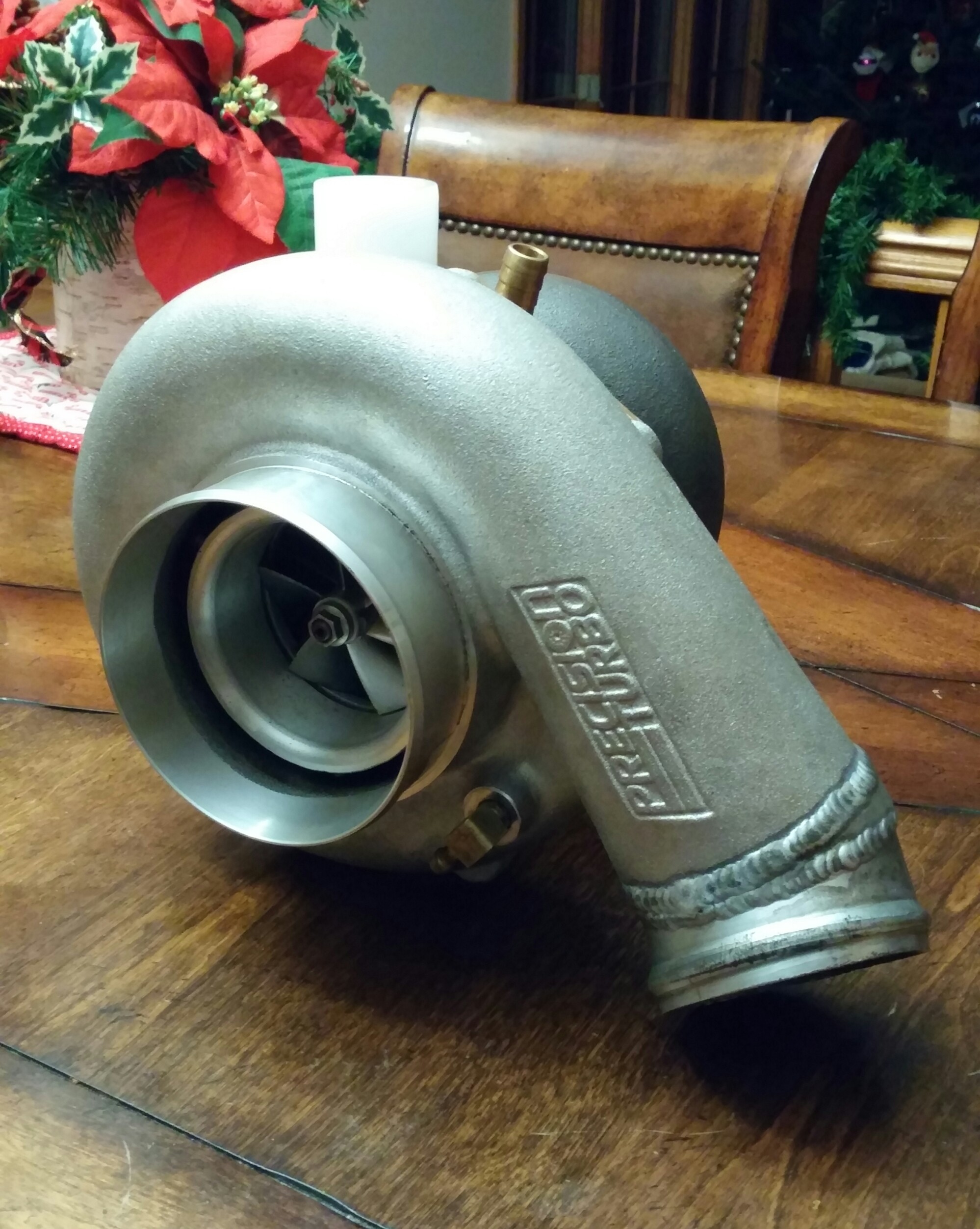

Pte 6766 .96 a/r undivided t4 (have)

Theres the plans for the motor some things i havnt decided on quite yet but input is good. Kind of a big goal for me right out of the gate but go big or go home. Alot of time and money will be invested and cant wait to start putting her back together. Will keep posting updates as the build continues. Enjoy

Maybe i am wrong on this, isn't the exhaust housing on this turbo a bit small for 800 at DB? I know on my t4 6266 I ran a 1.0A/R but that was twinscroll, so probably not the same at all. Actually the more I think about it, single scroll that is a huge A/R I think.

It is a pretty big housing for sure. Itll be nice when its done to look at what ive built. 800 is goal even if i come close to it itll make me happy.
