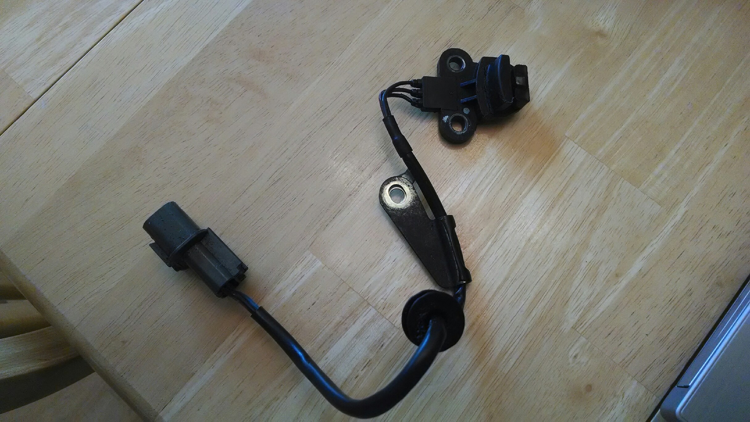

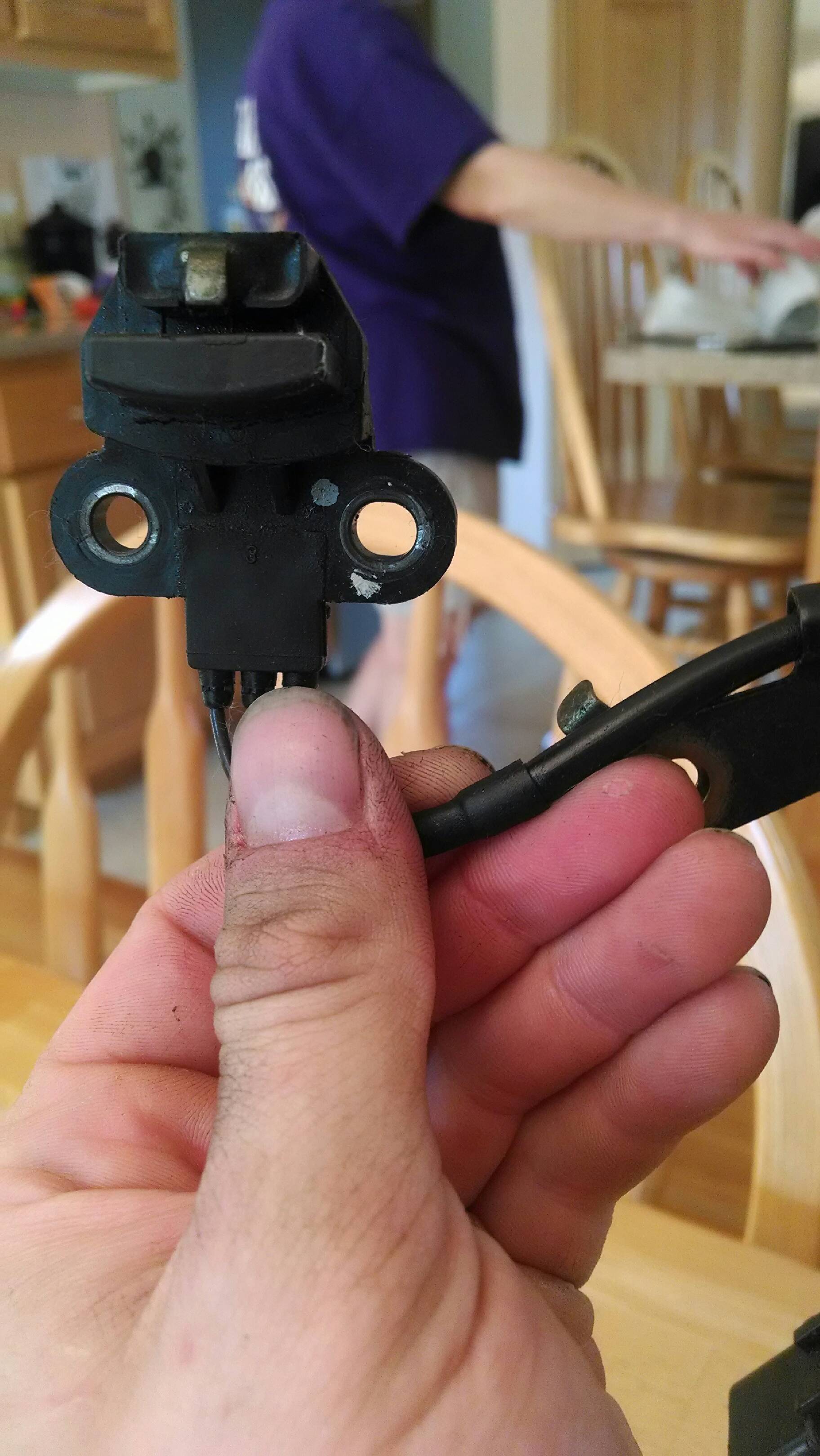

I am almost done putting my car back together after having the head off. I cannot figure out where this hooks up to. I know it is the cam position sensor and it sits behind the intake cam, but I have no idea where the connector plugs into.
Please help! Im hoping to get this running asap.
Thanks,
Cole

I think it might have been on there still from when the previous owner put a JDM engine into it. It has the CAS on the passenger side of the intake cam and that is actually hooked up.
So my question now is, do I even need this?
mitsukid124 is offline   Reply With Quote
Old 07-05-2014   #3
Re: Where does this sensor go?
If you have a 1g cas you do not need that one

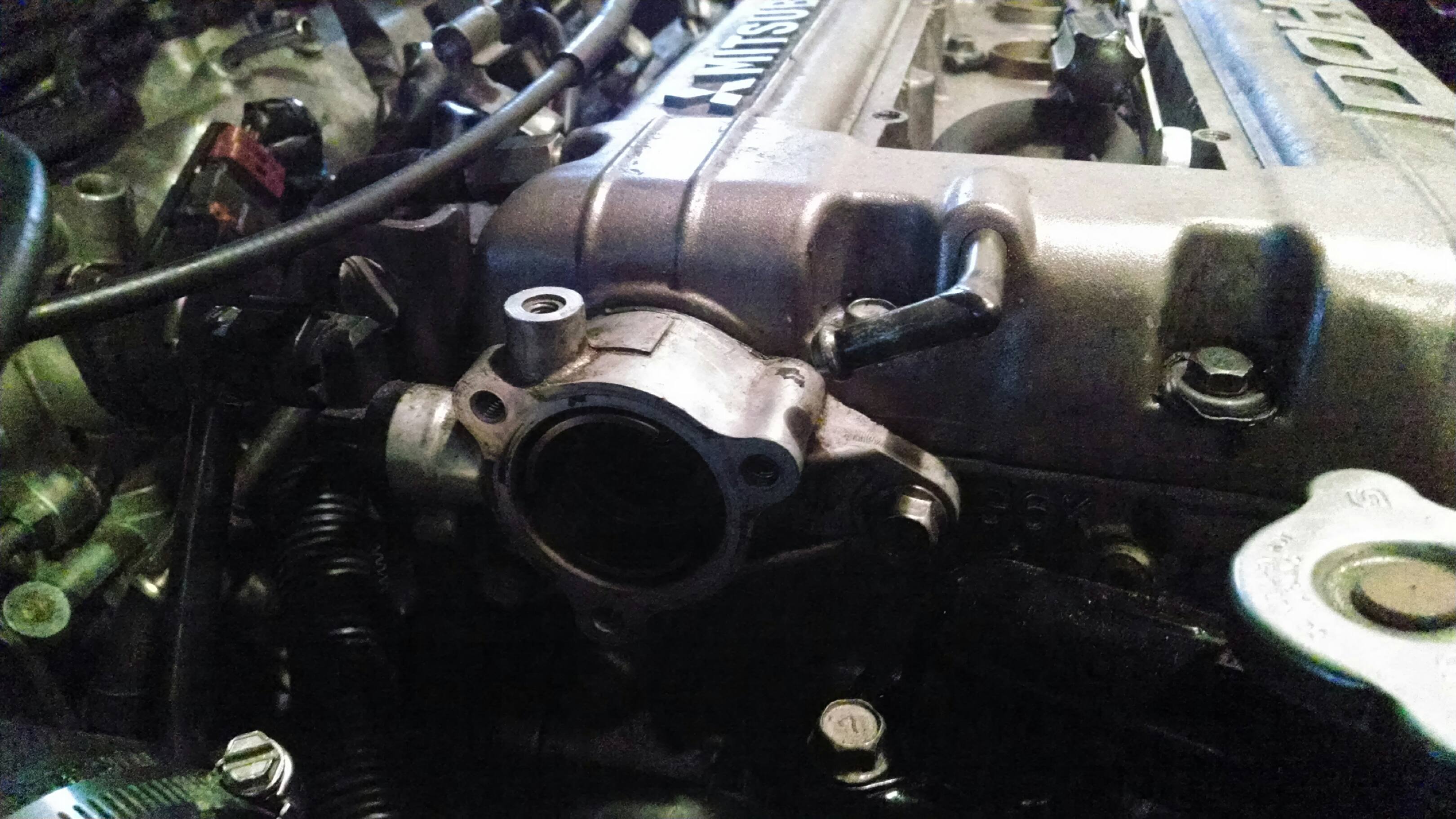

This is a pic of what I believe is a cam position sensor that is on the passenger side of the intake cam.
mark can you confirm this for me or not?

That's a 97-99 cas.

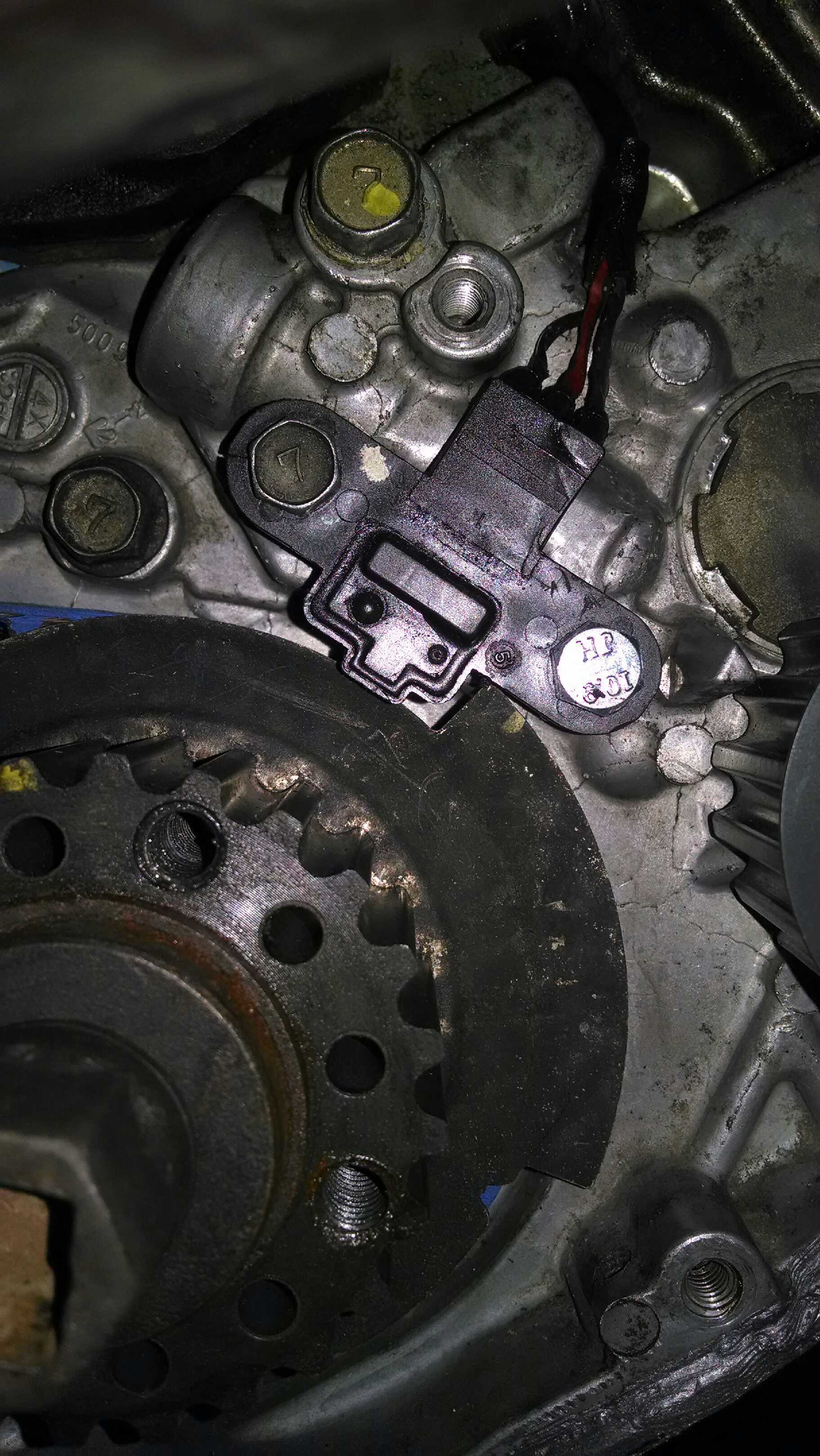

so this pic is the crank sensor right? I feel like missing something here, but if I truly have no need for the sensor behind the cam gears and only the sensors in this post then I can take that out? no harm to anything?

95 and 96 had the cam sensor behind the cam gear. All others had it on the end of the cam. It looks like you have a 97-99 style cam sensor so you shouldn't need the one behind the gear.

Ok cool, that'll be $45 back in my pocket. I replaced it because the sensor was broke. Thank you guys for the help!
