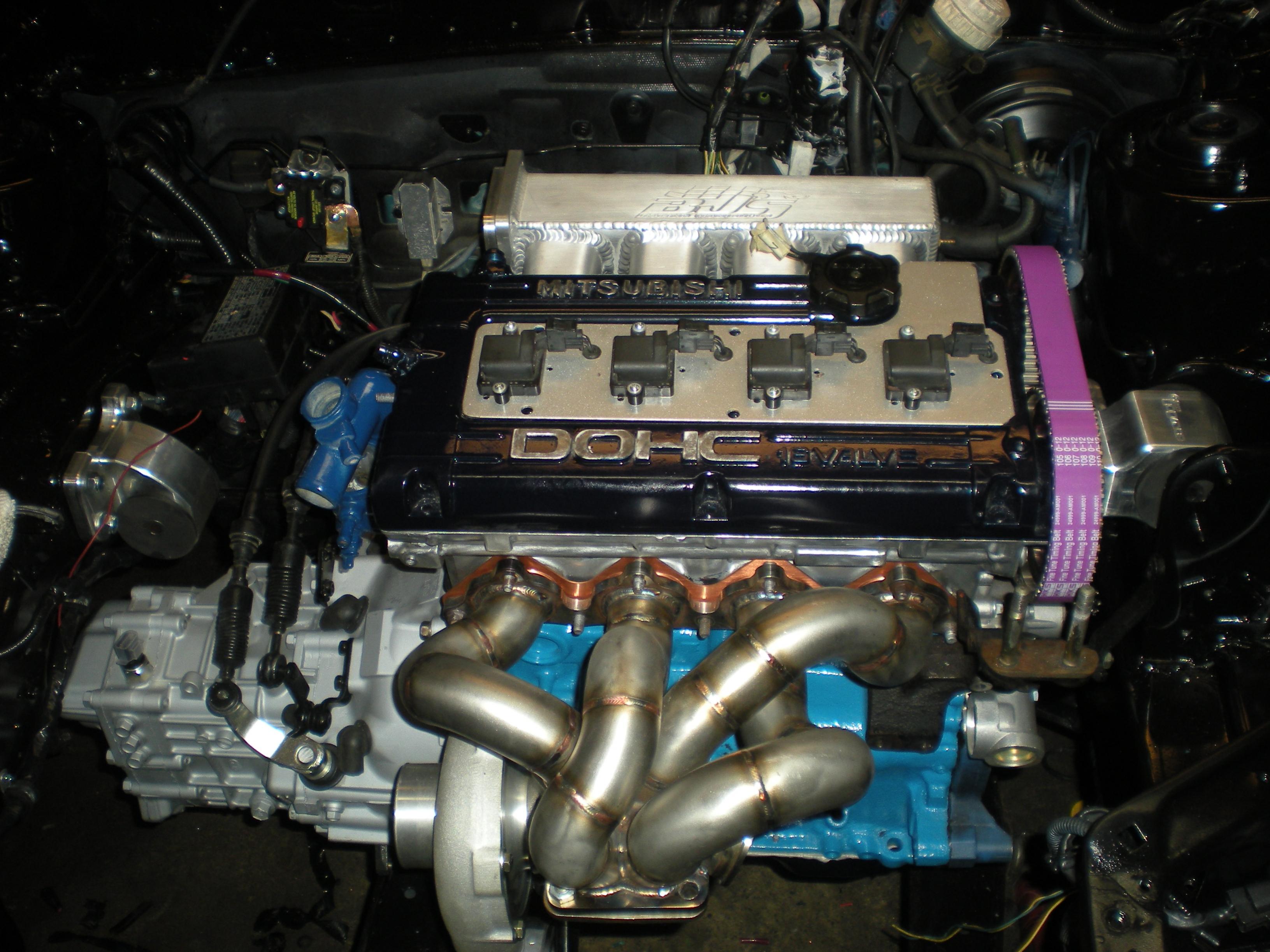

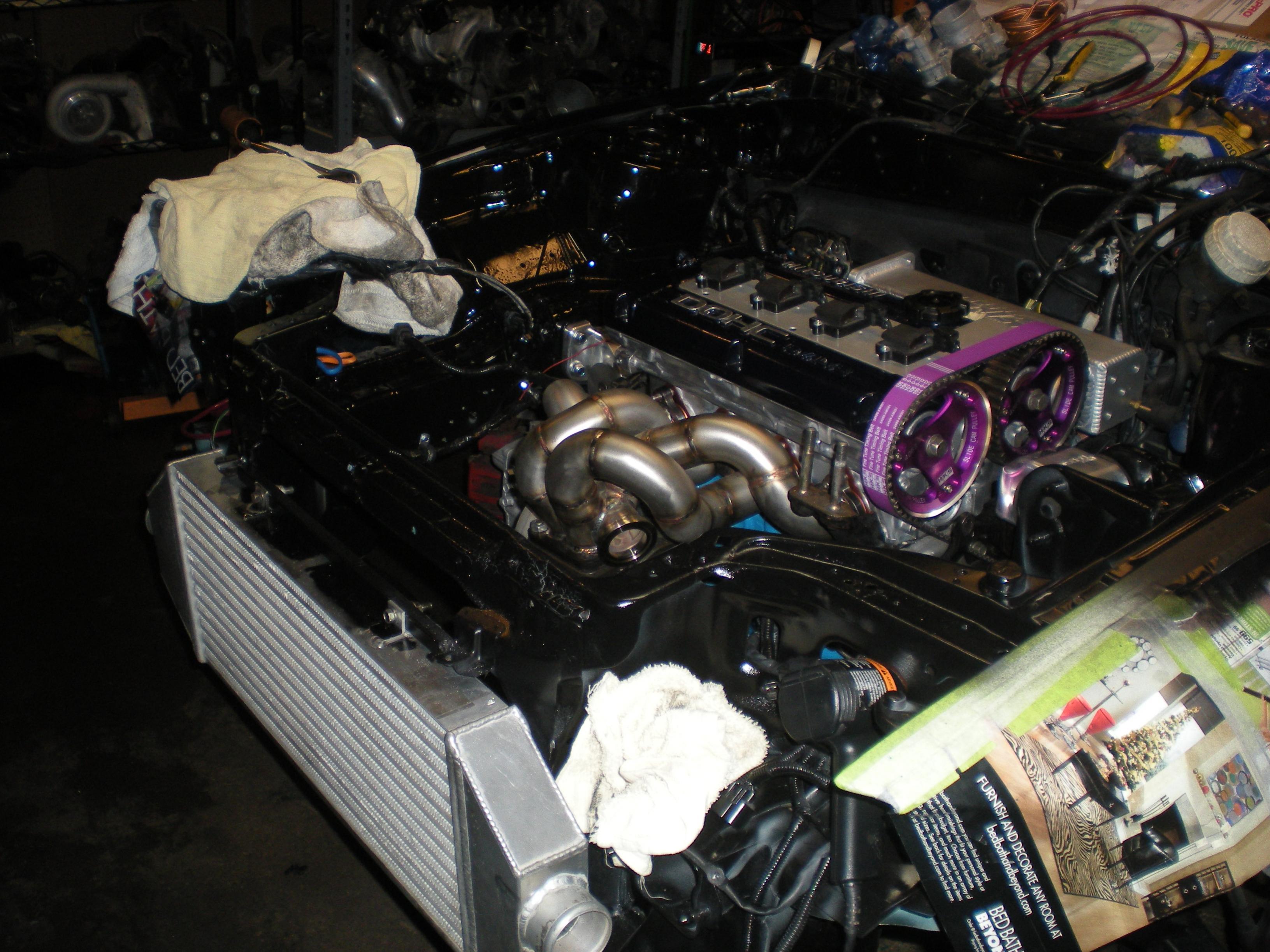

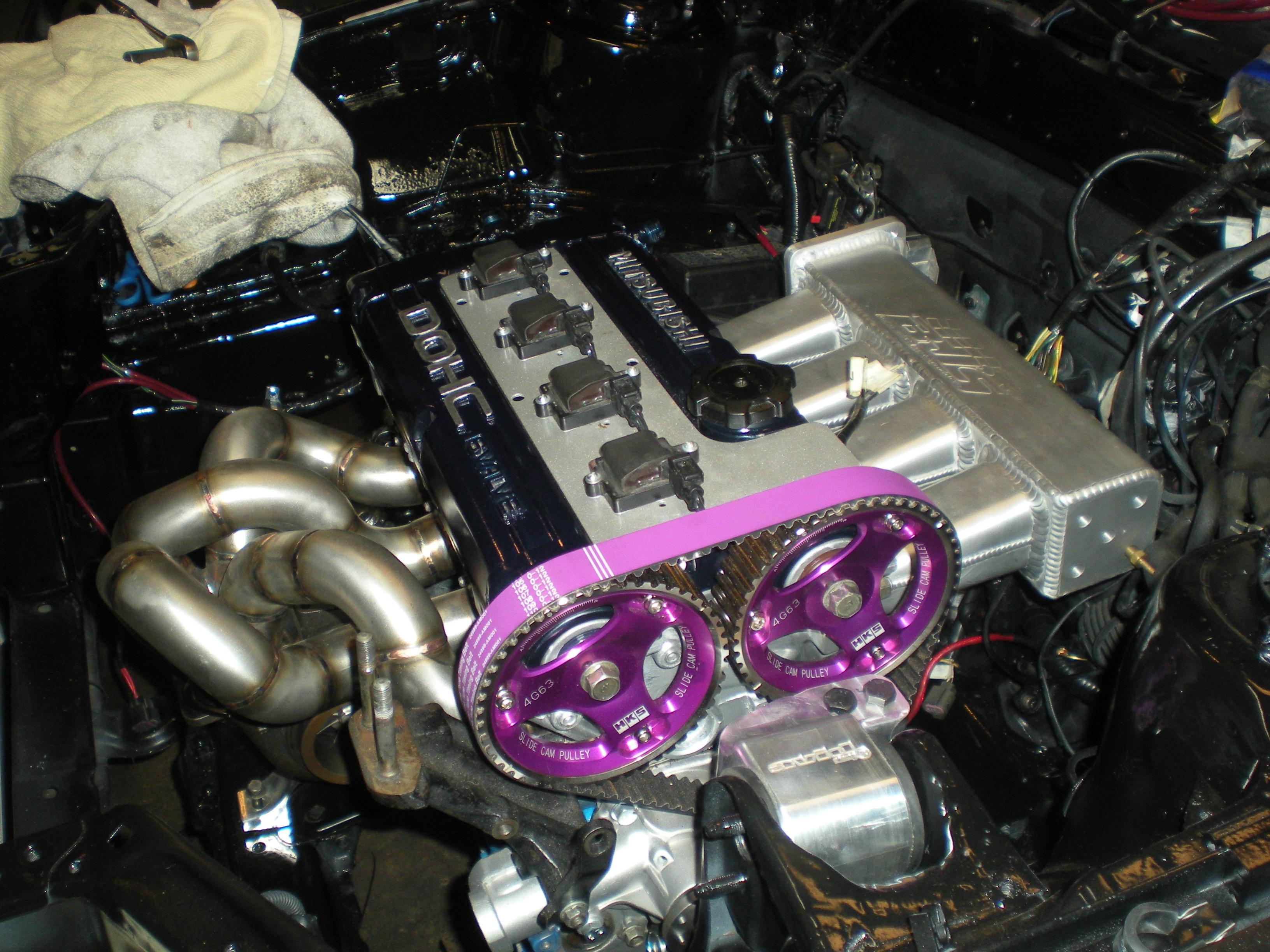

Some Pics of my Talon
Specs on the setup
Crower I beam rods
Eagle Cranck,ACL Main and rod bearings
ARP main studs, Wiseco HD 20 over pistons
L19 Head studs, BC 1mm over Valves BC springs Titanium retainers
Kellford 280 Cams, PP Head,HKS cam gears hKS timing belt,cometic head gasket,Top Line revised lifters,Magnus Intake gasket BJ Cylinder head Manifold, Punishment Racing Manifold, FIC 1150 CC injectors Magnus Fuel rail Aeromotive A1000 Fuel pump, Shep Trans Stage 4 , QuarterMaster twin disc. Will be posting more pics of my project.

What fuel?
What turbo?

its a PTE 6766 Turbo running with C16 Fuel.
1G4G63 is offline   Reply With Quote
Old 01-10-2012   #5
Re: Project EvilTalon
We luck out here with E85 being readily available. We don't need super expensive c16

Looks like your intercooler will be a bottle neck, too thin, not enough cross sectional area.

Not to be negative! Otherwise looks good, 6766 should make some awesome power!

Yeah but in my area the nearest E85 station is 300 miles LOL. Plus my brother works for VPRacing

YEah your correct I was actually questioning my intercooler. thanks for the input
