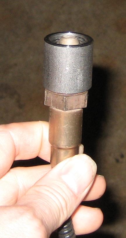

This is a picture with the sensor screwed into the bung, the sensor doesnt even stick out past the bung, doesn't look like it would meter well like that.

That one does look a little long.

lol, thats what I was thinking, so I should maybe turn that down to say half that long?

Yeah it should only be like a 1/4 of an inch if that.

Well I guess its the extended length one, looked on innovate's site. Why it's extended im not sure... O well, I guess I'll make 2 bungs out of this.

They make the extended ones for obd2 cars when you take out the cat. So the rear o2 doesn't set off the cel. But, why they sent it with your wideband. I have no clue..

It may be there attempt at making the sensors last a little longer. You can cut that down or buy a shorter one. The ones I use are about 3/8" or so.
