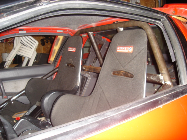

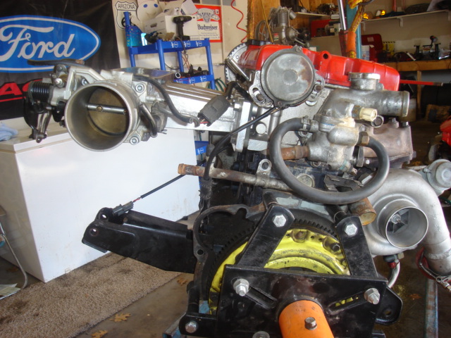

since everyone else is doing it, I figured I'd post up what Ive been doing on my car the last few months.
-6pt roll bar (prebent hoop and straight bars purchaced from LSE)
-Infinity Q45 90mm throttlebody
-3" intercooler pipeing from the intercooler to throttlebody
-3" cold air intake
-dual in tank walbro 255's (E85 takes 33% more fuel you know)
-Innovative LC1 wideband
I have it all pretty much back together. Im just waiting for some injector O-rings and a serial cable for the wideband. I think it will be running This weekend and be ready for some E-85 tuning. Only one weekend to late LOL.

still running the scm-61. the q45 and the 3"ic pipeing make it look tiny though

Its pretty good it. It has the cut housing and I did some extra porting on my Hrc downpipe. If I were to do it over I'd go with garrett housing with V-band discharge and external gate

I got the intake from John at LSE. (but I dont think he made it) Its a little boxie but it does the trick. It has a large plenum and tapered runners.
The fuel pumps were a little tricky since I havent seen any other twins on a 1g fwd. they barly fit in the tank
