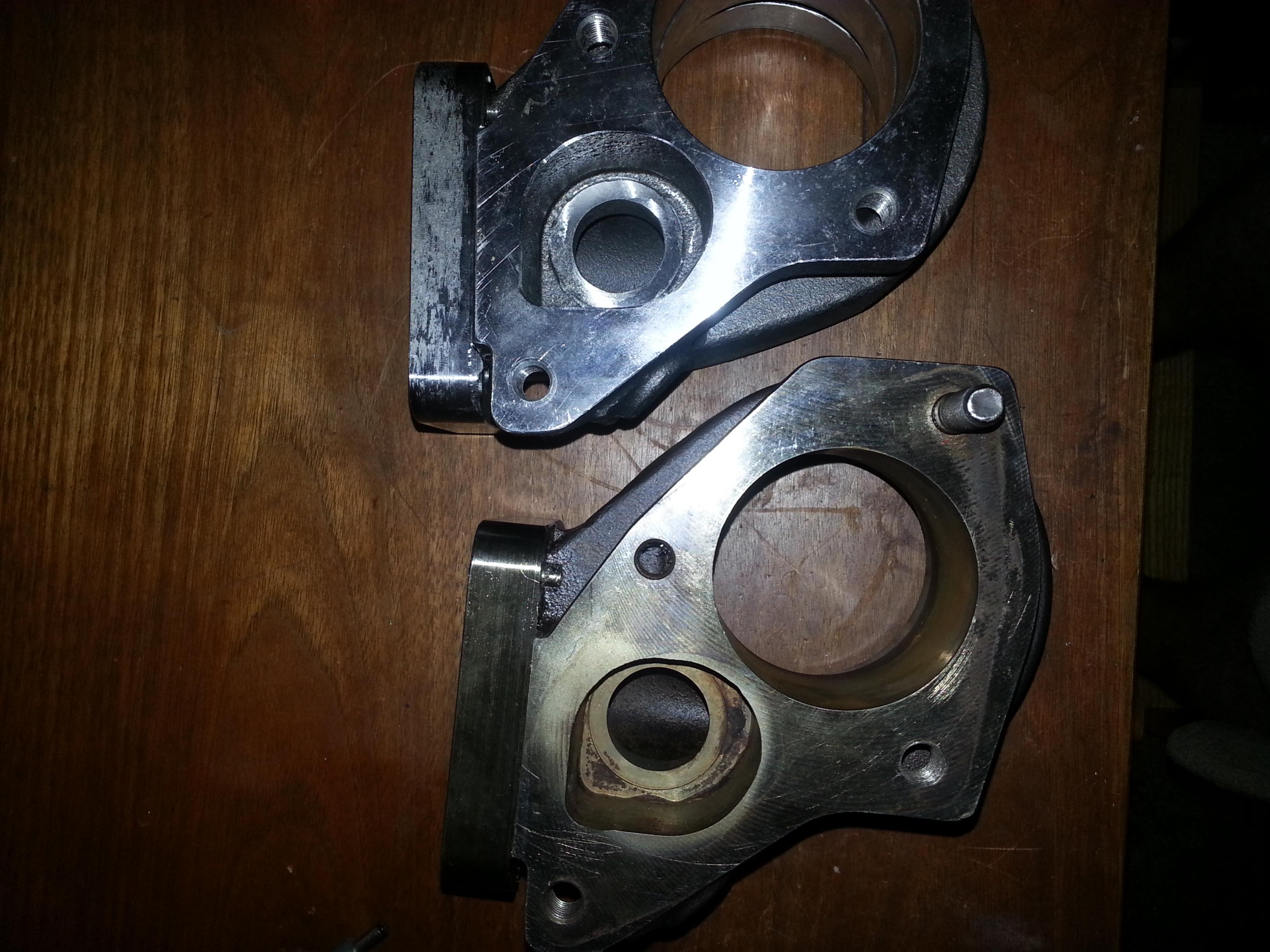

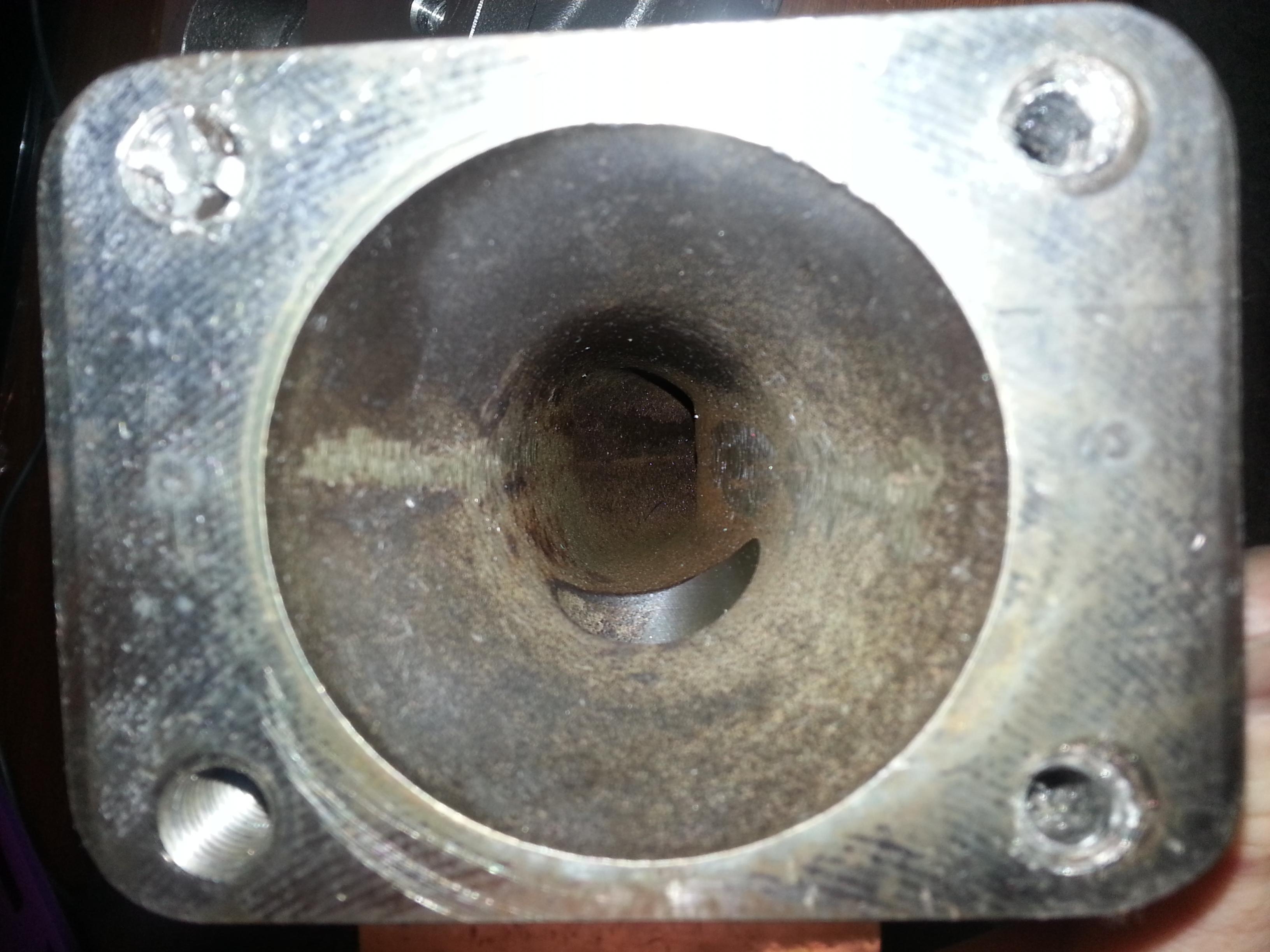

Is that hole in the exhaust inlet on the first pic from a stud/bolt hole? If so, wow.
I guess it probably won't affect performance really since it'll be sealed, but that's just bad.

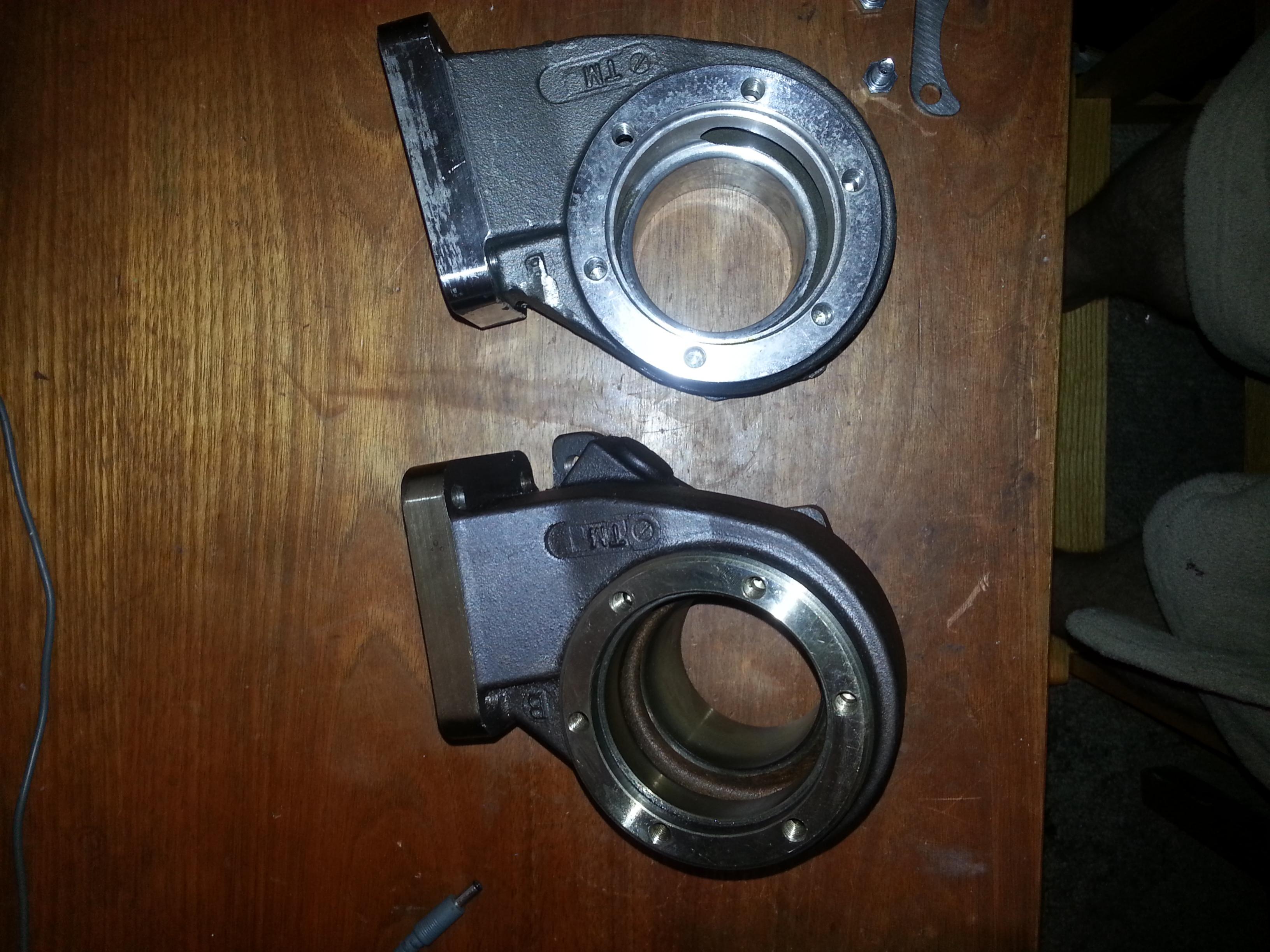

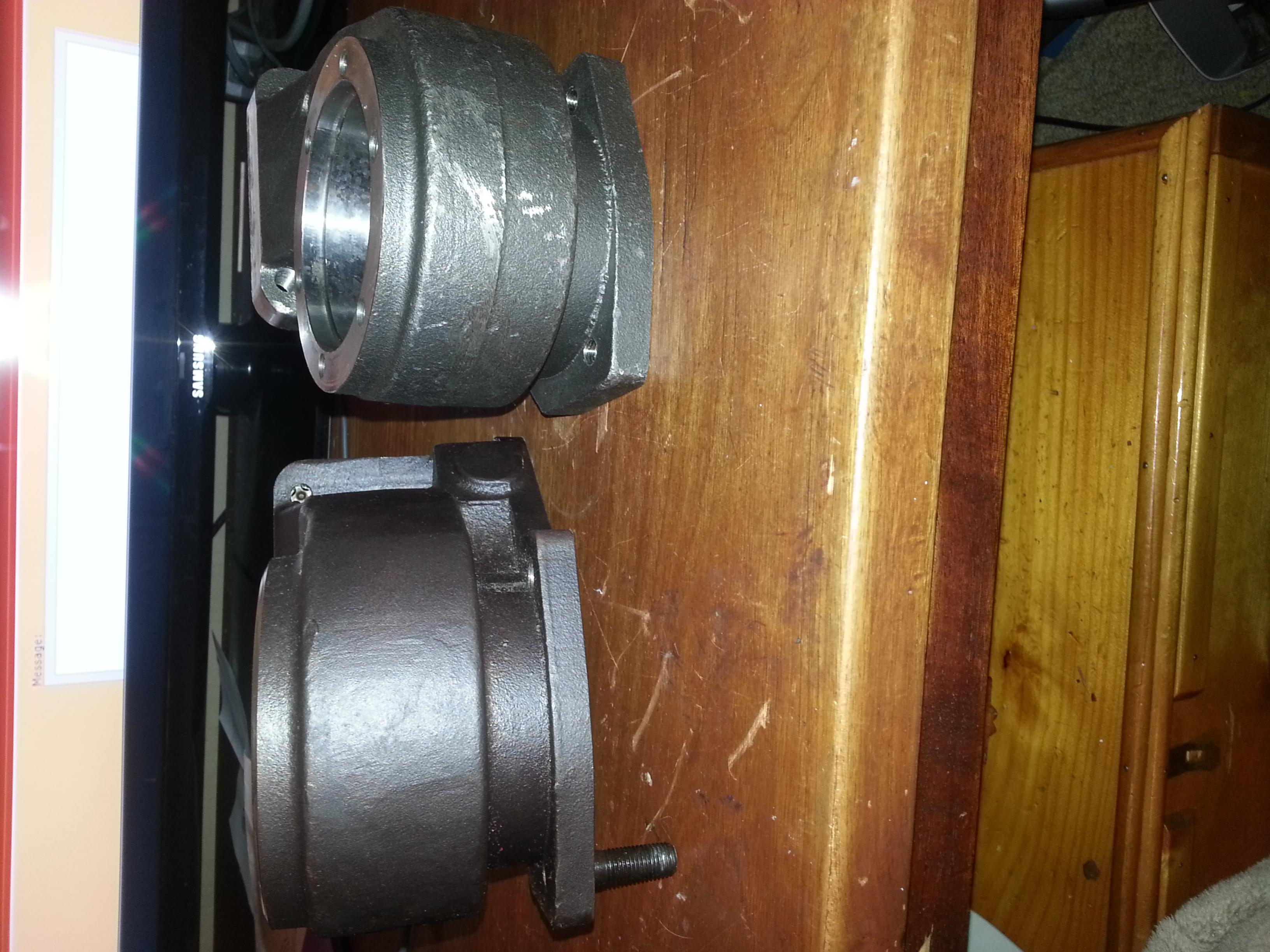

I just took off my old housing and compared - they are night and day difference.
the one that was on my HX40 - is near flawless, even the out color is 1 solid color and all the casting is removed to look smooth.
The one I just got looks like a child was working on it.
The 2 holes on the exhaust Inlet are where they drilled holes that hold the turbo to the exhaust housing so ya it would be mostly sealed as those 2 bolts wont be removed.
the 3rd hole actually is the same bolt as the first 2 only it creates a bump right in the middle of the channel.
i'll take side by side photos and post in a sec

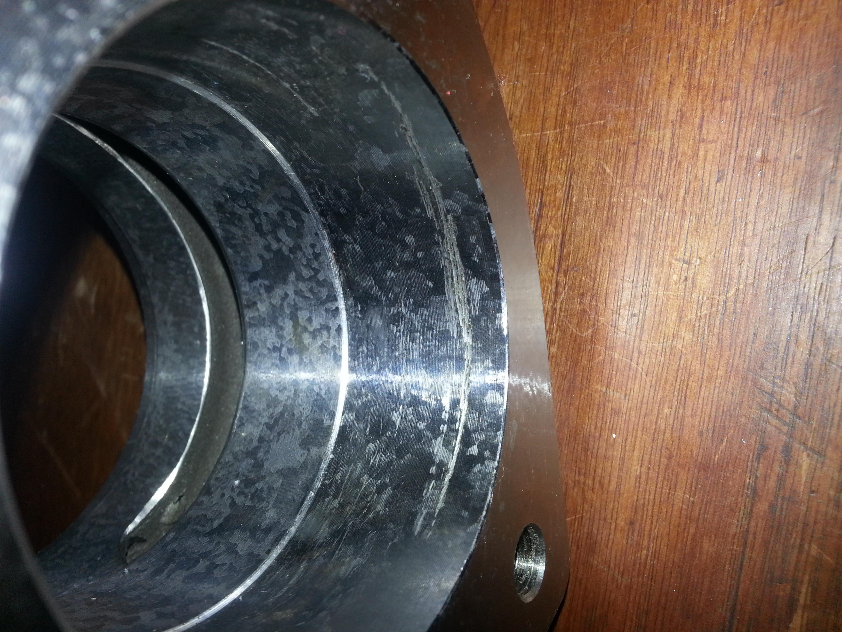

edit: just noticed on the "new" one looks like they took maybe an HX35 housing and drilled it out, and it also looks like maybe it was used and a fan blade hit the edges - picts to follow

Here are picts of old /new

Yeah i would definitely try and get a replacement, sucks you will have to wait and deal with sending that one back. Extremepsi has always been really easy to work with for me, i'm sure they will take care of it for you.

The old one looks nicer than the new one. I'd try and return it also.
The old one only has 10 track passes and dyno time on it.
But the quality difference is huge. I talked with extreme today they asked me to send pictures
and they'll discuss it with bep and assured me they'll take care of the issue.
So only time will tell..
In the mean time back to working on my old housing. Brought it to work today in the hopes I can get one of them maintenance guys to fix it. A few of them used to race cars in there day so hopefully we can sneak it into the machine shop and take care of it.
In which case ill just ask for a refund for the new one.

Well update.
Sent pictures off to extreme last nighr but didnt have any reply today
Maintenance was able to knock out the broken tap yesterday however the one size they were out of warranty 10m x 1.25 taps. So after checking every auto parts in my town and the one next to me as well as Lowe's. I finally found it at a "fastenal" store.
So far today maintenance is working on the last hole now or was till he got called to fix our pos stretch wrapper. He leaves in 45min so hopefully he'll have time to finish before he leaves.

Update - back in business. The last one took some skill to get out. Thank goodness I work for a multi million dollar company with a huge shop on site. And beer money in hand goes a long way here in the south lol.
Hopefully everything will bolt back up will attempt it tomorrow

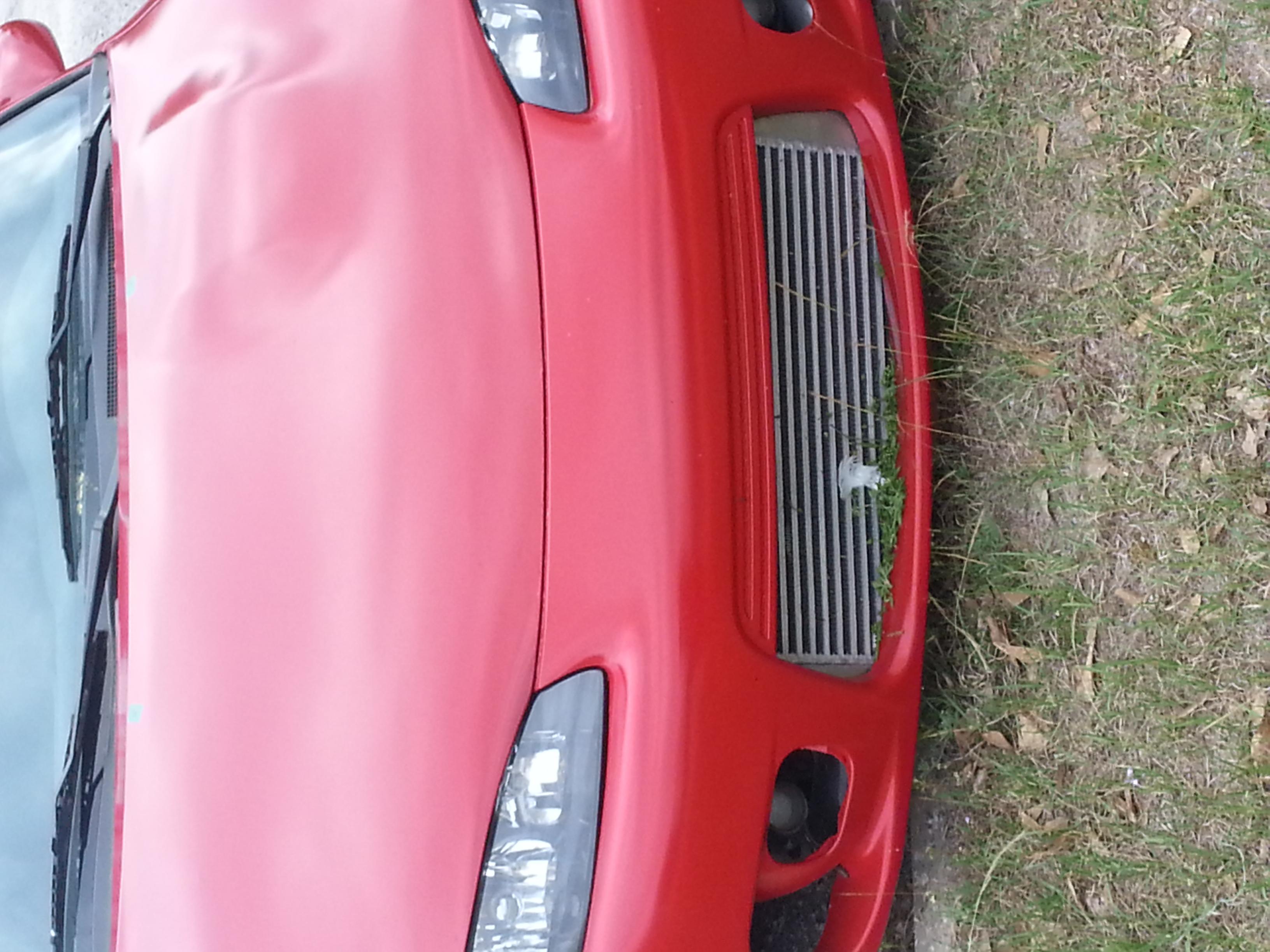

Oh the joys of owning a dsm.
So yesterday I finish installing the new hx40. Every thing went together perfectly.
And decided to take the car to work today....when....
On my way into work, I was taking it easy on the car as I just finished working on it and at about 4 miles from work I'm cruising along doing 40mph, which probably saved my life.
A young blonde women who looked like she was texting and driving or picking something up in the passenger seat. Started slowly creeping into my lane, then she drastically swerved into my lane. And now she is completely head on coming at me in my lane. I grab the ditch and she's now still coming over she's hit the rumble strips on my shoulder which got her to look up. She get 2 tires off in my shoulder and we are less then 3 Car lengths away and she swerved back into my lane. Missing my car by inches.
And stupid bitch didnt even get back in her own lane or slow down, she stayed in my lane for at least another 1/4 mile before getting back into hers before going around a blind corner.
And now my car is smoking like crazy. Pretty sure I dented the oil pan.but didnt get a chance to take a good look.

Oh and yes that is a bird feather in the fmic. Haven't found the bird yet either
