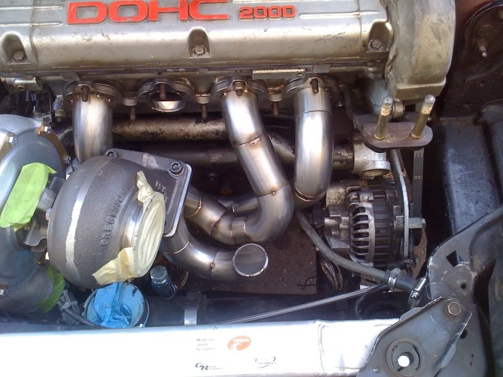

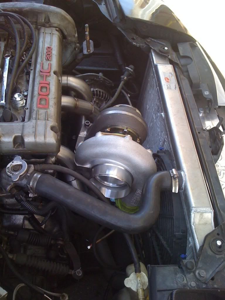

So I cut all the tack's and moved the collector again but the turbo is perfect where I got it now and I will not be changing the manifold again.
well almost finished with the manifold. Here's some progress pictures.
Getting things nice and tight!!
Test fitting in my car
There will be two of these hanging off the sides on the manifold too. Just waiting on final pipe fittment before I make holes and put the wastegates on it.

Posts: 1,374
Re: Progress since last year
Looks damn good!
