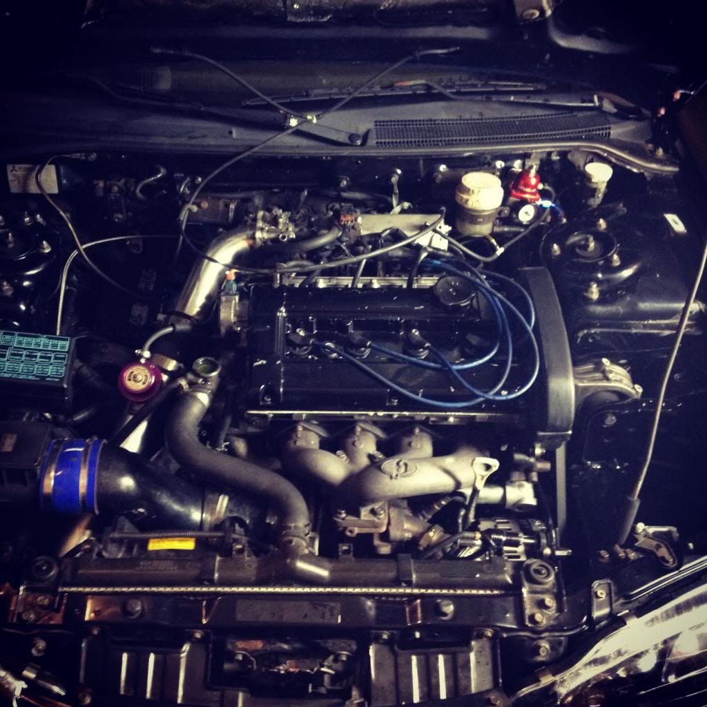

Just switched to Speed Density! It was a lot easier than I anticipated. I used the SD cable from ecmtuning and am glad I did! Here is a pic of the new setup (haven't mounted the MAP sensor yet and still need to tuck the cable)

Old 04-30-2014   #67
Re: 97 gsx build
Nice, I'm working on switching to SD as well.
The plugin cable is tits!
Old 04-30-2014   #68
97gsexx
97gsexx's Avatar
Join Date: Jun 2012
Location: Chanhappenin
Drives: 97 talon
Posts: 301
Re: 97 gsx build
Yeah it is, so worth the $40.
