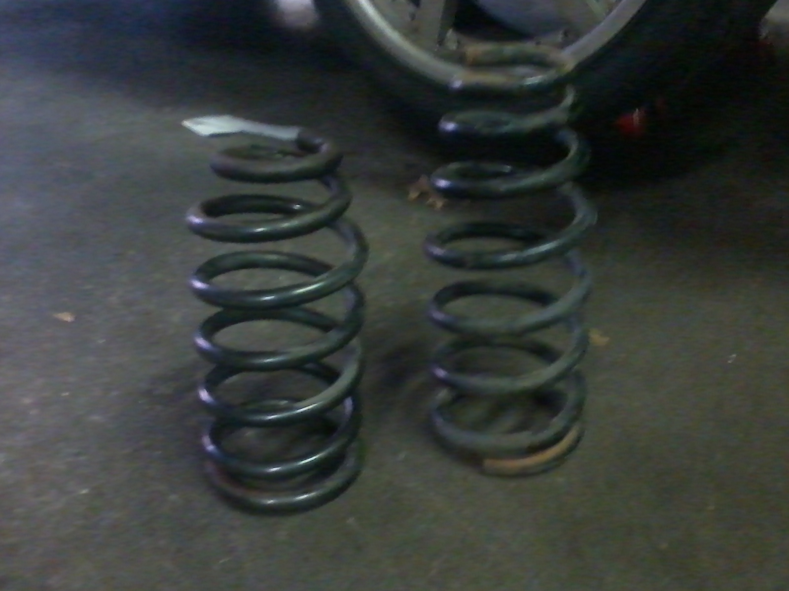

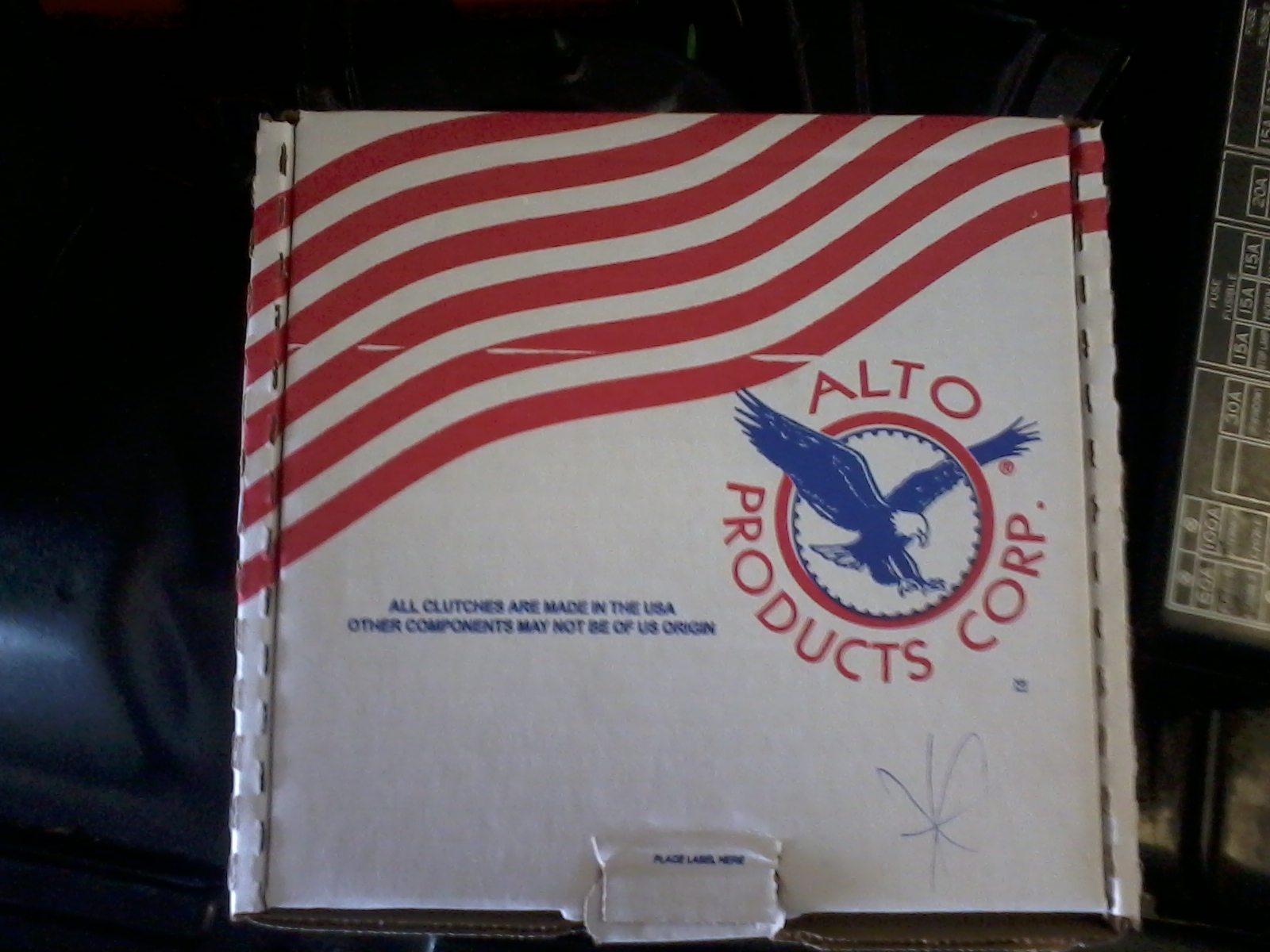

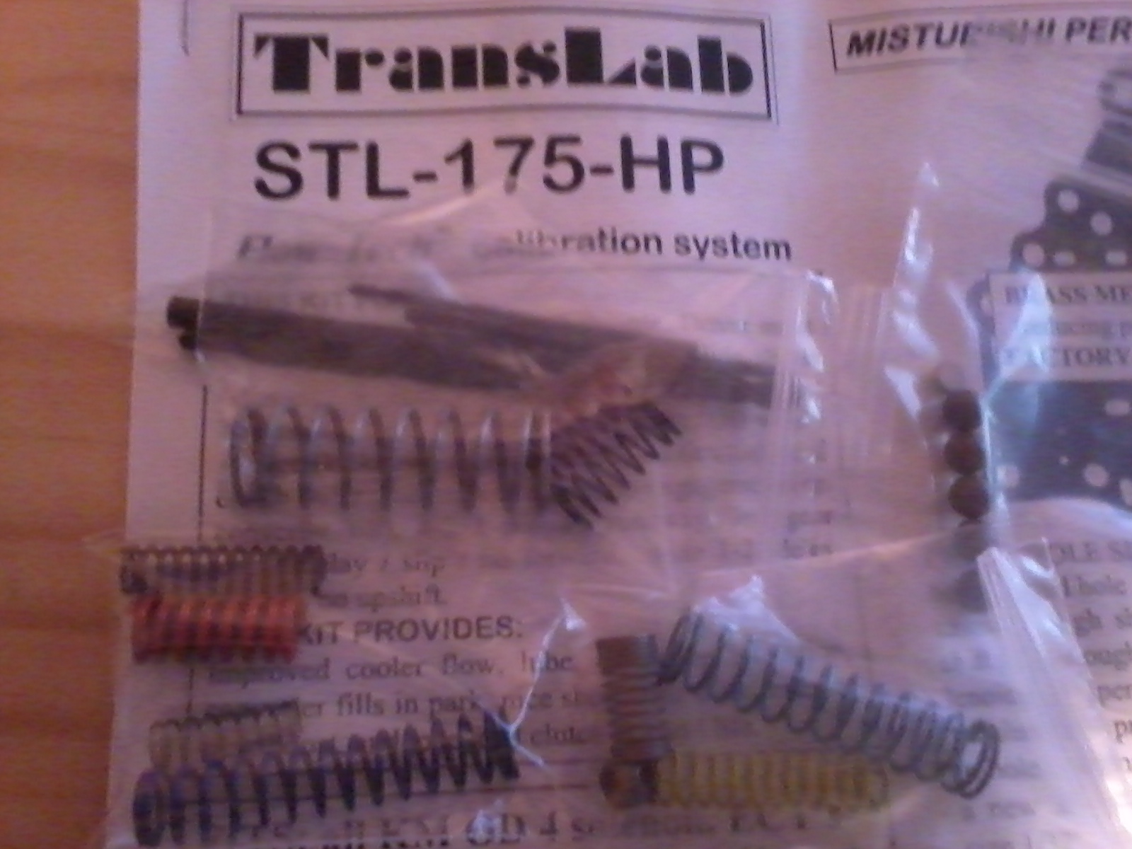

Since the last update Ive added
translab shift kit
ALTO red eagle end clutch
Eibach Pro Kit lowering springs
Tuned the car on E85 @ 30psi

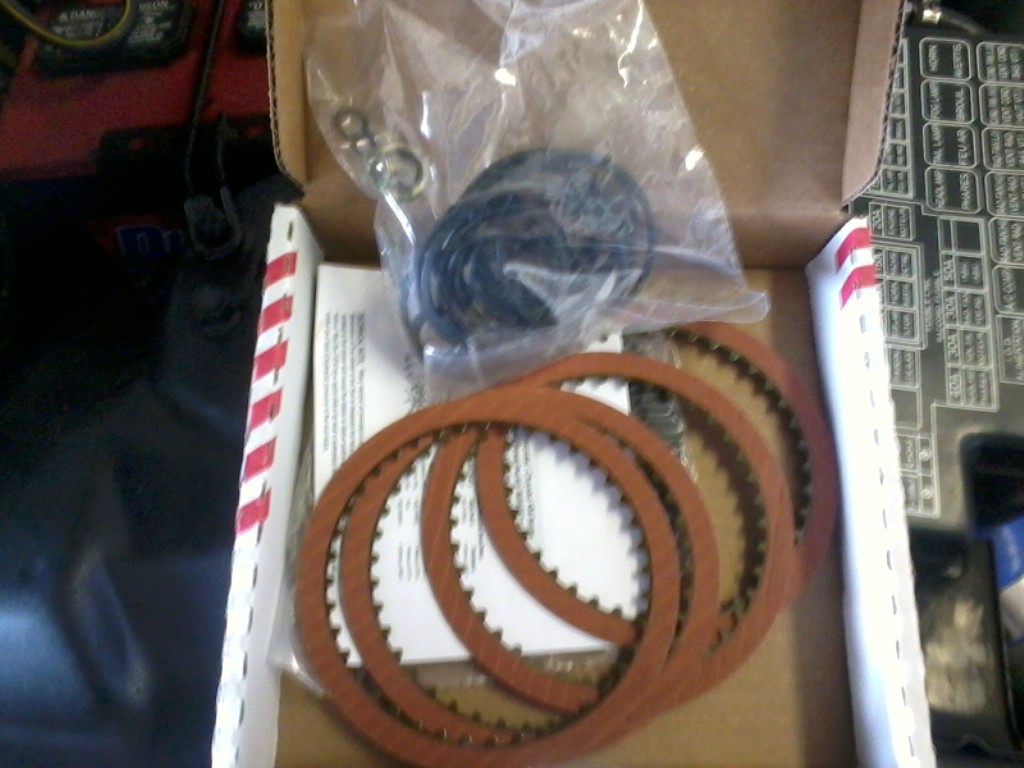

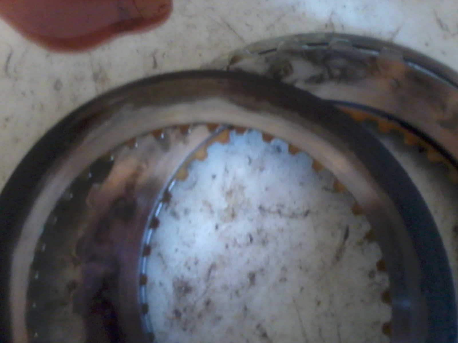

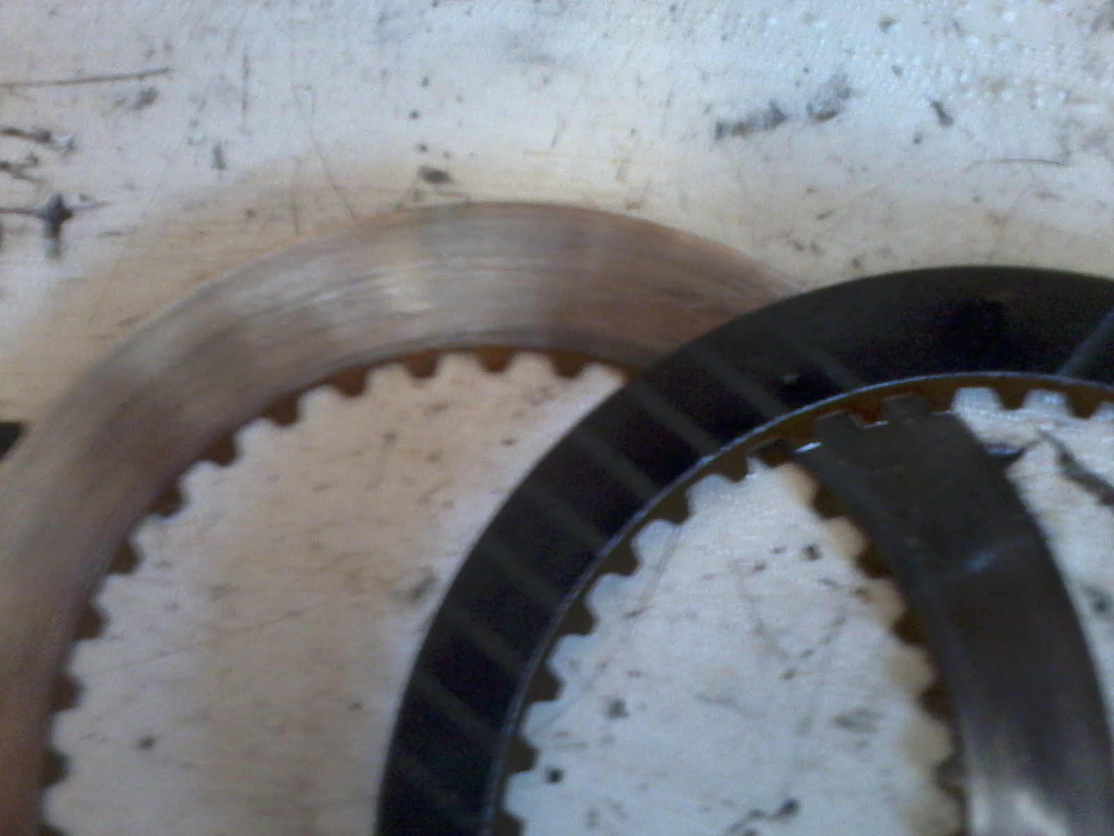

I Took my transmission apart today. I found pretty mutch what I exspected. The front clutch pack was totaly burnt out. So I will be ordering up a master rebuild kit, kickdown band, and Kiggly 5-friction front clutch kit tonight. I am still hopeing to get back to the track this season.
I have attached pics of the front clutch disks there is literaly no linieng left on it. 2nd pic is burnt disk comaired to a good one,
on a side note I rode in Swiftys car last weekend and HOLY SHIT! if that thing got traction it would be unreal.

I know Just waiting for a PM. Even if I bought that I would still do Kiggly front clutch after seeing this one.
