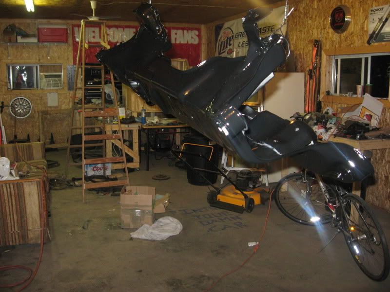

Haven't hardly gotten anything done in the past couple weeks. A truck w/ trailer merged into my parents while they were riding the bike home on the interstate so I've been busy helping them out while they're laid up. They're lucky their injuries were as "minor" as they were and they're recovering quickly.
Basically all I've done painted and mounted the rear subframe, I think it turned out pretty nice.

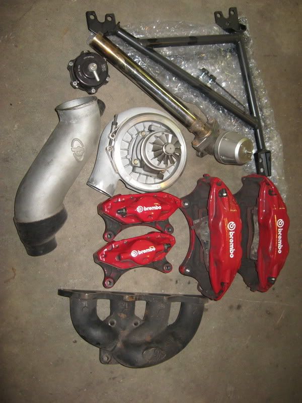

Also started cleaning out my garage to sell what I don't need. Had a couple parts I had forgotten about.
Just got the brembos a couple days ago. Freshly rebuilt holset wh1c, CompWorks fender braces, FP 4" intake/exhaust manifold, Tial BOV, Synapse Wastegate.
I need to speed shit up and put some of these parts to use!

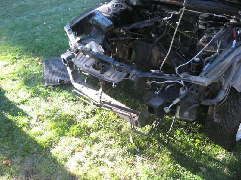

Got a little more done today. Front subframe is painted and ready to be bolted in, just got wait until I'm done painting the bay.
The front radiator support is pretty nasty/rusty on my car so you ran outside the parts car to cut that one off. I'm kinda starting to play with the idea of having this whole piece bolt into place. That way I could yank the radiator, intercooler, and everything off in one piece and then just slide the engine/trans out the front. Would cut the time of just about any major repair in half. So I'll probably mock it up on the parts car and if I like what I see hack into it and make it fit on my car.
