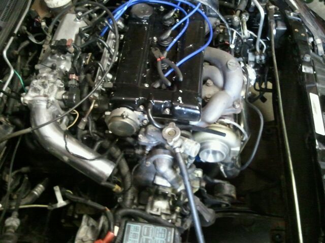

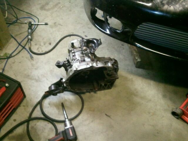

Here are a few pics of the process:

I will post some more pics up tomorrow of what I find when removing the trans. After I get her running I will be installing a 1g aluminum radiator with slim fans, delete a/c, and delete cruise control box and install non cruise cable.

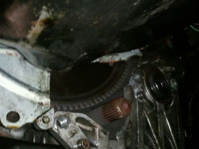

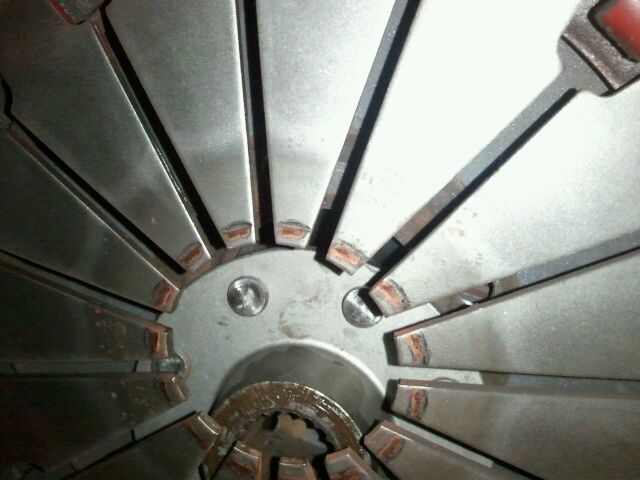

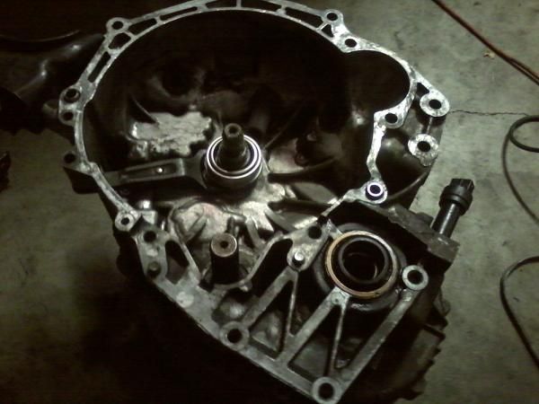

As I expected, the center of the disc separated from the rest of it. Here are some pics of what i found when I removed the tranny:
[IMG][/IMG]
[IMG][/IMG]
[IMG][/IMG]
[IMG][/IMG]

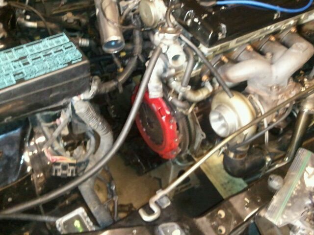

Does anyone know what pressure plate this is? It doesn't have and numbers on it or anything. I believe it is a 2600:
[IMG][/IMG]
[IMG][/IMG]
[IMG][/IMG]
There is a lot of build up inside then bell housing. Is this normal? I was just going to power wash it and remove as much as I can:
[IMG][/IMG]
Input shaft looks good, no damage from what I can see:
[IMG][/IMG]
Flywheel looks great as well. I am going to get it resurfaced just to be safe. I am going to buy a 2900 pp and street disc tonight. If all goes well, I should be able to make it to the cookout no prob!
97 gsx (sold)
97 talon tsi awd 🐼
Old 08-08-2013   #28
Re: 97 gsx build
That kind of buildup is normal on high mileage dsm's. It's just dust from the organic clutch disks over the years. So you don't know what brand that is at all? I would guess it may be a XTD (eBay) pressure plate. I would guess by the falling apart of the disk like that, the disk is probably an XTD as well.

There isn't any writing or anything on the pp. And yeah I was thinking XTD as well. The pp is still in really good shape but I am going to play it safe and go with a 2900 so I don't have to worry about it.

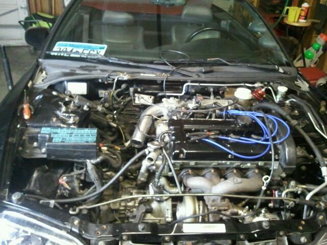

Well, unfortunately I didn't finish in time to make it to the cookout . Last night I got the car all back together and ran into some issues. Firstly, whenever I turn the key the left turn signal always flashes no matter what. The right turn signal doesn't come on, however both flash when I turn the hazards on. Also, when I attempt to start the car it doesn't even attempt to turn over. While the tranny was out I installed a black top cas and 6 bolt swap harness and I am wondering if that is hooked up wrong causing the car not to start.
I work until 1 today and during that time I am going to look up all the possible fixes for the issues I am having since I am on a computer all day. Today I start school as well, and fortunately for me the first part of the program is electrical 1 so perhaps I can get some advice from my instructors.
Other than that, the clutch pedal feels nice and firm and everything else looks good. I installed a full ss clutch line while I was in there. Also I relocated my boost & wb gauge from the a pillar to in the dash and will be installing my autometer oil pressure gauge in the cigarette lighter spot in the nest couple days. While the car was down I had Mark repaint my hood gloss black and it looks awesome! Just want to be able to drive it.... Here a few pics I have on my phone and will get some better quality ones up shortly.
[IMG][/IMG]

After doing some research I am almost positive that the end of my cas harness is plugged into the a/c connector and not the crank connector which would cause the car not to crank at all. Apparently both plugs are the same shape and look identical so I am hoping that's the problem.

Yeah that damn ac plug. If its plugged into that one that will definitely happen. Good way to tell is the length of the wires after they come out of the main harness/loom. The ac plug will be a lot longer since it needs to go low to plug in. Where the cas plug is shorter.
Hope that helps.
