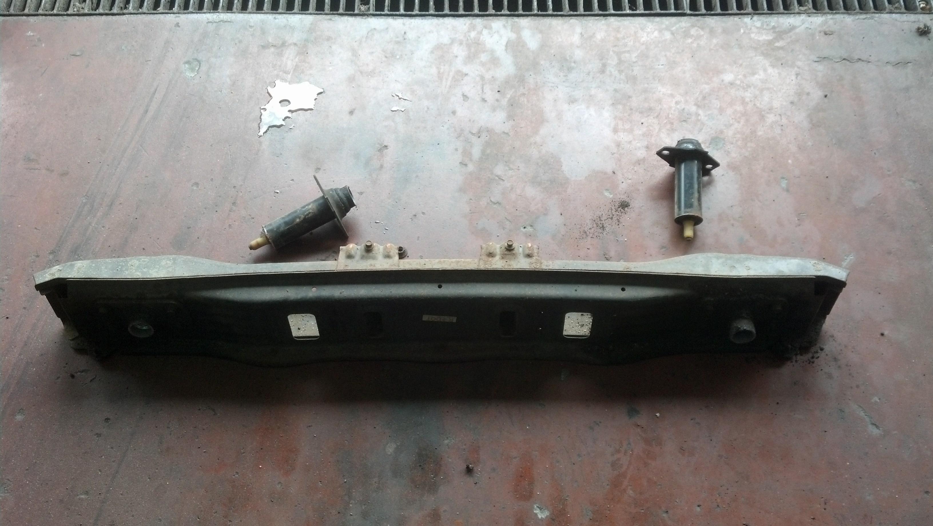

Well with the exception of losing my hood today was a relatively successful day. I replaced the control arm bushings, drained the oil, then hooked up our engine flush machine and flushed the sucker out so if there was any metal in any of the oil galleys there shouldn't be any more. I changed the oil filter, changed the inline filter for the turbo oil feed.
I put new plugs in it, shortened the coil boots, put bolts in places that were missing bolts, (fenders, t-case, flywheel inspection cover, etc) and just cleaned up as much stuff as I could.
Also I removed the rear crash bumper should be about 32lbs removed from the car. Which will bring my total weight savings since the got the car to around 47lbs.
