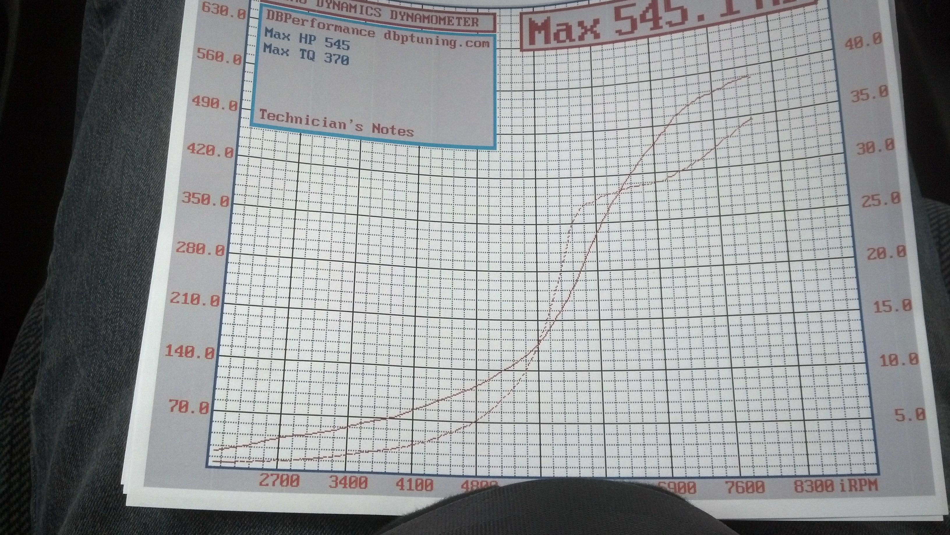

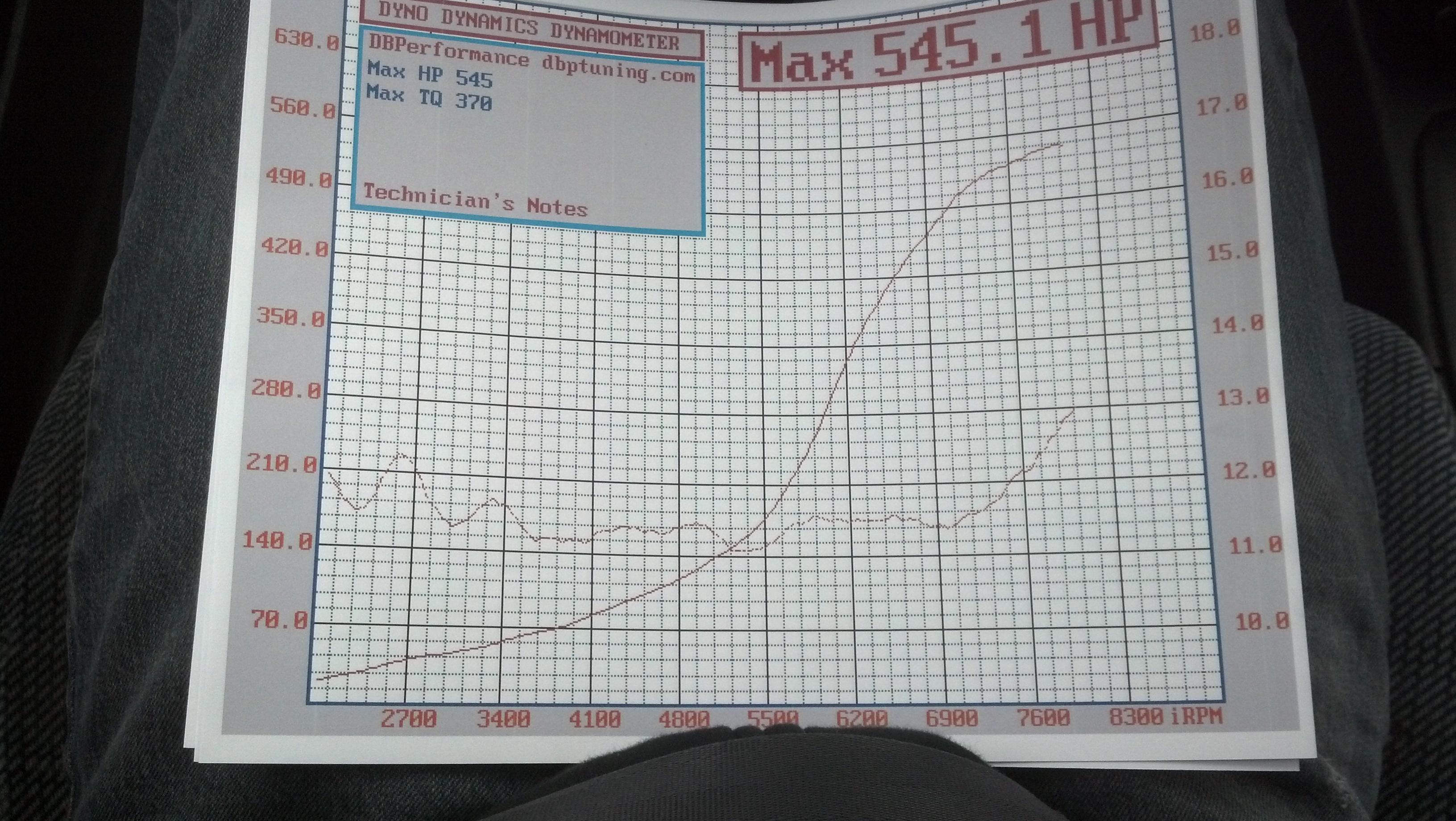

Okay so it was a little bit of a disappointing day. So i got some of the issues fixes from last year but we still having fuel pressure issues. We tried a couple things on the dyno and basically have it narrowed down to something in the tank. Weak pumps, ruptured line in the tank, etc.
We'll here are my graphs from today. It at least looks promising for when I get this fuel pressure issue fixed

If you don't find any issues with the lines, FPR, my vote is those ford gt pumps if you still have them.
Shane didn't think it was the regulator because pressure would start to spike then would drop off. He was leaning towards the pumps too. Either they are getting weak or they just can't handle the pressure under the amount of boost I'm running.
Old 04-22-2013   #320
Re: my new project
They don't like boost I think, well what I was running (30+)
