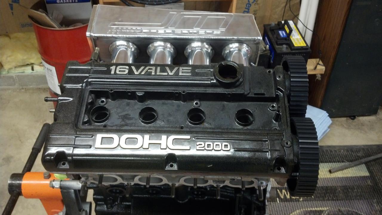

Re: Update on my 98 GSX build
Update!
Little update! Waited almost a month for bunch of oem parts to show up, Still waiting on my lower t-belt cover and o2housing to show up. Since then I've updated to a fp green turbo! 63mm TB(Done by throttlebodys.com) Got a few parts powder coated as well loved the way they turned out! And hopefully the rest of the parts show up middle of next week and get the engine in the car and hopefully get er running within 2weeks! Had to reschedule my tune date twice already >.<
Got the tune date set for May 28th now! I gotta make it this time!
