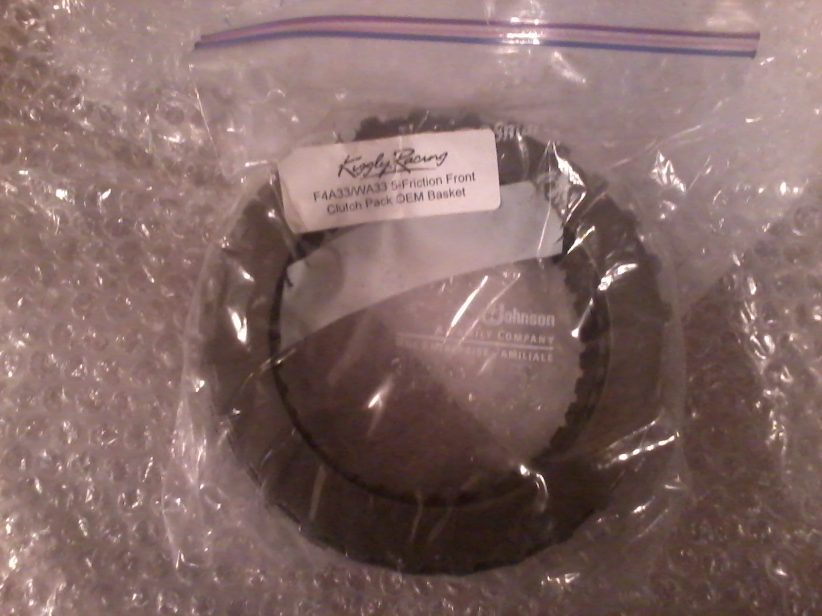

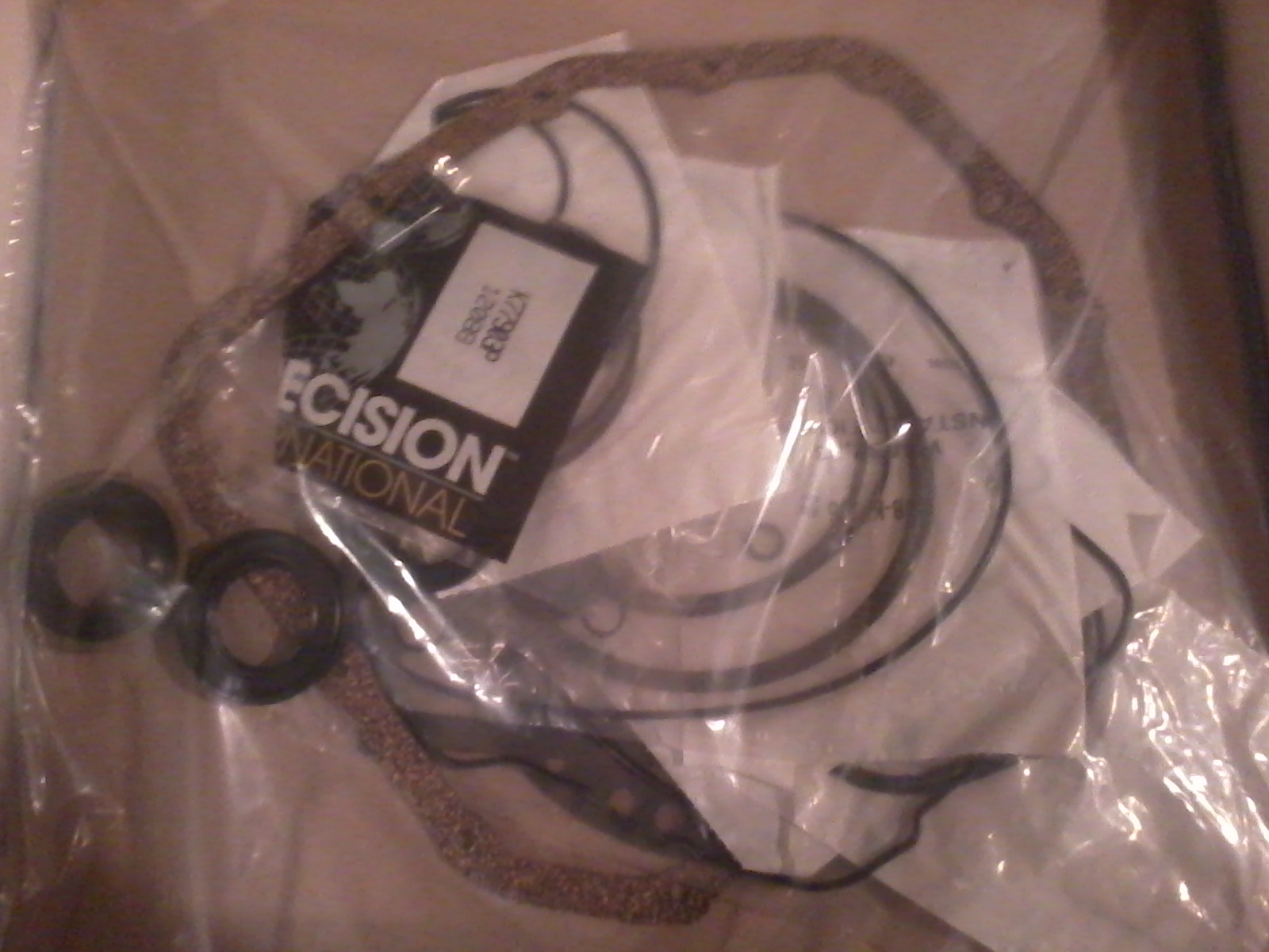

Master rebuild kit and Kiggly 5-friction front clutch showed up this week. I am planning on getting some work done on the transmission this week since I'm not working. I am still looking for a restalled 2g torque converter.

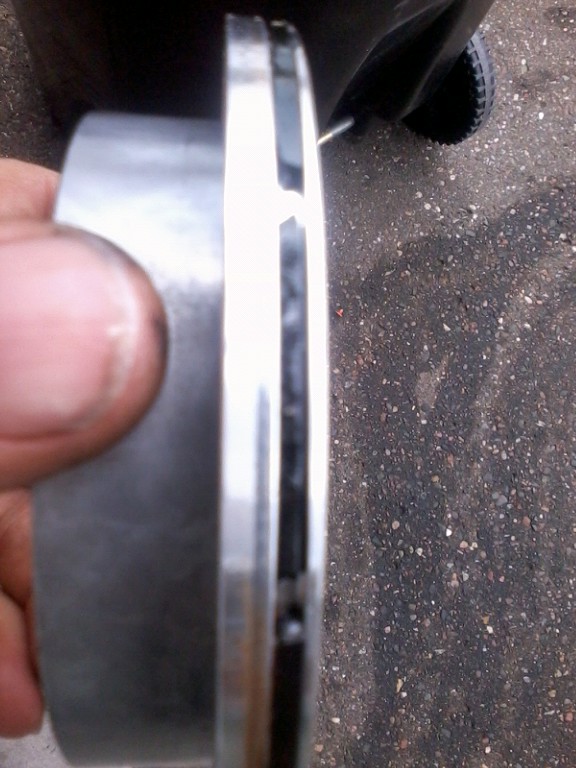

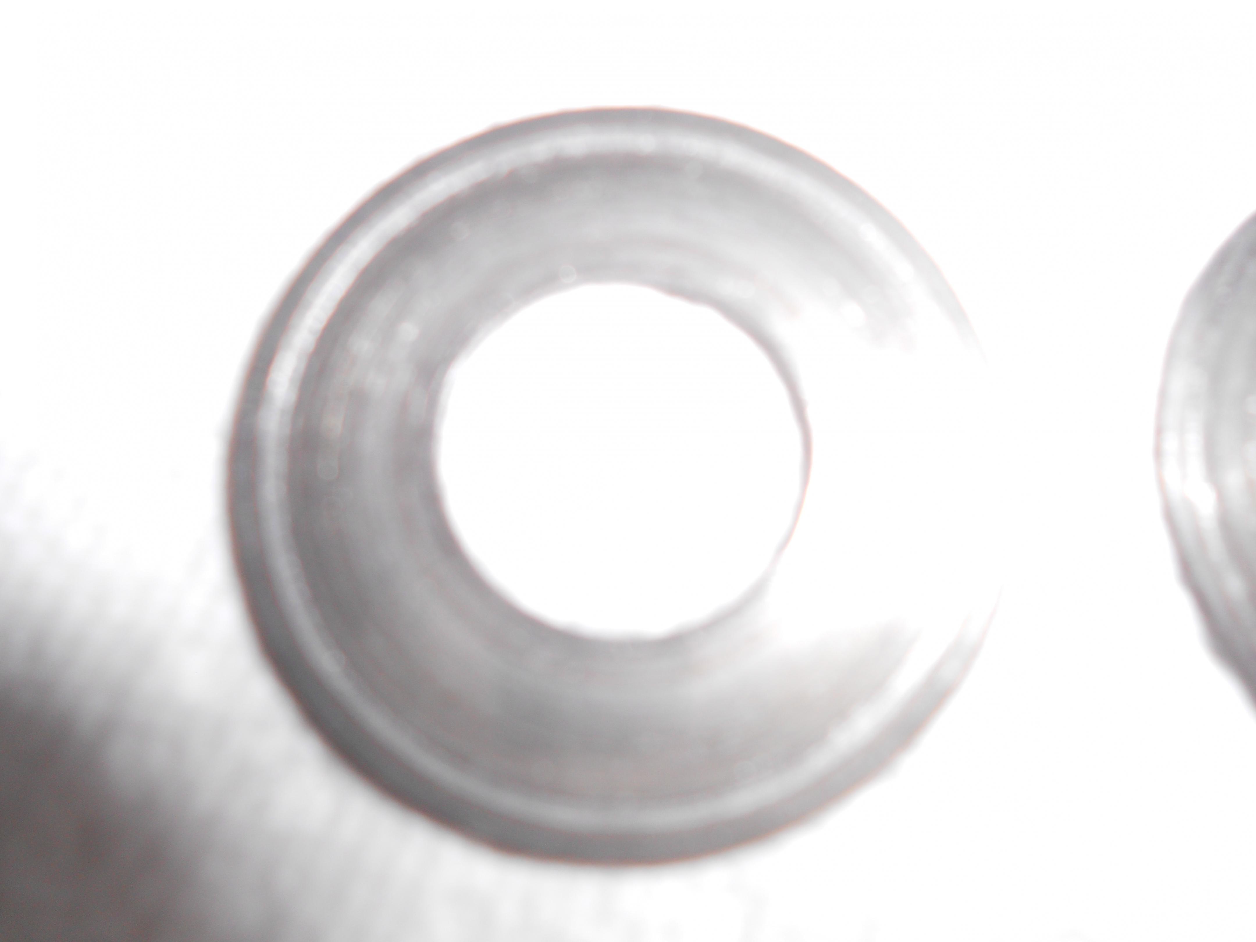

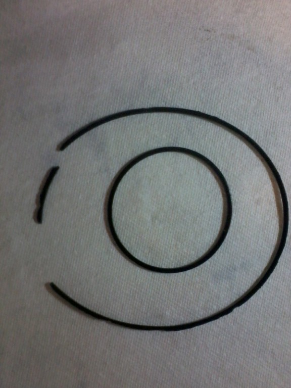

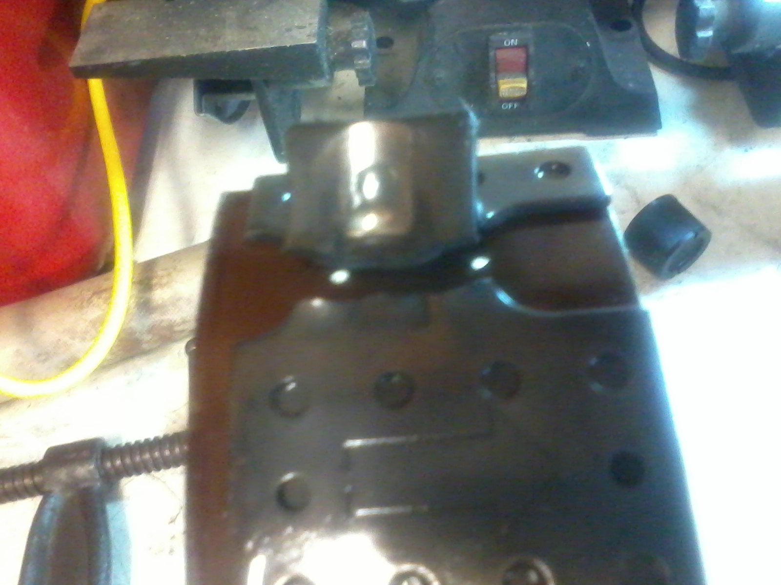

I did some work on the transmission today. I got all the clutch packs replaced and installed new seals on everything. I also found a broken seal on the front clutch apply piston. and a the Kickdown band was broken. Hopefully I have found all the issues and the cause of the burnt out front clutch pack.

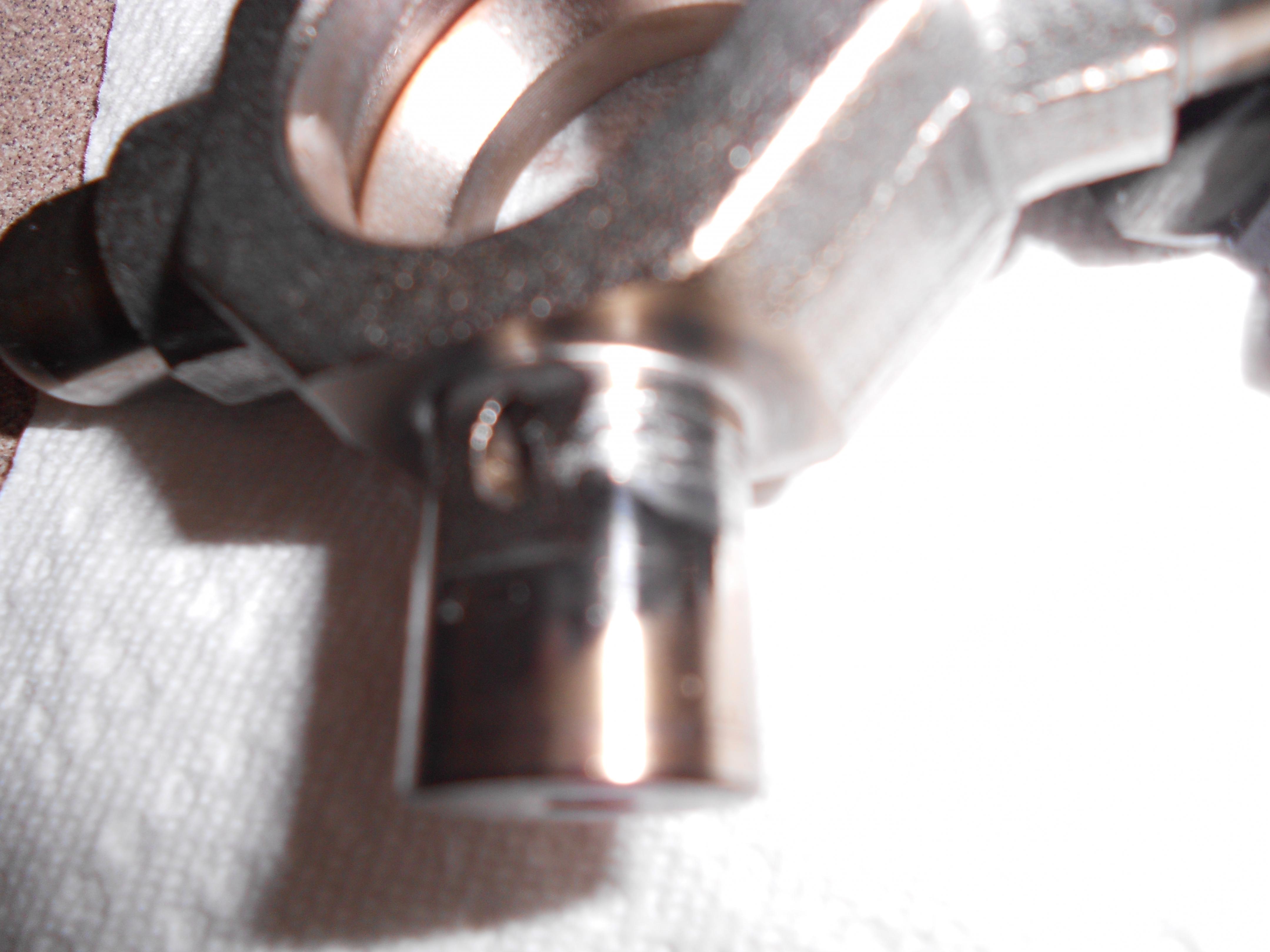

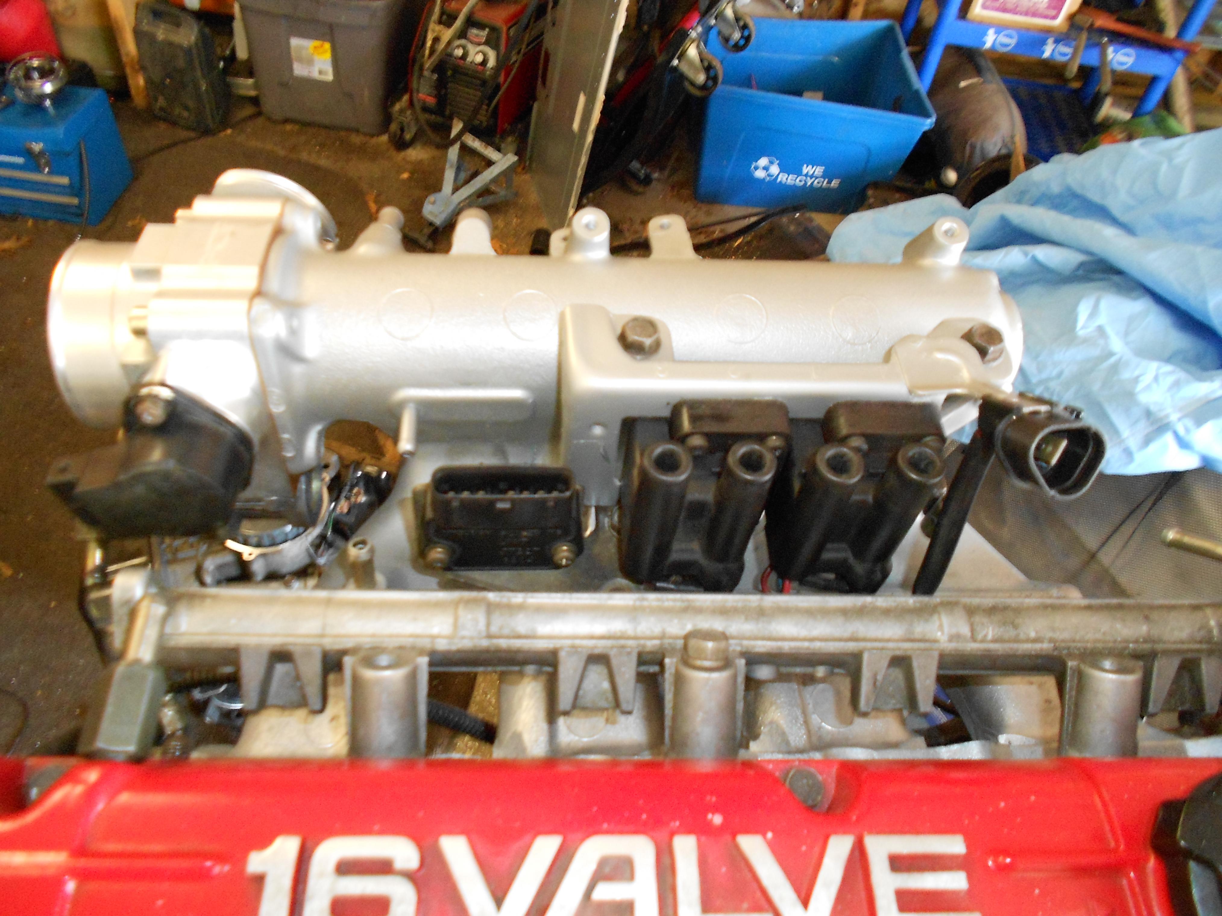

The transmission is mostly back together I'm just waiting on getting my center diff welded. I was on the fence about welding the center diff because I want to keep the car as "streetable" as posable. But after opening up the ceter diff and inspecting it I am definitly welding it. the gears shims and shafts all show sighns of wear so I think it was just a matter of time till it failed.
I also got my Evo 3 intake manifold and Ebay S90 throttle body installed. hopefully everything will be ready to put the motor/trans back in next weekend.

Sweet, another Evo3 mani. I'm more than loving mine.
