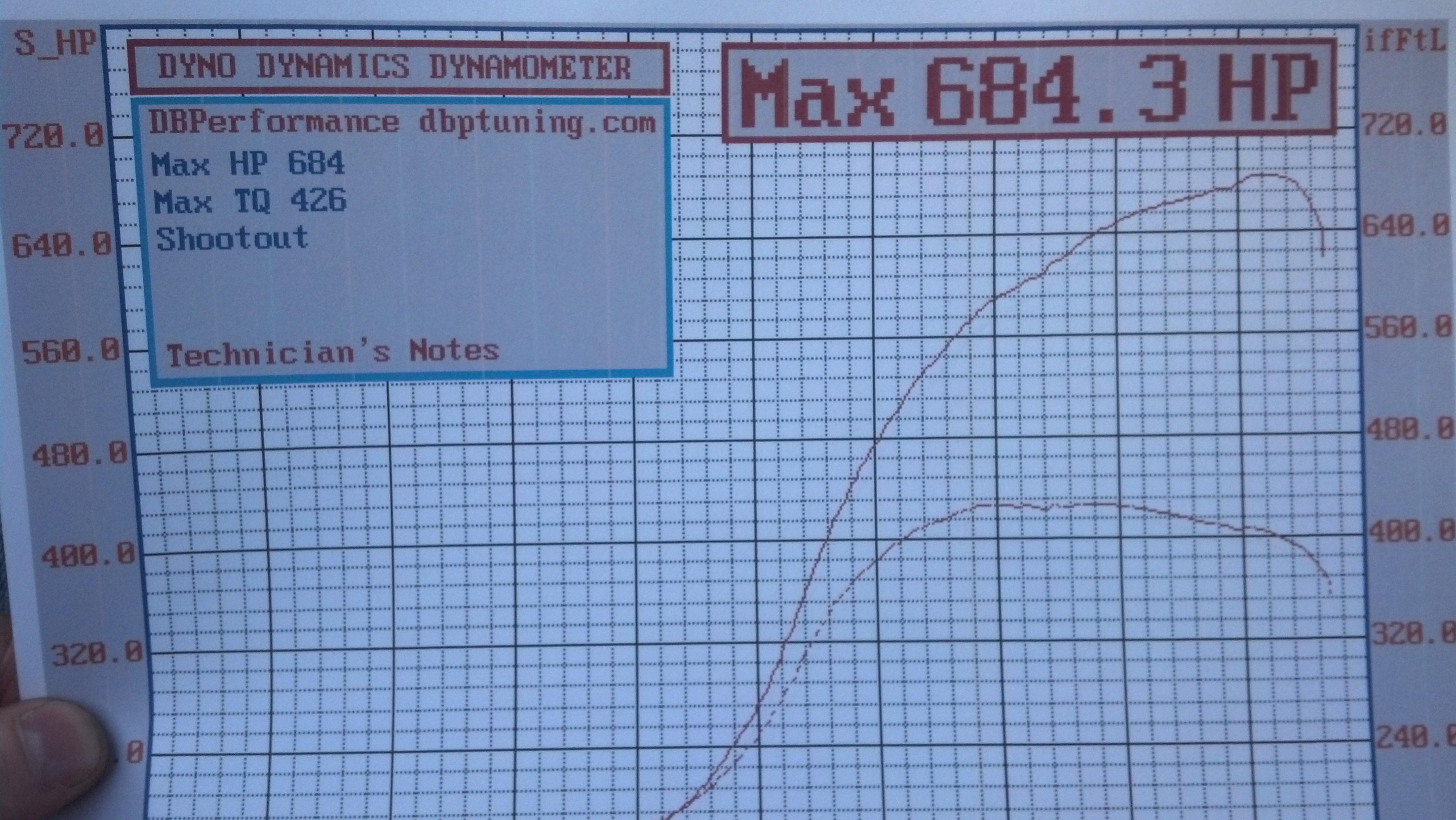

Aaaannndddd the never ending shitbox saga continues. More fuel pressure issues. We're kinda stumped. Thinking maybe it's in the tank. Idk if it's not a cheap/easy fix the car will probably sit until next year.
I might just completely redo the whole fuel system over the winter and go from there.
And a couple more crappy charts with dropping fuel pressure

That's pretty good! I'm sitting 586 on Shane's dyno or about 680 on a dynojet right now with fuel issues. I'd really like to see 700 at db. A 450 and bap would probably get me there on e85 but doubt it would be enough for e98 which I would like to switch to maybe next year.
