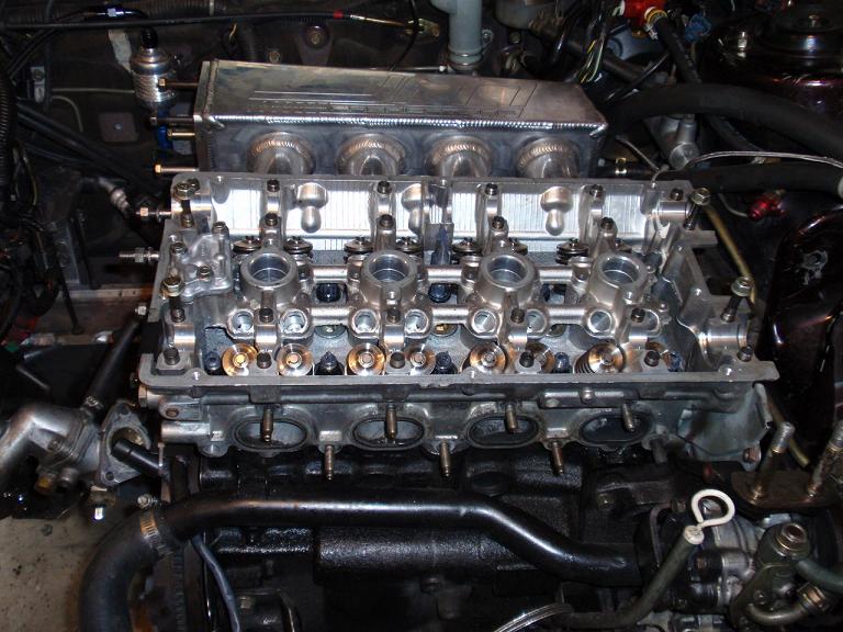

Got ahold of my uncle, and the head is done, so I picked her up and it's home now  Said everything on the head checked to be pretty good. The finish on the bottom of it wasn't all that nice so he decked the bottom of it. Has a real nice n clean finish on the bottom now. I'm pretty excited, it's getting to be time to start putting it all back together now!

Finished scraping off the top of the block with a razor. Nice and clean again!
Got the rods/pistons back in. Big thanks to Old Man Hill for letting me borrow his piston ring compressor tool, it worked perfectly. Torqued the rod bolts to 45lb/ft w/ ARP Moly Lube. Retorqued them 5 times because that's what I read to do on another forum.
Scraped the RTV gasket off the bottom of the block. Got a majority of it scraped off the oil pan.
Got the new L19's screwed into the block, and slid the new head gasket on over them.
Decided that's enough for one night. Tomorrow I plan on finishing cleaning all the gasket off the oil pan, then reinstalling it. Then start to bolt the manifolds back on the head. And then get the head set back down on top of the block.

I took a couple days off as I was researching cobra brakes.
So started back on her today. Oil pan is on. Head is on but not torqued. Got a new axle, thanks to Shane for getting me a good core.
Taking a break here but will be heading back out to torque the head down. Just going to research to see if you're supposed to torque L19's to a different value.
Then start working on putting the cams back in. Maybe get to the timing belt tonight, otherwise I'll just save that for tomorrow.
06-12-2009
#94
Re: Over revving issue
Got the head torqued on. I decided on 95lb/ft.
Got the cams in and torqed, kinda. I've tried to be real particular about placing everything into seperate plastic bags, but apparently I still managed to lose a singe cam cap bolt. If anyone has one, let me know.
Timing belt is on. Also put in a new tensioner pulley as well while I was in there.
Also picked up a new axle today. Thanks to Shane for hooking me up with an exchangable core.
That's it for today. Will continue on with some more tomorrow.

I've been working on it a little today. Got the accessory belts on, but left the A/C off for now as I don't even have a belt for that at the moment. Got the valve cover on. Most the electrical crap plugged in. Motor mount back in. Vacuum lines hooked up under the IM. Double checked that the oil pan bolts were still nice and snug.
Started to install the new Arc-2 Unit. I may just leave it installed but disconnected for a little bit though, just so I'm not doing too much at once here.
Also cleaned up all the grease that's all over the wheel well where the axle broke.
