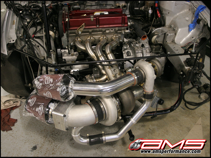

Never seen a setup like this. Very interesting.

That was what they were using for their 1000hp on 100oct contest entry. They ended up ditching the twin-turbo setup at the last minute and going single due to time constraints. Looked sorta promising though.

the turbo setup looks bigger than the motor itself. holy balls!

Holy shit that's a big turbo.

Crazy sequential turbo setup! It looks like they were going to use gates to route the exhaust after the big turbo spooled, as well as one in the intake of the big turbo so they could pressurize it. Pretty crazy idea and great execution, too bad they didn't pursue it further.

that looks crazier than the supercharger+turbo setup someone did a while back. Did they ever start trying to tune it or did they scrap it before that?

ams also killed everyone in that competition. 517hp per liter!

Sick, been a lot of talk of sequential turbos lately in the dsm world

So were they trying for more low end? Or would it have run more like a staged turbo setup to get more boost out of the big turbo? Nice fab work as always.

It's sequential, smaller turbo to help spool up the bigger turbo. Which in their case was needed. haha

I would love to see a sequenchal setup on a DSM i think it would be new ground. Hell maybe in 2020 putting a sequenchal setup will be the new 16g

the competititon judged also on powerband. so that was why martin thoight to do the sequential. but money and time to develop didnt allow that to work. so a single 4202 was used with no backpressure bein the name of the game.
