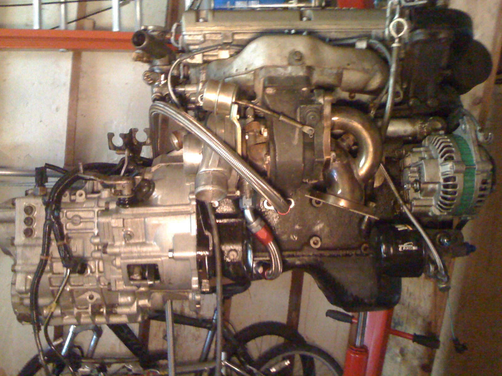

From everywhere. JK the whole engine/transmission was coated with gunk and grime, i just finished cleaning the whole assy up today, see attached pic. it was black when i started this. and I have added a bottle of dye to trace any leaks WHEN they surface
Originally Posted by Pushit2.0 View Post
The idea of venting more crank case pressure is good, but I do not see it as needed in this case, the valve cover is a little easy to drill into. Who did the machine work and assemble on the motor again?
I am in no way suggesting that everyone do this, just i think this is going to be a fun experiment.
John Gosh is a well rounded machinist, not some legend of 4g63 building, thats Rick Shindly.
True, but i learned everything I know about DSMs through rick, back when he was working on DSMs (is he still doing this?)
therefore, I am as crazy as rick.
Also, if John Gosh looks at a block, feels the metal, and says "there should be no problem with block strength if you drill a hole right....there" I am going to believe him over what anyone else here says. DSM pro or not

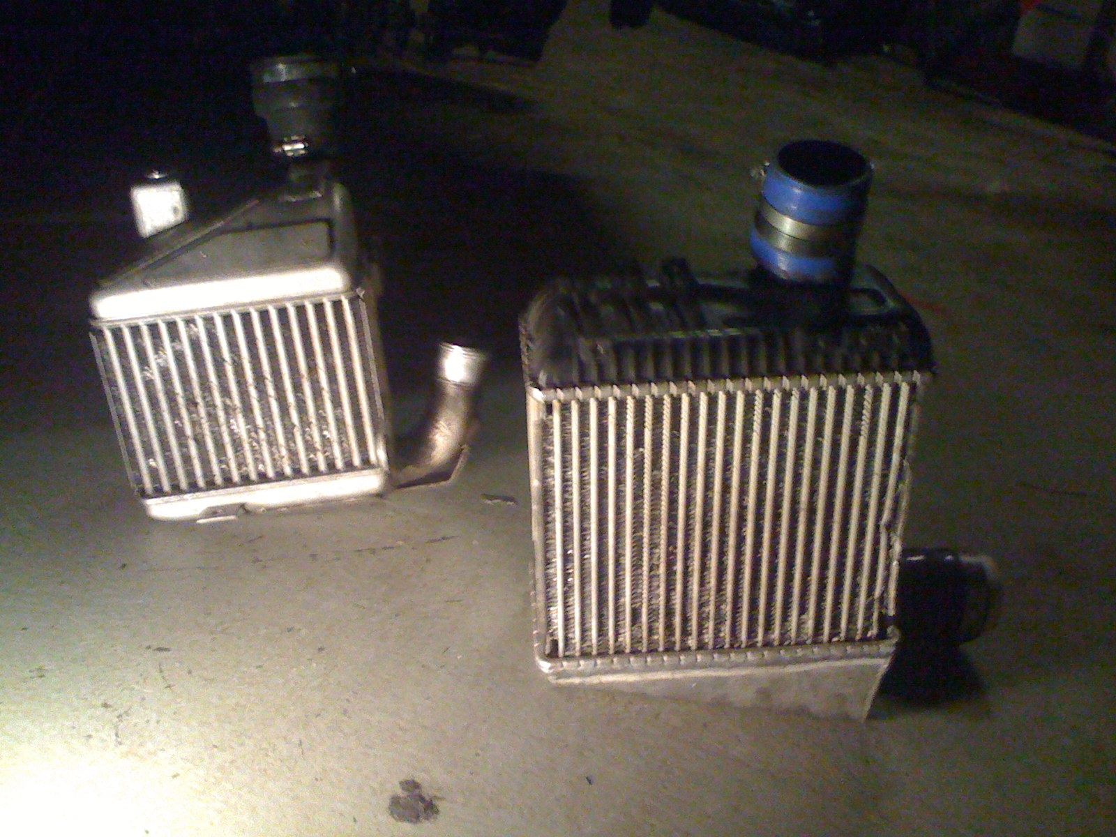

Project update: got motor installed, it was a total bitch with that stock ABS. I had that engine at such a messed up angle to get it in there! I hope i never have to do that swap again!
Pictures are of my intercooler piping and my supra sidemount. I know that it is really old school, but who cares? it was free!
I really want a FMIC, but im saving up for a house and I just cant budged it in right now.
