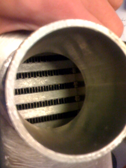

Got the intercooler and pipes yesterday, this thing is huge! It nearly takes up two couch cushions with the endtanks.
It appears to be a legit spearco 2-216 core, the pipes are very nice as well (no dings or anything), and I got a complete set of multi layer silicon couplers with tbolt clamps. Very happy with my purchase, the extra 4" wide should look sweet when it's installed.
