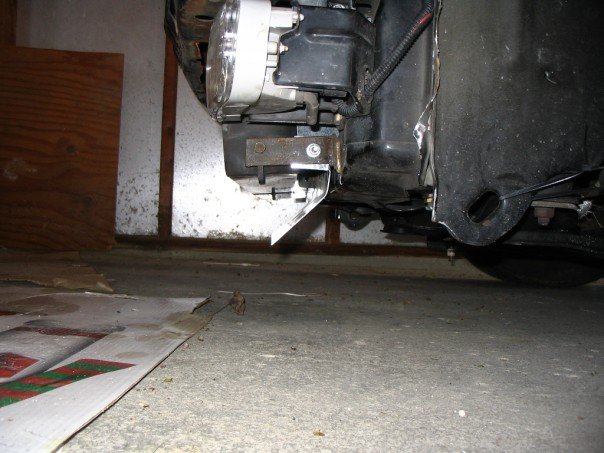

You could try building a sheet metal air scoop under the radiator to direct cooler air twards the radiator. This way the radiator won't only be getting air thats been pre warmed by the IC and AC core
I dont think the 1g dsm link version has the coolant off-set. The fans on a 1g arnt controled by the ECU.
ID:	5844   Click image for larger version

^^ Ahh Very nice idea! I think I will try that with the scraps I got laying around. Any clearance issues carltalon?
