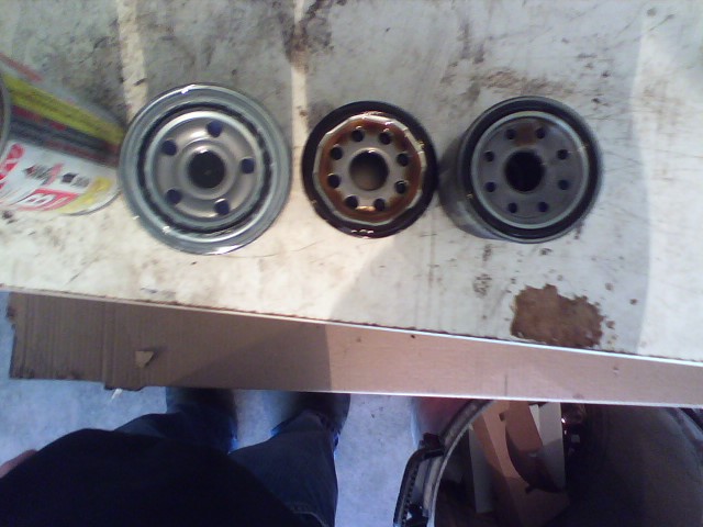

Just thought I'd quick share this info. Hell it may be common knowledge for some here, but today is the first I've ever heard of it.
Apparently the filters that came stock on the 2004 RX-8's and a few other Mazda's (miata, 323) will fit onto our cars. They are supposed to be significantly smaller then any of the Mitsu filters, and may be helpful for those who need a little extra clearance in that area. Next time I'm in town and at the store, I'll have to check it out and maybe snap a quick comparison picture of it next to our typical mitsu filters.
Anyhow, here's some part numbers for anyone else who is in need of the smallest filter possible for space saving purposes:
Napa - 91365
Napa Gold - 1365
Wix - 51365
Fram - PH6607
From what I gather, all of those EXCEPT THE FRAM have the internal anti-drawback valve in them as well. Another big thumbs down to the ugly orange filter. But I know some people still prefer Fram for whatever personal reasons, so I threw their part number up there anyway.
