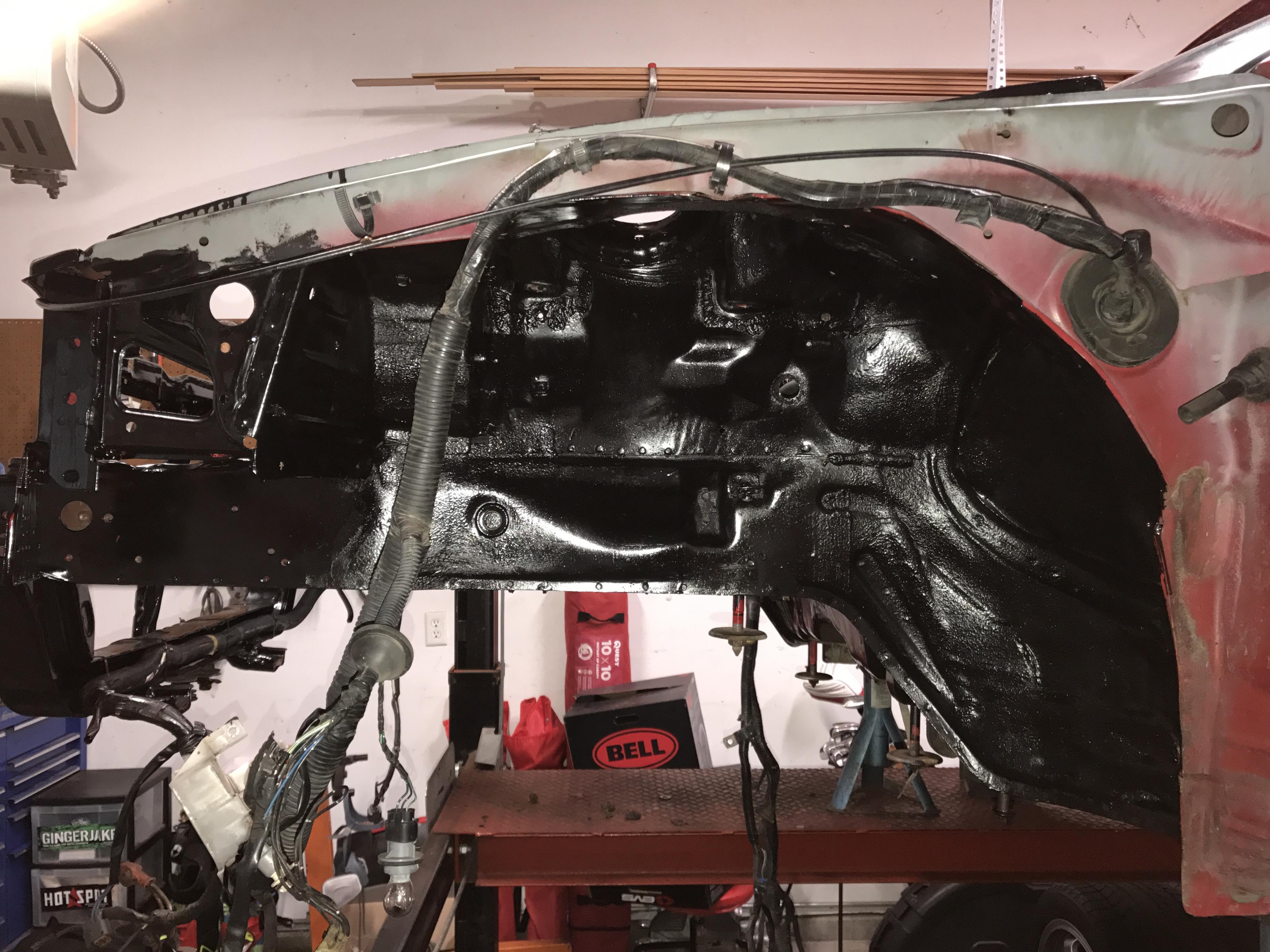

Here we go again on another build thread. This is the girlfriends build and car that I am documenting since she is not on here. Little history on the shell we picked up, originally from Michigan and is rust free with a full cage. The car itself has been sitting for who knows how long and has not been touched really untill we got ahold of it, had no interior and was basically stripped. So far here is what we have done: Stripped engine bay, sanded and resealed then painted, subframes have been sand blasted then powdercoated with solid bushings installed, all new suspension parts with almost all bolts, wheel wells undercoated with por15, full interior installed, and a ton more work. As for a mod list here it is and it will change as time goes on but as for now she is going to run this setup and see what we can do with it.
