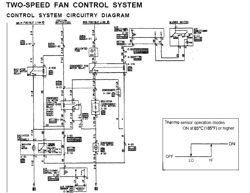

The fan switch is on the lower corner of the radiator itself, it should turn the fan on at 185 F

You can test the sensor with some boiling water and a multimeter.It should read around 0 ohms at ~185 F and higher.You can test the rest of the circuit by shorting together the 2 wires going to the sensor.When shorted together, the fan should turn on

For future reference.
