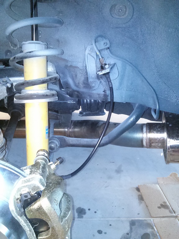

Got some black coated SS Brake Lines. Also hoping to hit the dyno here in a couple weeks for some WOT stuff

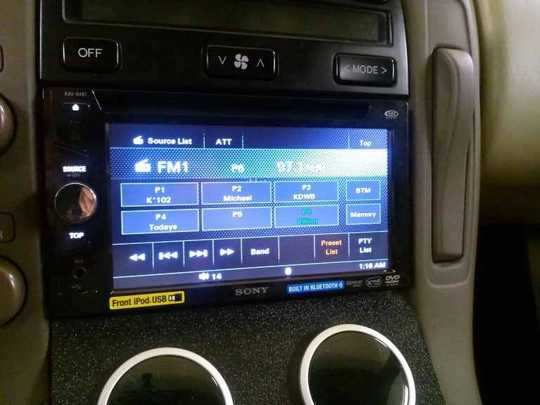

First, I feel like the sound quality coming from the China head unit left a bit to be desired. The aux input plug was becoming intermittent, and the bluetooth streaming was just horrendous, it's like it only streamed treble. So, I picked up a new Sony unit off Amazon for $150. It doesn't have GPS but I never really used that anyway, just use my phone. It does do DVD though, has aux in, USB in, and bluetooth which included a mic. So that is installed, and man everything sounds so much better. So if anyone wants a china unit, I have one up for bid lol.

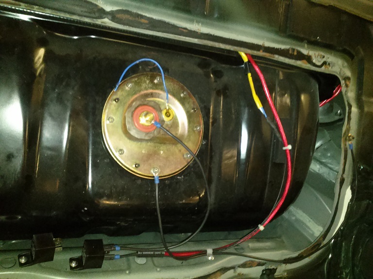

Also, I had my twin 255's installed but still on stock wiring. So I picked up some relays and did a rewire. I bought a bulkhead stud connector off Summit that seems to work good for passing the power through the tank lid rather than connecting it back to the stock small wiring for passing through that which seems kind of like a waste to go through all that just to have it connect back down to a tiny wire at the end. Can immediately tell they are louder than they used to be. I mounted both relays so I'd have an installed spare in case the one dies. I've never had one die on me before but I've read several stories of relay failures so I figured for how cheap they are why not have one in there ready to rock just in case.
