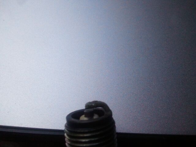

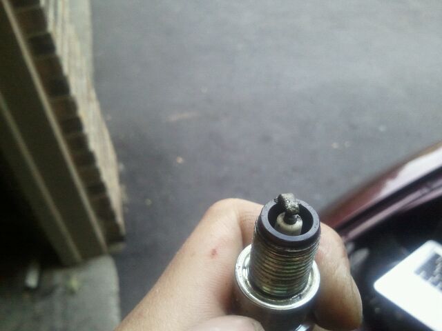

Well on my way home from work my car started to sound like a Subaru and lost all power. Pulled into a BP and it died and wouldn't start again. Got it towed home and pulled the plugs and #3 looked like sh*t.
It's greenish in color and looks like it has a tack weld on it/ melted electrode.

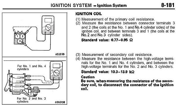

Coil pack tested good the primary ignition coil in the diagram tested at 1.01 ohms so it's a little high, says 0.77-0.95 ohms.

Compression test tonight. #3 was the plug that was messed up but the misfire seemed to be coming from #1
No smoke or anything.

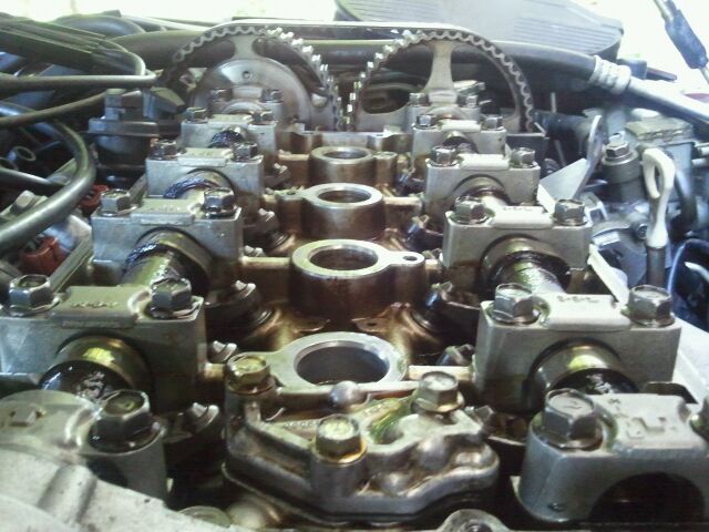

Well all the rockers are still in place. Coolant level is still good and no oil is mixed in and vise versa. During the test it cranked over way faster than all the other cylinders, just because no compression i'm guessing.

With zero compression I'm going to guess a bent valve. Any broken springs? At this point you pretty much have to take off the head anyway.
Old 08-16-2013   #16
mark4g63t
mark4g63t's Avatar
Join Date: Jun 2012
Location: Twin Cities
Drives: 95 Talon TSI
Posts: 941
Re: 3/4 cylinders
No broken springs from what I saw at a quick glance.
