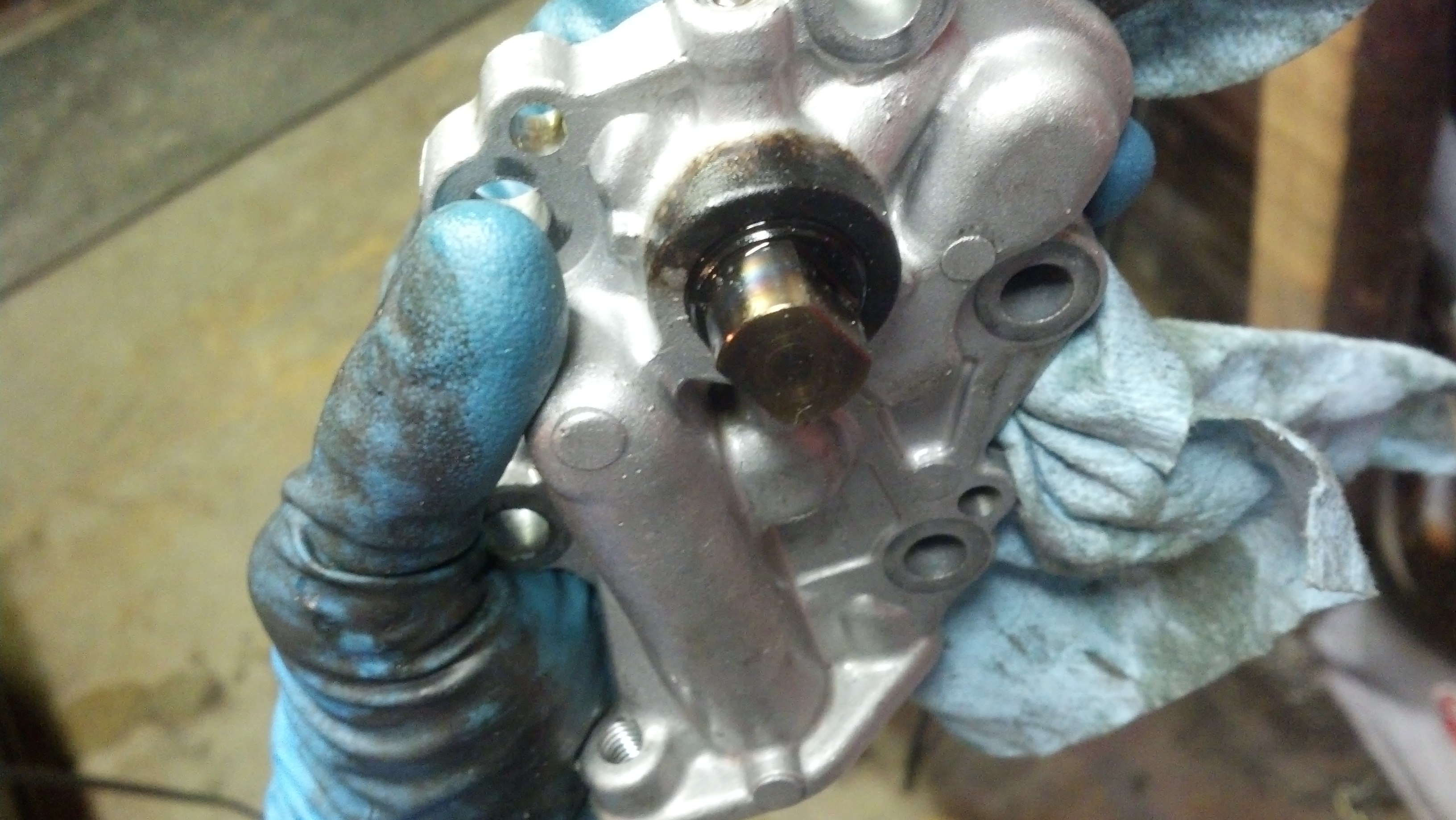

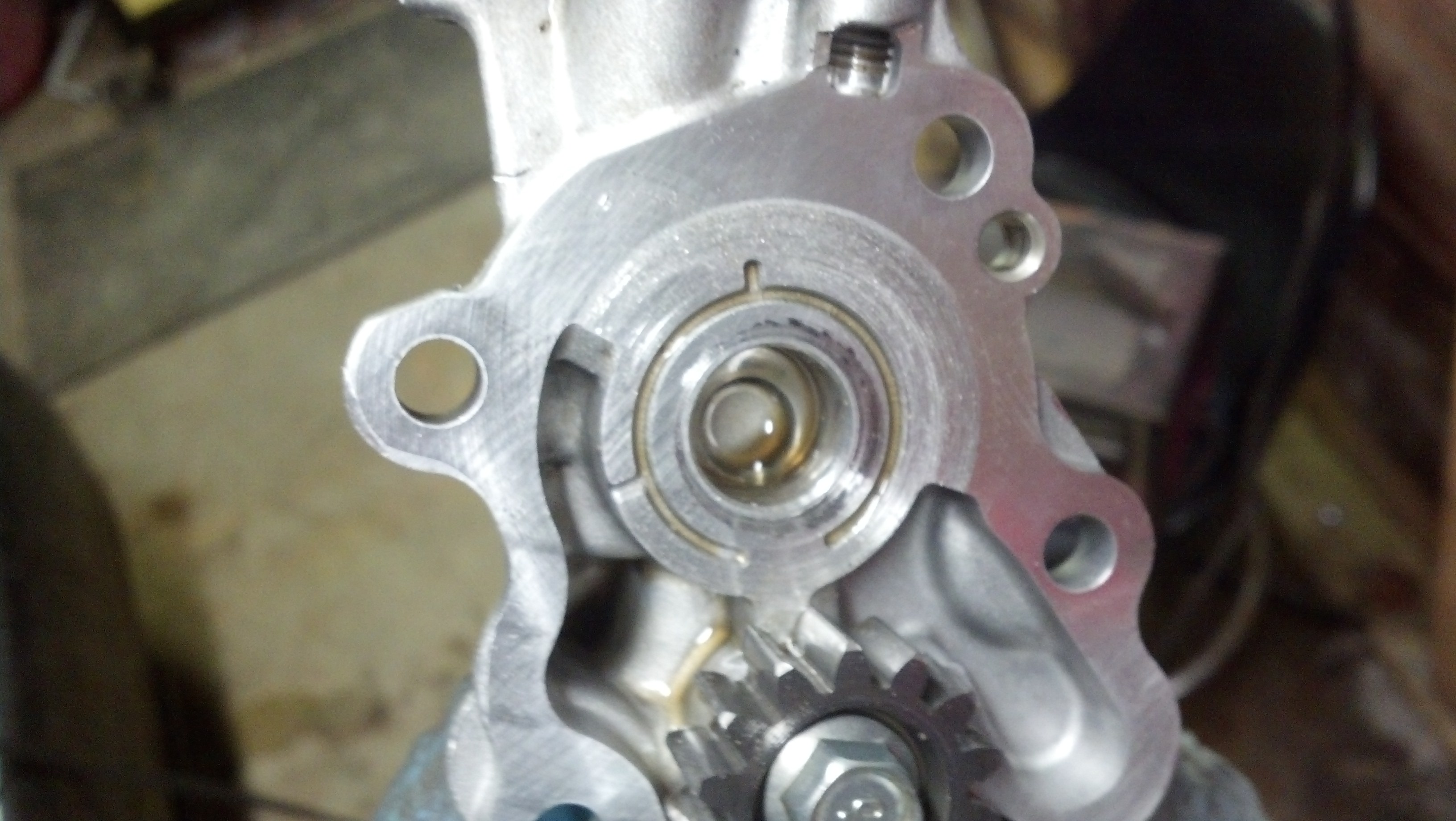

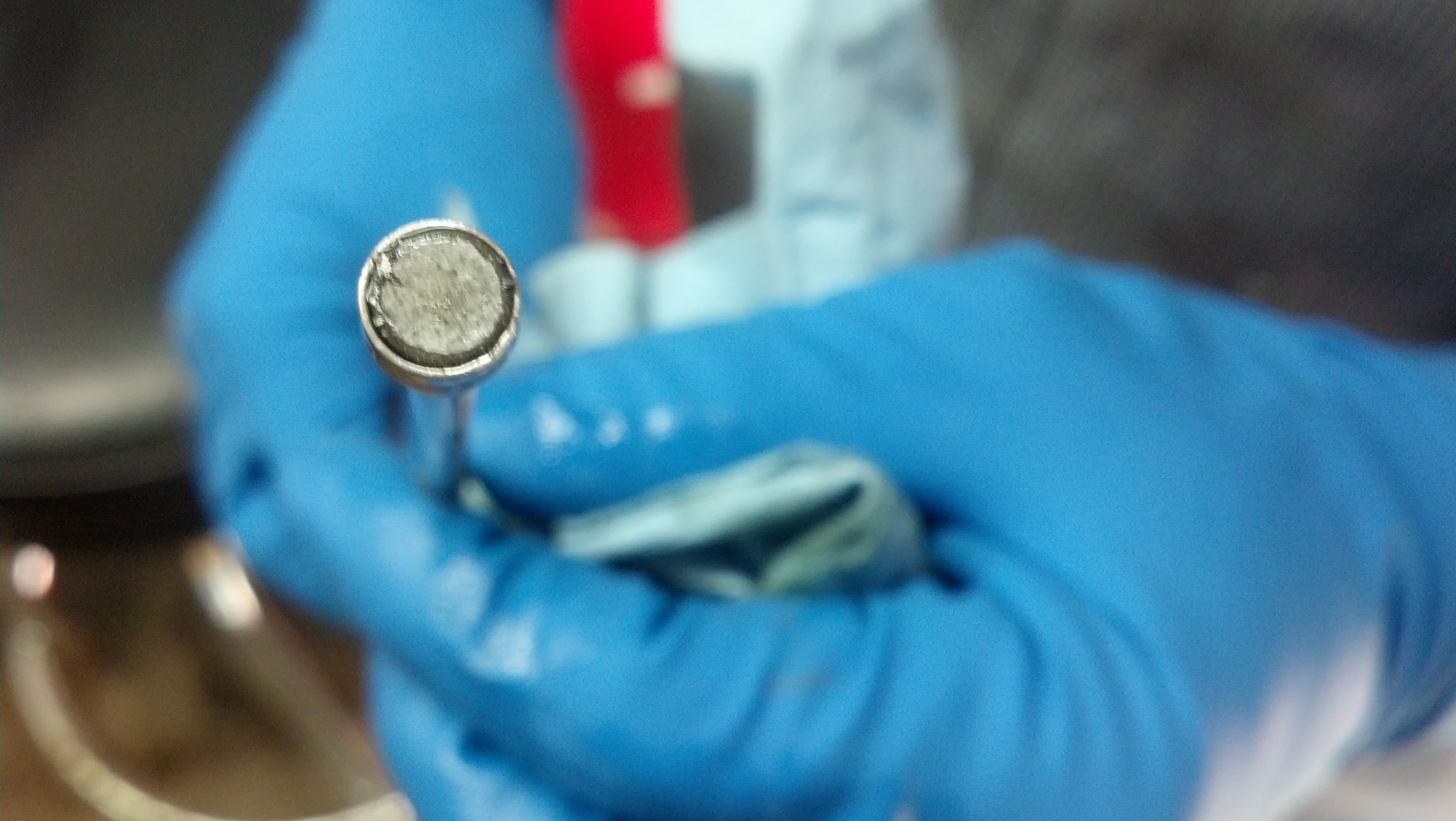

So last weekend I pulled the oil pump. I found that it appears that the stub shaft locked up causing the oil pump to lock up. There was some metal in the oil but it was very minimal. I'm going to try and get the 1st rod and main cap pulled tonight to double check the bearings.
If the bearings are good the plan will be to replace the oil pump and put a new oem timing belt on and do a compression test and leak down test to see how the valves are doing.

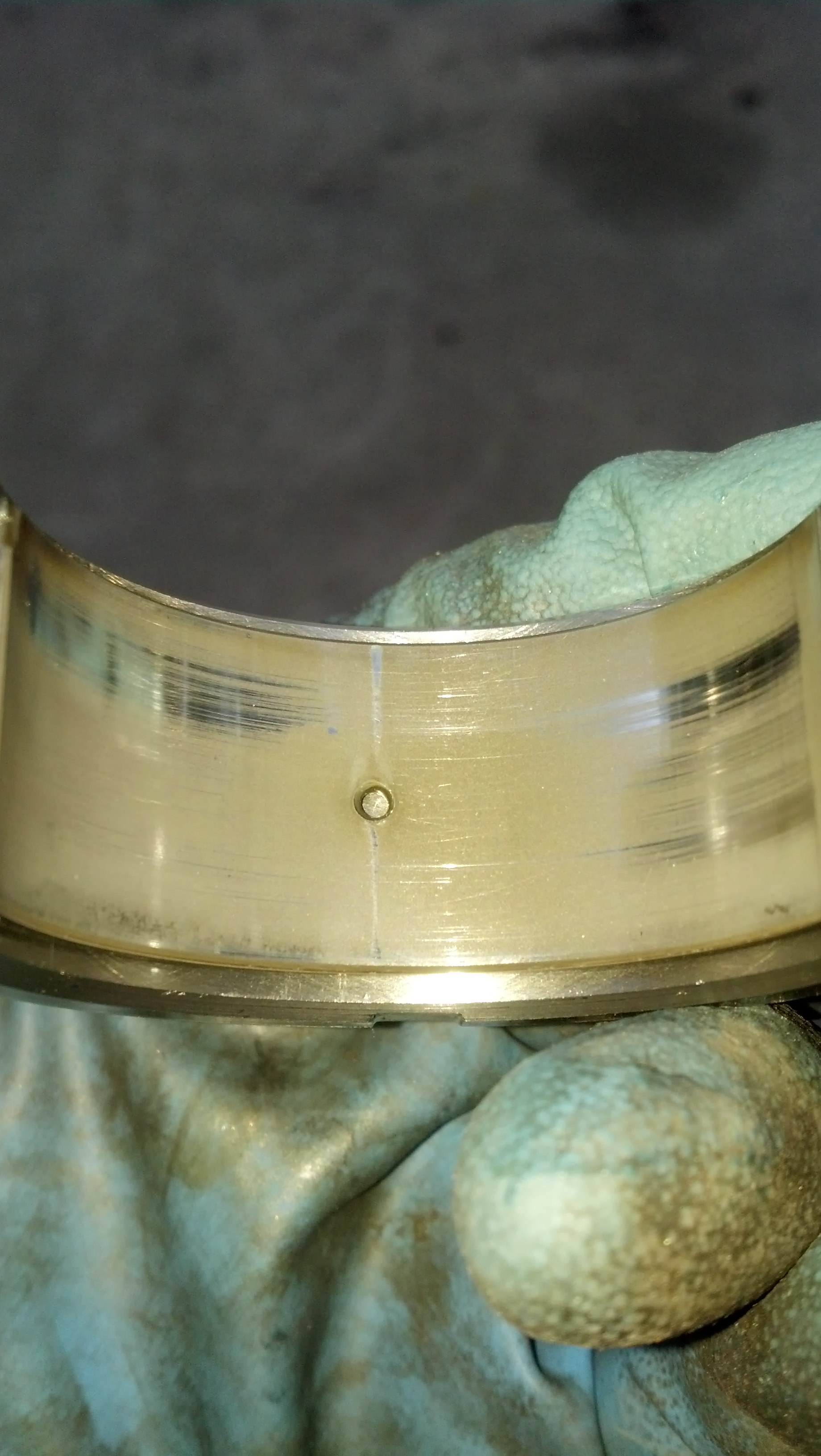

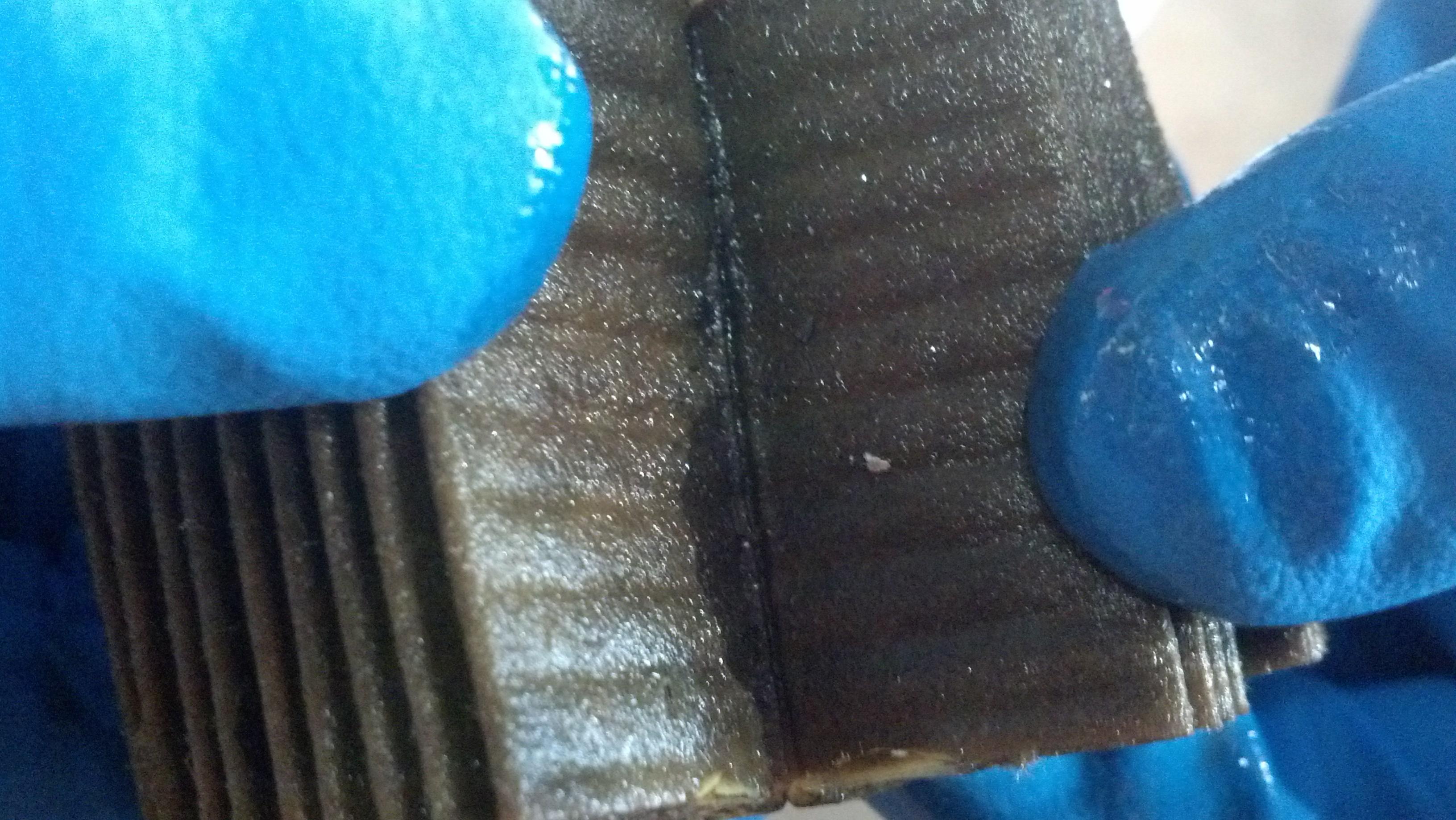

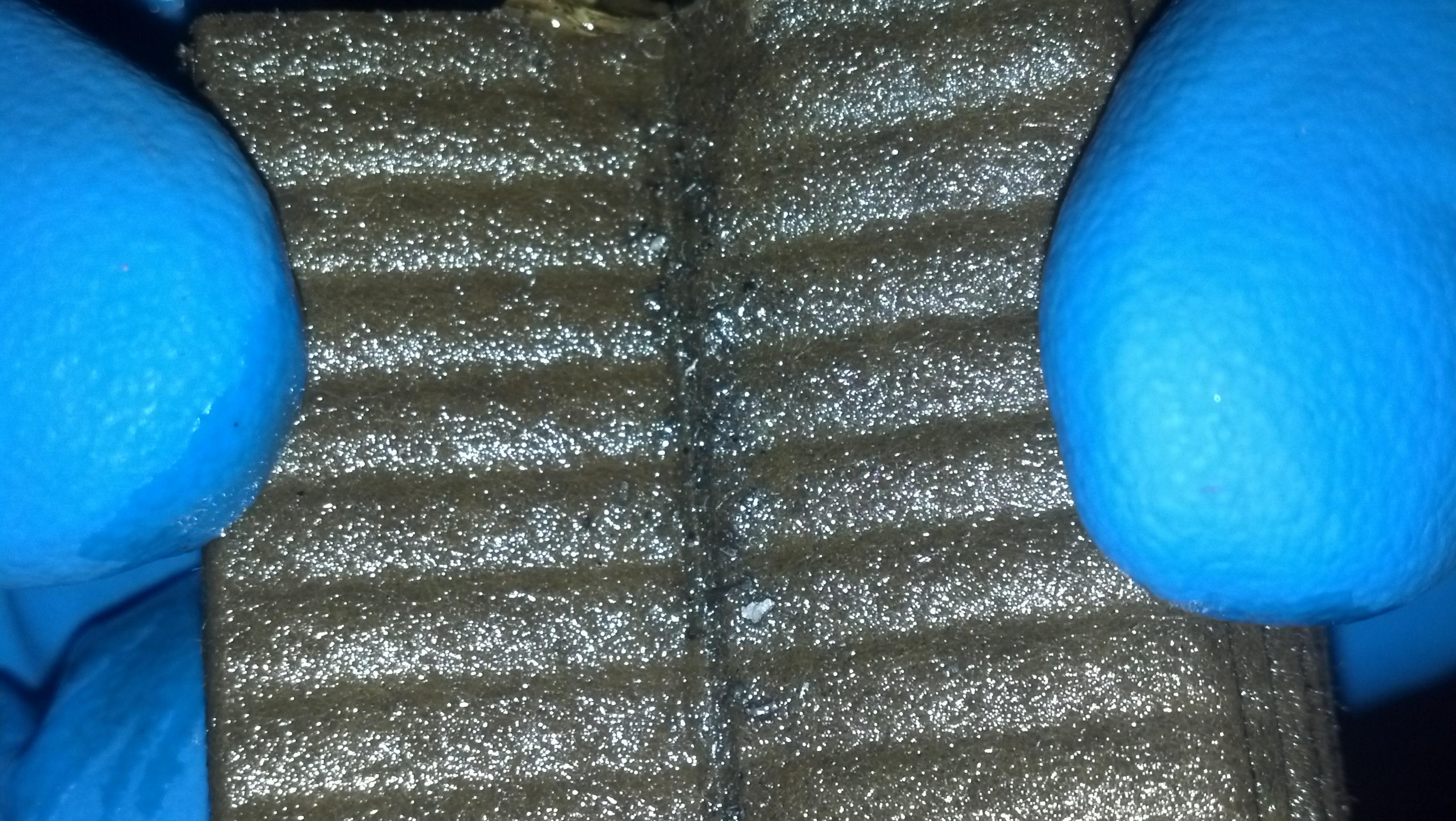

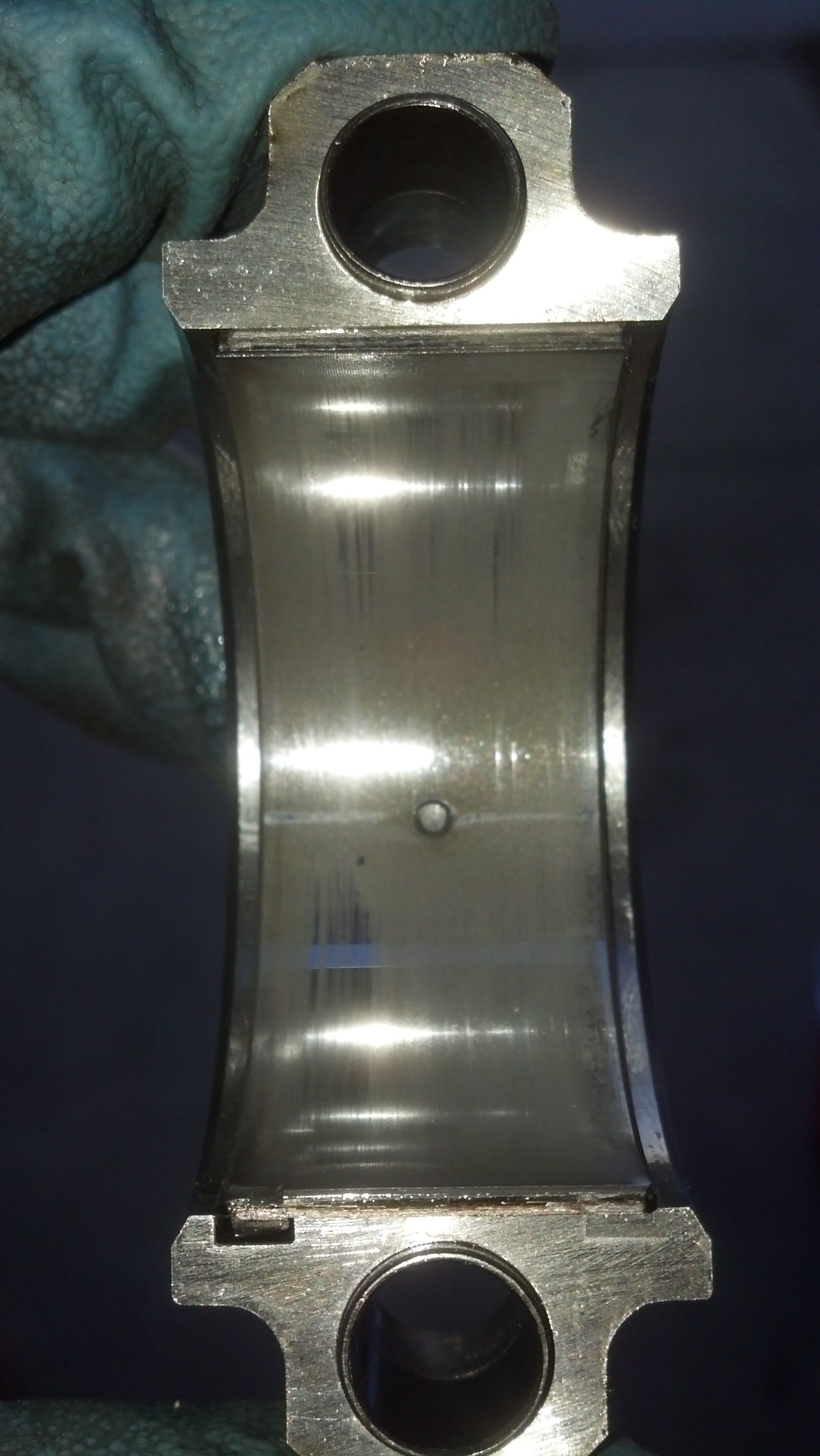

So I pulled the first main cap and the #1 rod bearing cap so they could look better and they could look worse. They feel smooth when you run your fingernail across them lightly. Realistically they are probably useable. I'm not 100 percent sure what I'm going to do with them yet. Anyways on to the pics. Feel free to share your opinions on what to do with the bearings.

I am no expert but that looks similar to ones I see online of people replacing...
Like I said, no expert and take it with a grain of salt. If you can't feel the scratches I am sure it will work but might be better off replacing I guess.

God, bearings are one of those things that are so hard to tell the condition by pictures. You almost have to see them to tell.

They look pretty nice I saw them I'd reuse them if it were mine
Yeah i agree. But these only have 600 miles on them. It sucks lol. I dunno It's kind of a crap shoot right now
Yeah i agree. I dunno lol.
I just tend to be overly paranoid.
Well onto some positives. The cylinder walls look just about perfect. the rod and main journals on the crank look perfect. So i dont know what to do with the bearings right now. My overly paranoid self wants to just replace them but I don't want to pull the engine and replacing them in the car looks like a biotch to do.

Rod bearings are easy and cheap enough to replace, and those look a little worse from pics compared to the mains. But as goodhart said, really hard to tell from pics. Maybe check all the mains and make sure they're good and just do the rod bearings?

That's a good idea. The rods are easy enough to replace

The other thing I never thought of did u take one of the upper rod bearings out? There usually the ones that take the worst beating the upper rod bearings and lower mains

From the pictures you posted, you are still on the first layer, for most of the bearing surface on all the bearings in the picture. It safe at this point to just reuse all the bearings.

I have not. I can check the next time I'm over there
I hope so. So far quite a few people have said they are useable. So I'm either going to replace the rods and use the mains or just reuse the rods and mains for this summer then pull the engine and replace all of them next winter.

I agree with simulated. It looks like the break in coating is worn off. Not sure what you're paranoid about. Especially if you can't feel anything with your nail.
Run a good, heavy oil if you're worried.

paranoid that the will cause a problem. I just over think things. Bearings will be reused. And it will be using to a good heavy oil.
