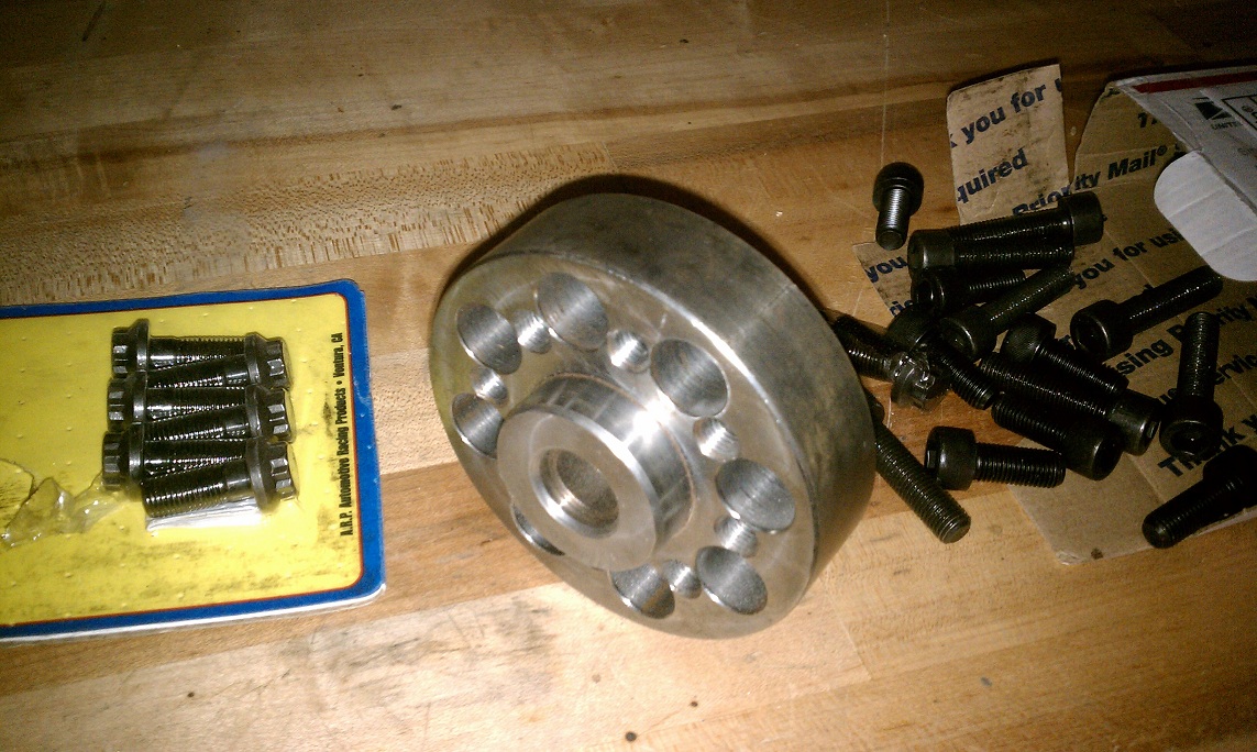

Flexplate adapter and hardware.

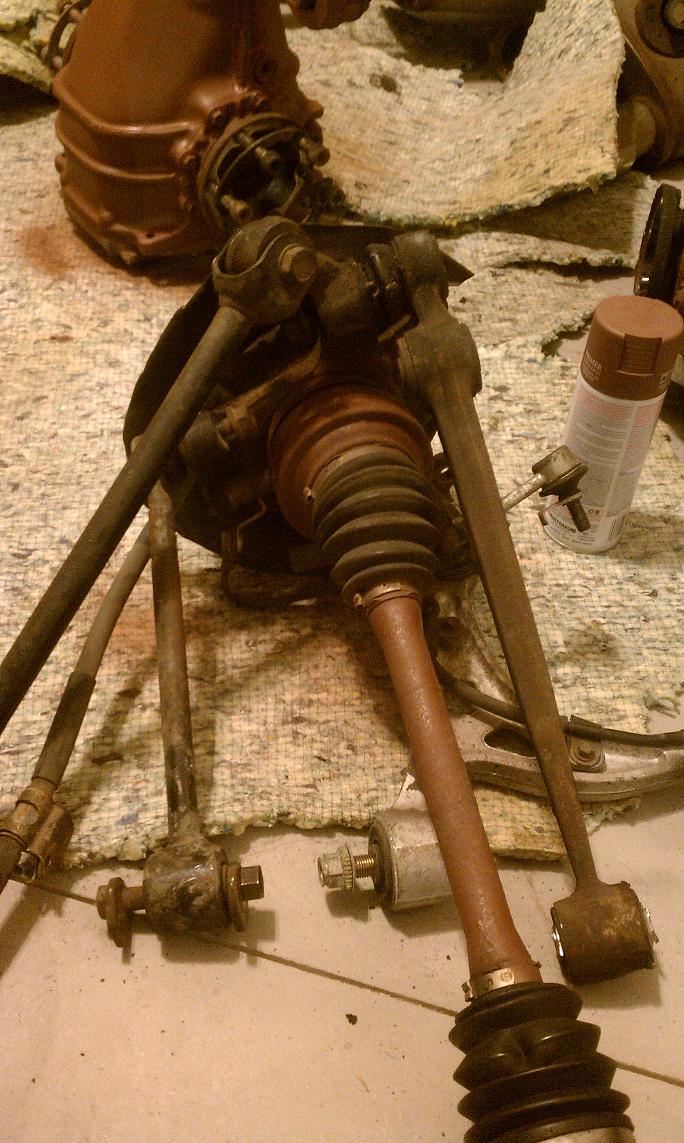

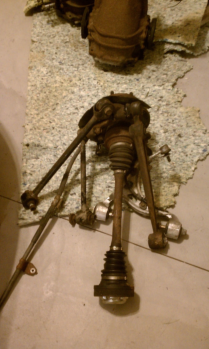

Rear Subframe is disassembled. Took about 2hrs longer than it needed to because one bolt was seized in one of the arms. Had to resort to the grinder.
I want to replace most of these fasteners. Not sure what other people do, but I'm guessing I'll have to just go to the dealer to get most of these? Where else would someone go for decent SS metric hardware, maybe Fastenal?
Subframe disassembled:
Rear Driver Side wheel hub mess:
Rear Pass Side wheel hub mess:

Name:	SFrame disassembled2.jpg
ID:	13056   Click image for larger version
Name:	Rear Pass Side.jpg
ID:	13057   Click image for larger version
Name:	Rear Drv Side.jpg

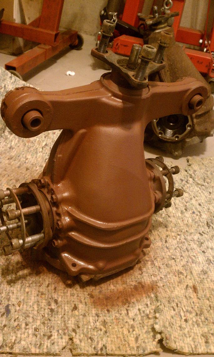

Small update.

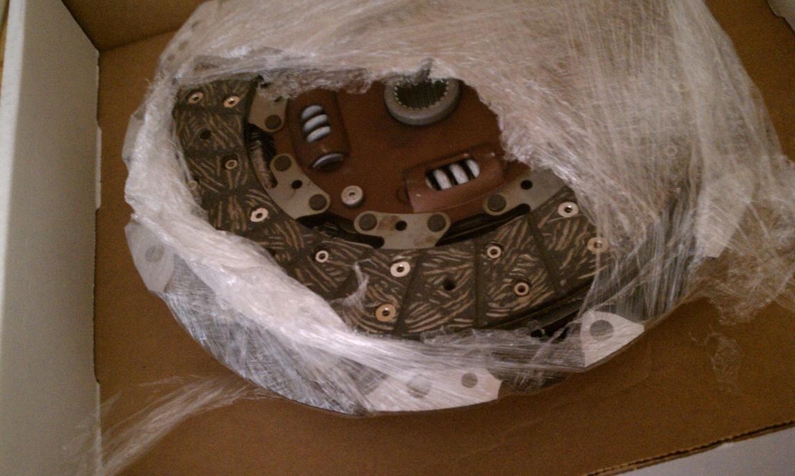

Ordered a JWT 350z clutch w/ metallic disc from Vinny Ten Racing. Showed up with an organic disc though, so they will be shipping me a new disc in a couple weeks.

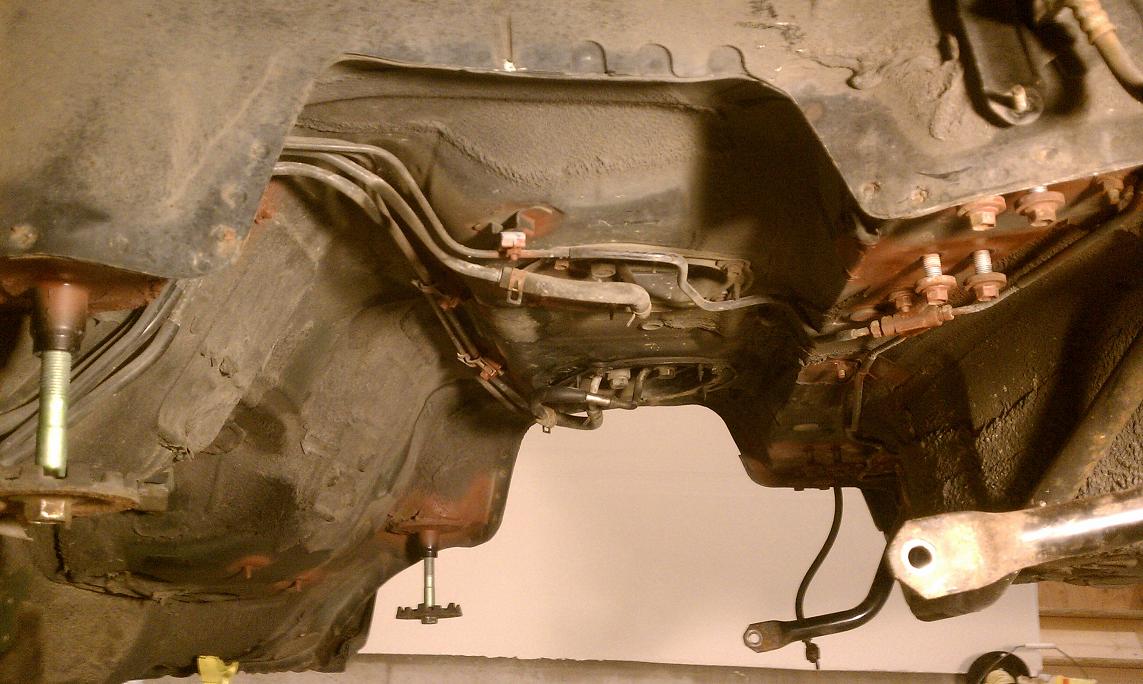

The rear subframe is completely disassembled with the exception of the pressed in bushings. I cleaned it up with soap and water out back.
Ordered all new TRD bushings for the rear subframe with the goal of stiffening it up a bit for performance reasons, yet still retaining some comfort (which is why I chose these TRD ones over poly/solid bushings). TRD are the same exact design as stock, just use a stiffer rubber. Had a hell of a time trying to find a shop that will press out the old and press in the new bushings. Nick (munchgsx) offered to try so hopefully we'll give that a try soon.
Once the old ones are out, prior to putting in the new ones I'll be sending the subframe to PowderKeg to blast and powdercoat so it's in better than new condition.
On the control arms, the ball joints are not servicable, so you have to spend stupid amounts of money to buy all new arms from the dealer. So instead, I asked John (Pushit) to see if he can figure out a way to get the old balljoints out, and modify the arms to accept some standard off-the-shelf ones. Will hopefully be able to get him an arm to try out here soon.

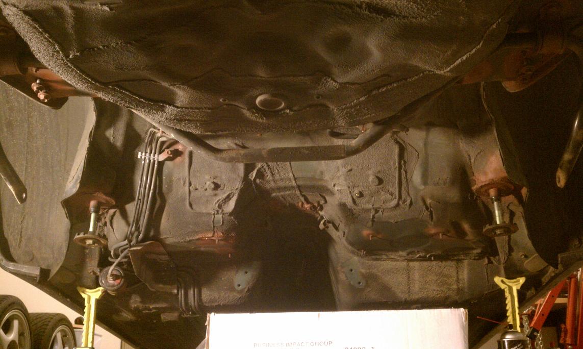

Also, started on the small amount of rust spots under the car. Basically just bought a sanding pad and sanded down the areas with rust. Then hit them with some Rustoleum rust inhibitor primer, and will follow it up with some Rustoleum black enamel. Hopefully that'll help reduce any rusting under there. But again was pretty happy with how little there was.
Also I sanded and primed the new rear diff. Giving it the same treatment with the rust inhibitor primer, then will give it a final coat of black enamel.
And same treatment to the axles, and the front face of the wheel hubs.
So the disassembly stage is coming to an end with the rear diff. Will be moving onto the reassembly portion soon which is exciting for me!
