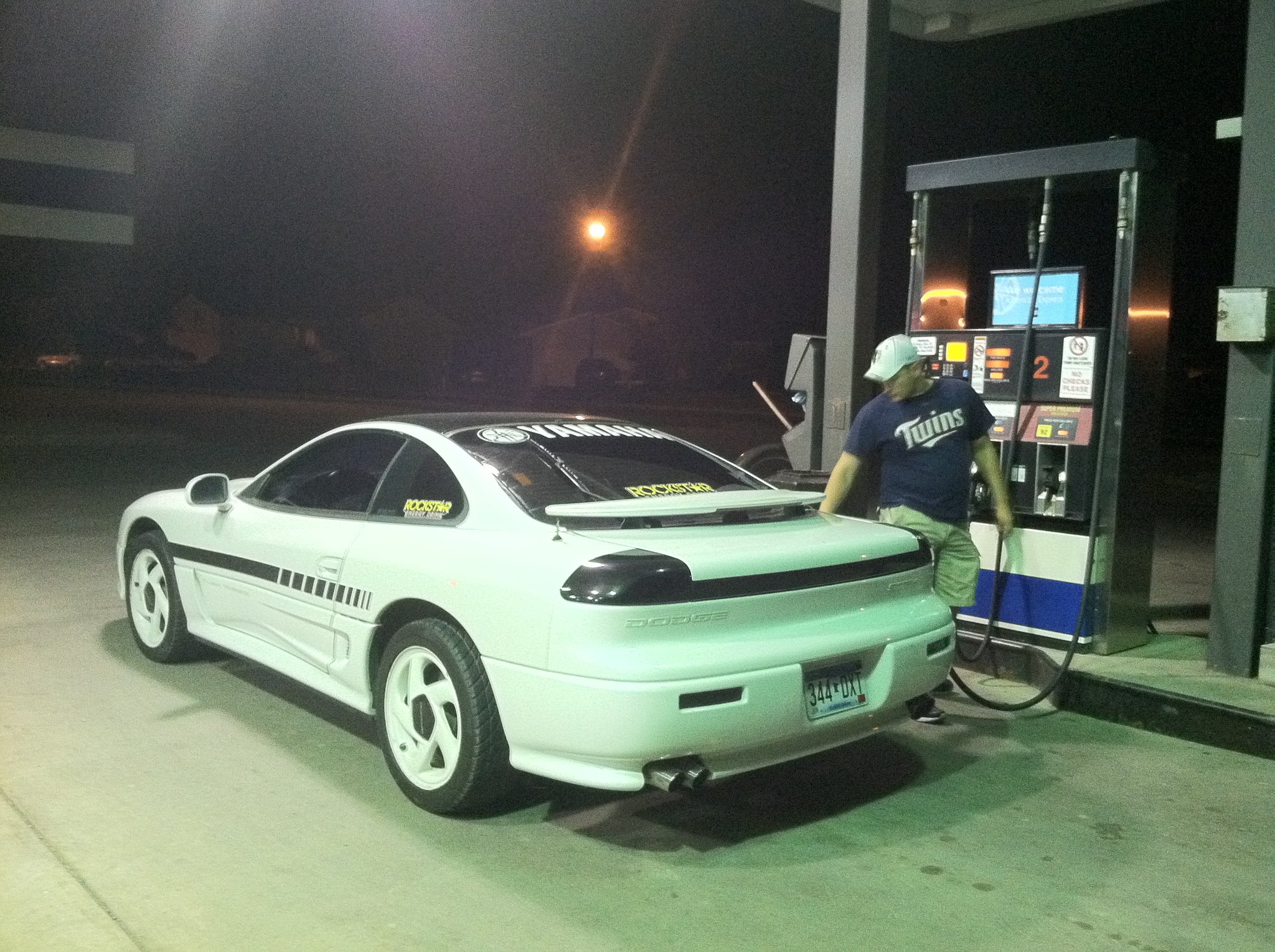

I had this 1/2 way completed last night, then went to bed and shut off my computer . First post updated
Most recent picture with decals pulled, legal rear tail lights, and working window regulators:
