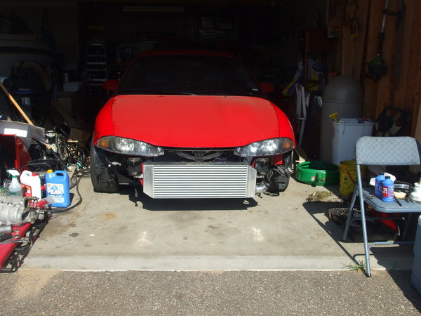

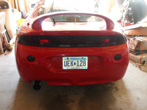

Couple of pics of the car now. The hood has about 1mm of dust on it thats why it looks like that. and the tail lights and reverse lights were done by Primo a while ago just got them on. they look darker in the garage but there only a cherry tint and not black.

also is a pic of the exhaust that I am stuck with at this time but will eventually swap out to my old one.
