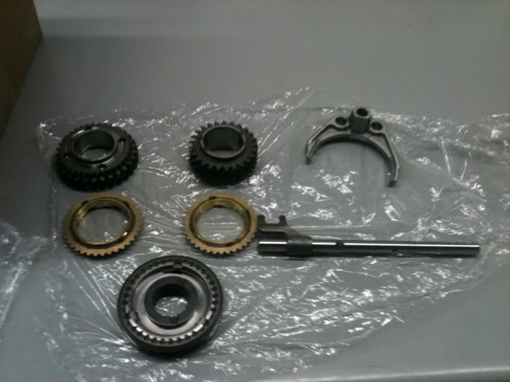

Well, finally have some updates. I just got my EVO III conversion from Jack's. I also received my AEM wideband a while back too.
Tomorrow I'm picking up my SMIM and FPR. I'll also be selling a few parts to fund the rest of the stuff I need (Which always seems to get longer the more I think about it.). More pictures coming tomorrow!

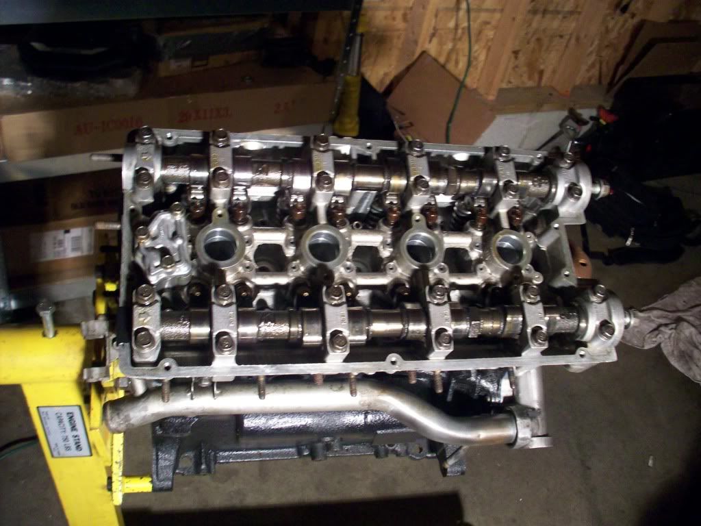

Here are some pictures as promised.
Start
Head off
And that's how she sits right now until my VS compressor comes.
