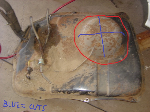

i have been searching for hours for a picture of what our 1g gas tanks look like removed before i cut in to that hump good thing i did .... Click image for larger version

one way i was thinking on how to do it is cut it in a x pattern and folding it down and welding it. would it work ? anyone cut in to these is the metal thick or light ..?

Well unless your the worst welder in the world, yes the metal is plenty thick to cut/fold/weld. But what you should do is cut the hump out and get a fuel cell to put under there instead, thats what I did.

well way back in my uber noob days i too hated that hump. so i bought a large hammer and i proceded to make it flat. now ive never had any problems but DONT DO WHAT I DID. i belive under that hump there is a gas vent/tube on top of the gas tank and the tank itself might come up a bit into the hump. i just got lucky that i havnt had any major problems with my dumb move

2G's are easy, the gas tank is under the rear seat and there's a ton of room in the back. For the 1G, the easiest way is to cut out the hump in the tank completely, and weld a flat patch panel to it. You have to do the same for the trunk floor anyways. Remember to fill your tank with water before you start cutting it though, your eyebrows and arm hair will thank you.
