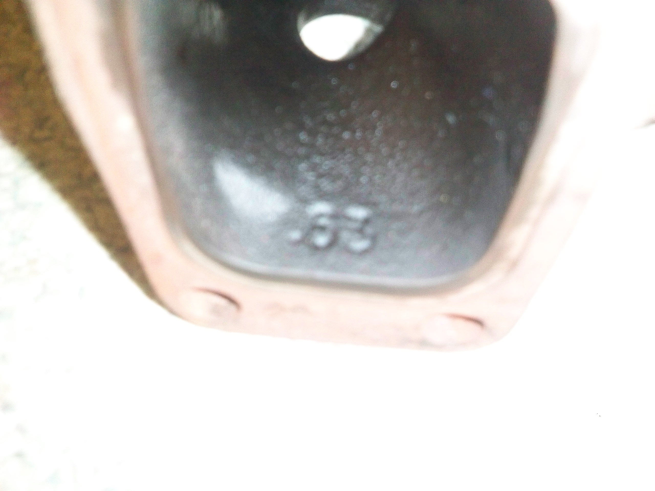

but its for sure a T3/T04E turbonetics Compressor Housing - 60-1 Compressor Wheel - F1-62 Turbine Wheel - Standard Housing - .63 A/R fully clockable the whole thing comes apart easy 5 bolts to take off on exhaust side from the center section and 4 for the compressor side off the center section and another 6 on the compressor side around it

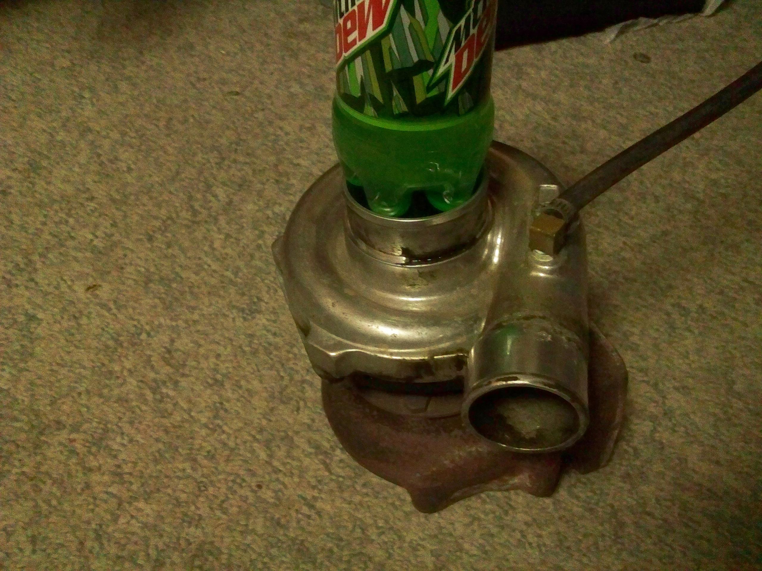

here are the pictures of the turbo i got
